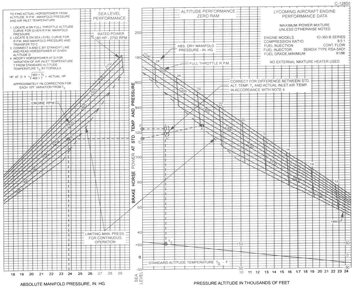

Matt,
I don't have an IO390 but the manual for my IO360B shows that combination as outside of the suggested area of continuous operation - yes it was a quick look and I didn't purely run the numbers.
I would guess that combination might be detonation-prone.
YMMV - see if you can get the appropriate chart for the IO390. They are a bugger to figure out too - but there are some guidelines.
Ralph

PostPosted: Thu Mar 31, 2011 11:00 am    Post subject: Low RPM/High MP vs. High RPM/Low MP... Reply with quote
Ralph,
I looked at your attached chart and didn't see any warning about
operation limits. These type charts are just used to predict what
various RPM/MP/Altitude combinations will result in a given airspeed. As
long as he stays in his engine/prop allowed range it's fine. Those
numbers can be found on the props TC certificate or by a call to the
props manufacturer. Low RPM, high MP has been used for years, every
turbo-charged engine does it.
Bruce

PostPosted: Thu Mar 31, 2011 11:52 am    Post subject: Low RPM/High MP vs. High RPM/Low MP... Reply with quote
There's a place just to the left of the dividing line towards the bottom that says "LIMITING MAN. PRESS FOR CONTINUOUS OPERATION". It points to both the left and right portions of the chart.
That is what I was referring to - and that is what I try to go by. I would think it is even more critical if you're turbocharged.
Or am I really misinterpreting the charts.....maybe Bart (Lalonde) or Rhonda (Barrett) or Mahlon (Russell) will chime in here and keep us honest.
I'll take an education....

PostPosted: Thu Mar 31, 2011 4:26 pm    Post subject: Low RPM/High MP vs. High RPM/Low MP... Reply with quote
On Thu, 2011-03-31 at 09:21 -0700, Matt Dralle wrote:
a combination of 2150 RPM and 25-26 MP
The Lycoming engine plots say to me that operation at full power, full throttle, full rich (but with zero RAM air boosting) down to 2400 RPM is OK. But the limit line is clearly saying that if the RPM is set below 2400 RPM the maximum power has to be dialed back.
This is not unreasonable since the engines are rated at max RPM. Power is the product of RPM and Torque. To retain the same HP at reduced RPM requires increasing the Torque output - increasing the peak forces withing the engine. Both the max RPM and max Torque define the operating limits of the engine from a mechanical point of view. (You need to hit the cylinders harder to get the same HP at lower RPM)
The max RPM and the lines marked 'Limiting man pressure for continuous operation.' is how these limits are conveyed to the operator. What the limiting factor for the torque is really not generally known - perhaps detonation is a factor - peak cylinder pressures or perhaps it is something else. Talk to the design authority for this engine - if you can find one.
For the few Lycoming engines I have looked at the max power is limited to somewhere between 65 and70% at 2150 RPM.
My question is for the propeller manufacturers, when they test for suitability on the respective engines do they take this secondary limitation into consideration? If you are operating your engine outside this range you may also be operating the propeller outside its tested and approved range as well. (Bigger hitting cylinders will augment their tendency to resonance.)

PostPosted: Thu Mar 31, 2011 7:59 pm    Post subject: Low RPM/High MP vs. High RPM/Low MP... Reply with quote
Hum, interesting. In that graph, albeit for the IO-360, the "Limiting MP For Continuous Ops" at 26 MP is 2100 RPM. 27 MP is 2200. Assuming the IO-390 is similar, 2150 at 26.5 ought to be good to go. BTW, I flew tonight and at 26/2150 I was seeing about 10.2-10.5 GPH (at) 2500ft. Better than I recalled.
Where can I get a sweet chart like that for my IO-390? I looked quickly though the manuals that came with the engine, and I didn't see one.
Thanks for the feedback everyone!
