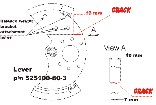

Trawling the website of Yak UK reveals this to be a well known gotcha.
http://www.yakuk.com/2000-004.doc
MPD: 2000-004
Subject: Crack in elevator control system pulley.
Applicability: Yakovlev/ Aerostar or a SA Y B AK 52 aircraft.
Reason: A 19 mm crack has been discovered in the elevator actuation part number 5251 or 00-80-3 (referred to as “lever” in the Romanian parts catalogue). The failure of this component could result in loss of the elevator control.
Compliance: Within 50 hours from the effective date of this MPD, inspect elevator actuation pulley parts number 525100-80-34 cracking on its periphery below the attachment for the balance weight bracket, at the point where the section reduces from a 10 mm to 7 mm. Inspect using dye penetrant techniques. if the component is cracked, replace it before Further Flight. Repeat this inspection annually at renewal of the permit to fly.

PostPosted: Sat Mar 26, 2011 3:03 pm    Post subject: Yak-52 elevator failure Reply with quote
Interesting!
How much weight is attached to this part? And for what purpose?
Walt

PostPosted: Sat Mar 26, 2011 3:27 pm    Post subject: Yak-52 elevator failure Reply with quote
Well, the part is cracking on the upper side ... would it be due to aggressive pull back forces on the stick?
wlannon(at)persona.ca
PostPosted: Sat Mar 26, 2011 7:20 pm    Post subject: Yak-52 elevator failure Reply with quote
Possibly. The crack is originating at the section change where loads would
tend to concentrate but it may also be subject to bending loads from the
balance weight attached to the upper, heavier, section.
Possibly rudder induced transverse loading?
I don't understand the use of a balance weight in this location.
Walt
PostPosted: Sun Mar 27, 2011 2:14 pm    Post subject: Yak-52 elevator failure Reply with quote
Hi Cliff;
Thanks for your reply. There seems to be a bit of confusion re this part.
It is not a control balance arm which would typically extend well forward of the control surface hinge line.
This is the elevator control cable drive sector (bellcrank).
It appears to have weight mounted on it directly above the hinge centre line.
That would have absolutely zero effect on elevator balance if the weight is mounted where the attachment holes are located.
But, I am beginning to get the picture!!!!!!! Is this the mounting location for the balance ARM?
If so that takes my concern to a whole new level. That would be the absolutely dumbest place you could possibly imagine to attach a balance arm.
Not only does the sector have to handle the balance weight the effect is severely magnified by the length of the arm.
The cause of this cracking I believe is a direct result of that installation.
Any asymmetrical rudder loads will induce horizontal loading of the ELEVATOR balance weight which will in turn
induce a twisting moment in the elevator sector.
Over (who knows how) many cycles this will result in a fatigue failure at the most likely focal point. Barring a severe nick or other mechanical damage that point is the section change.
Now I begin to understand why they are suggesting a STEEL replacement.
Walt

PostPosted: Sun Mar 27, 2011 5:46 pm    Post subject: Yak-52 elevator failure Reply with quote
Hi Walt ,
That is a very incisive analysis of why this part might fail . I think you may have
shed some light on this problem .
Terry

PostPosted: Sun Mar 27, 2011 6:50 pm    Post subject: Yak-52 elevator failure Reply with quote
Hi Walt,
Yes, the 4 mounting holes are for the mounting arm as you suggest which
extends forward and has a significant weight on the end. I will take
some photos of the counterweight arm as mounted on the bellcrank
tomorrow and post them on the list.
Dennis

PostPosted: Mon Mar 28, 2011 8:23 am    Post subject: Yak-52 elevator failure Reply with quote
Cliff, what you are saying here makes perfect sense. Thanks for writing it.
Inspecting the part makes sense, but in my mind it is MUCH more important to determine why it cracked in the first place.
Mark Bitterlich

PostPosted: Mon Mar 28, 2011 9:36 am    Post subject: Yak-52 elevator failure Reply with quote
Since the cause of the crack in the bellcrank has not been determined
(or published), as Cliff points out, it is also very important to make
certain your airplane is configured/rigged properly. ie: Elevator
travel is set to specs; rudder travel is set to specs; aileron travel is
set to specs; cable tensions are set to specs and the elevator counter
weight bolts and nuts are 100% tight.
Last but not least as Cliff points out, the elevator bellcrank bearing
CAN and WILL wear. It is a 6x19x6 mm self aligning bearing and they are
used in several places on the airplane. The ones used on the control
surfaces are open face bearings (not sealed) and are prone to collecting
dirt and grit which causes premature wear of the bearing. The elevator
bellcrank bearing is one of these bearings that can easily be degraded
because of dirt and grit migrating to the inside of the bearing.

PostPosted: Mon Mar 28, 2011 1:52 pm    Post subject: Yak-52 elevator failure Reply with quote
Hi Cliff;
The self-aligning bearing is there to compensate for any minor mis-alignment in the assembly of the sector to the rear spar attach fitting with the left & right elevators attached
to the sector.
It will have no effect whatever on the any twisting/bending moments induced in the upper (thicker) part of the sector. Those loads are transmitted to the thinner (7mm) section which is firmly bolted to both elevators through the attachment plates.
These plates are substantial and very effectively increase the bending resistance of the sector in the area just below the section change. This of course further defines the focal point for cracking at the section change by eliminating any flexure below that point.
For the universal bearing to have any effect the entire elevator assembly would have to translate laterally.
Sorry. I think it is a very poor design and probably dictated by a lack of space in that area.
The CJ is quite different. The balance arm is attached to the primary structure of the elevator assy.
I would expect the CJ system is a direct copy of the earlier Russian systems.
Jump in Doug -- how is the Yak 18 done?
Anyone know the Yak 50, Yak18A systems?
Cheers;
Walt

Yak 50 bellcrank and counterweight is the same design as the 52.
Dennis

Walt,The elevator on the 18 attaches just like the CJ6.  Don't know about the 50, and have never seen a 52 elevator, so I'm afraid I can't be of much help here.
Doug
