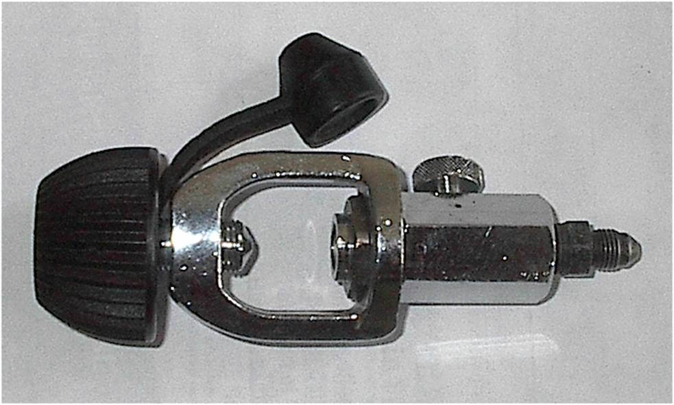

thomasg(at)infosysnetwork
PostPosted: Wed Apr 06, 2011 7:22 am    Post subject: Looking to create a scuba to schrader hose Reply with quote
Doc,
Do I really need the stage 1 of the regulator or just a connection to the scuba yoke? I would think that I would be using the high pressure off the stage 1, for the low pressure is only about 130 psi. So if I'm using the high pressure port, then I should be able to remove the stage 1 and connect the hose directly to the tank.
While I was typing this, I just got an email from Precision Avionics. They have this for $50. Looks like I can attach a hose to the end and then to a Schrader gooseneck. Thoughts?
PostPosted: Wed Apr 06, 2011 9:11 am    Post subject: Looking to create a scuba to schrader hose Reply with quote
Looking at it, you are correct, there is no valve core.
thanks
