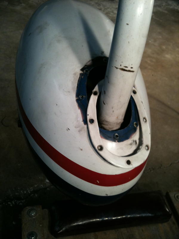

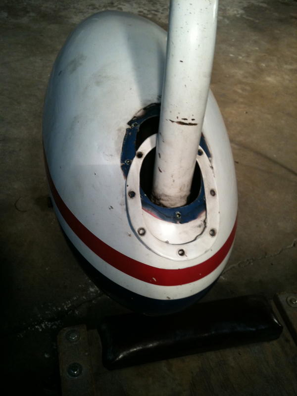

what's wrong with this picture?

The plane has been busting VNE and pushed the fairing back, or the holes in the fairing bracket cracked out and SOMEBODY relocated them, or the brackets were installed wrong in the first place, and the retainer rings is not secured, and the seal is messing and greasey finger prints. Definately work not consistant with a conservative republican.

I cannot understand the logic in relocating the screw holes. And then fabricating a top seal retainer that looks so bad.

There is nothing wrong with that... They just moved the hole too far back.  And yes, I agree, the photographer is drunk.  Every body knows the nose strut goes straight up & down.
Barry
GEE.... I wonder if the hole in the nose fork is round?
