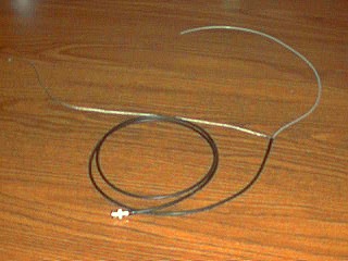

The picture is of one I made for the MKIII back in the 90's. Made a new one just like it because this one got rusty. Still works OK though. Directions to make it here:
http://www.bcchapel.org/pages/0003/pg9.htm

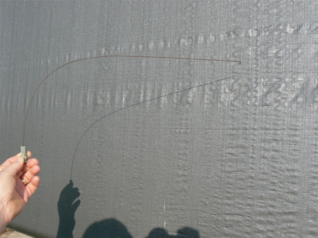

I've got an icom A5 and would like to get an external antenna that I can mount on the belly of my Mark3. Anyone out have any good recommendations?
[img]cid:9CAAB524A6684792B3D7A933AF8C6110(at)laptop1[/img]
my dipole center is at the left side bottom of the nose cone, the center wire goes up the left side and accross the top. and the braided wire angels back on about a 45 deg under the floor. the position was selected to give the best swr, and both wires were cut to give the best swr's. way cheep, way easy, and nothing sticking outside to get bumped or bent. one watt radio will talk 150 miles plane to plane. the signal report was good signal but with some background noise. last week i had a hard time talking to another plane (super cub) in the area,,, but one of the fbo's who was further away heard me ok and relayed to the super cub. made me think the radio setup in the cub was not up to par. he could hear the fbo but the fbo is putting out 15 watts.
boyd young
