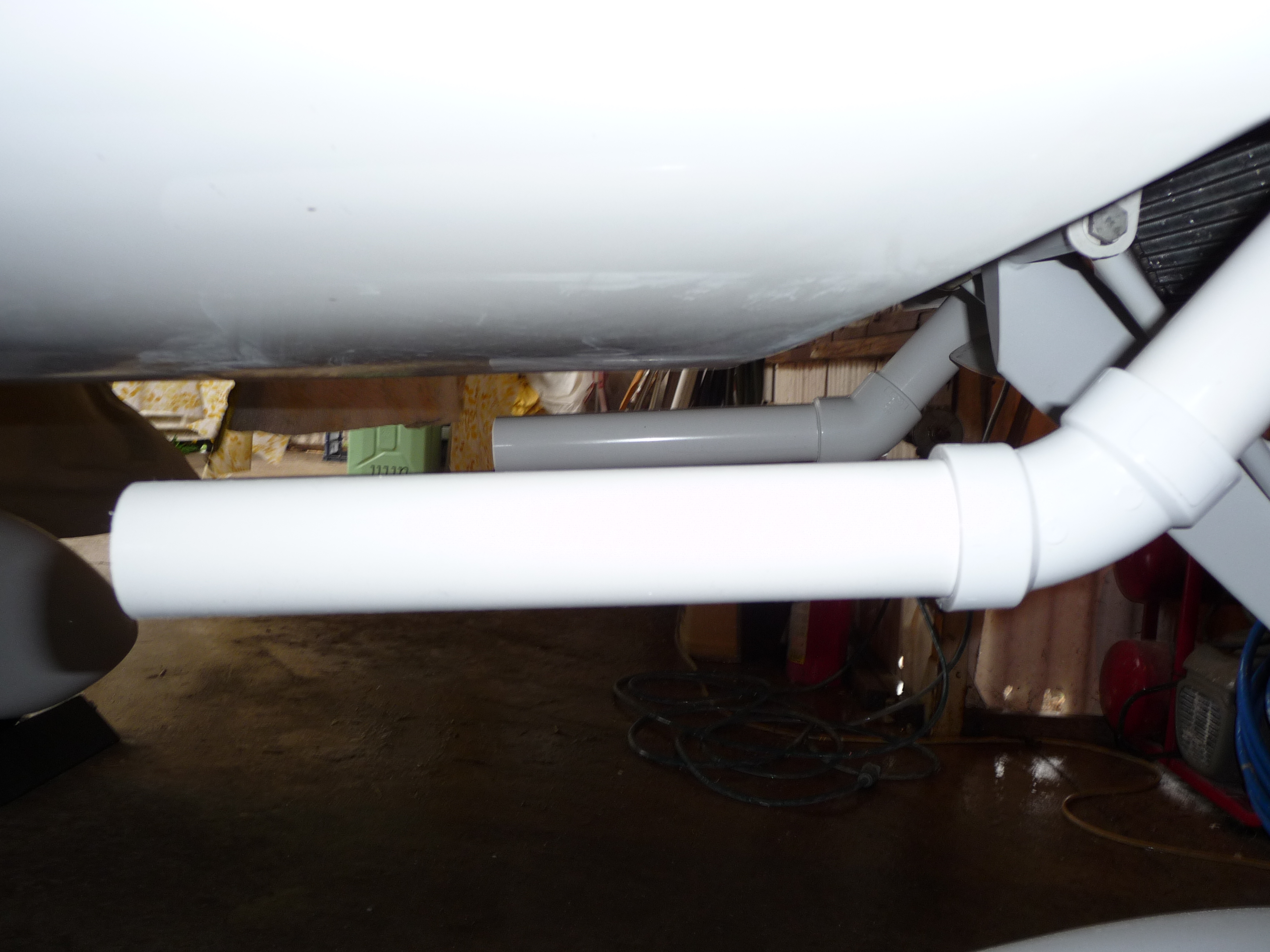

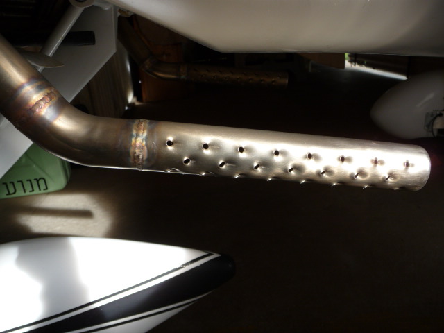

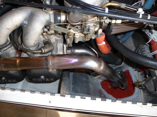

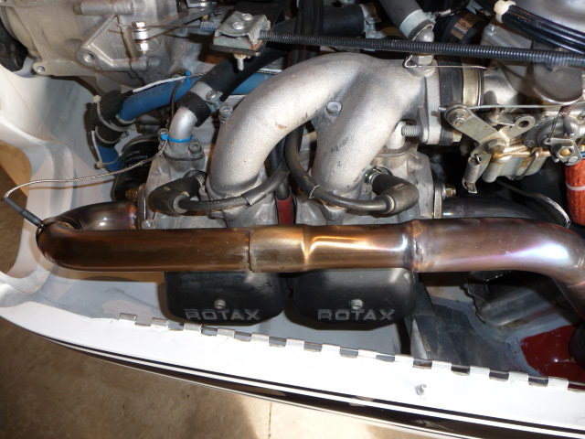

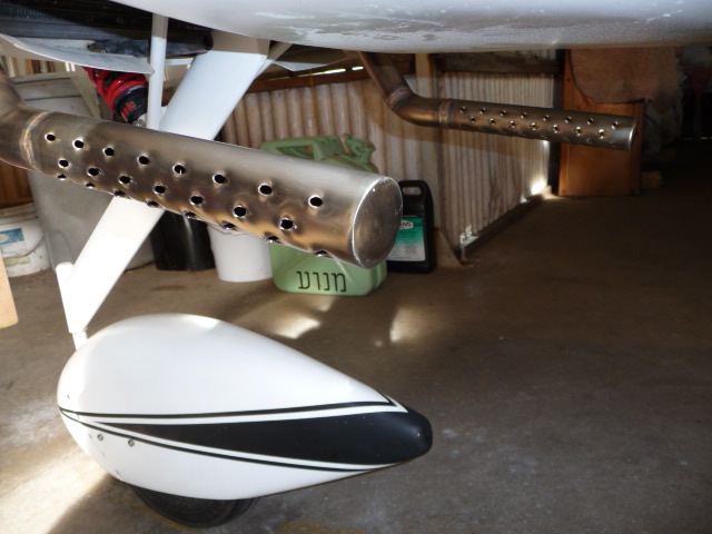

Note the absence of exhaust cans in engine compartment allows more access and eliminates major heat sources. The Ducati Voltage Regulator probably operates in cooler environment as well.
