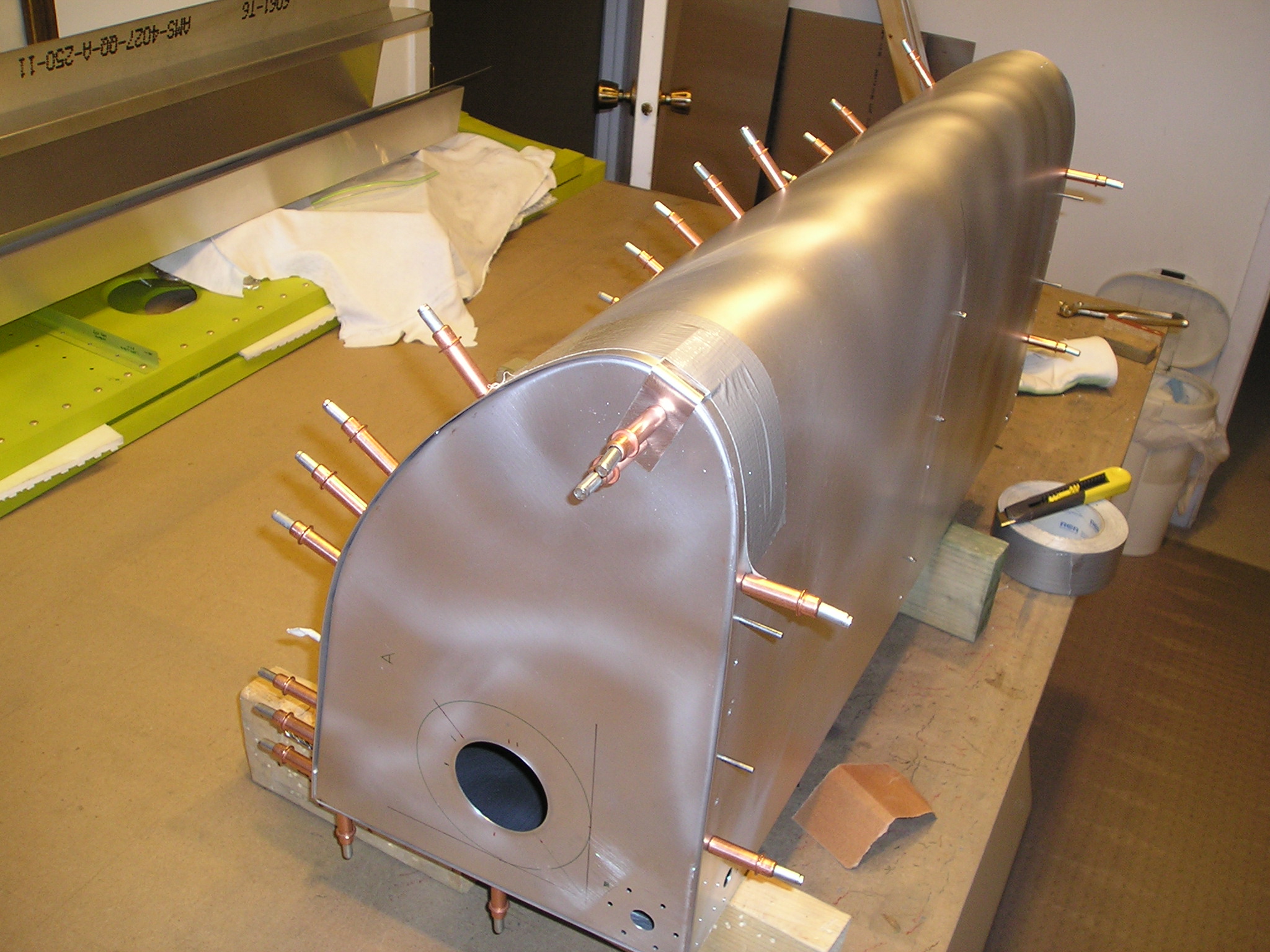

I have noticed that parts tend to shift a little relative to the original position (i.e., when the wholes were drilled) during riveting.
So now I have the habit of first placing the tail end of drill bits in a few holes (for instance, when riveting the wing skin, 5 to 10 drill bits on each rib), and then install the clecoes.
See attached picture of one fuel tank: in the centre of the picture, you can see two drill bits sticking out. On the top of the tank, left hand side of the picture, another drill bit (this one has the cutting end wrapped in masking tap). This ensured a precise, tight fit of all components.
I suggest that, if you are afraid parts may shift during riveting, you use the same principle - and, in addition, put the bolts in place.
