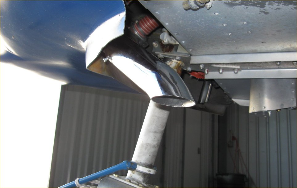

Those are interesting observations of soot on your firewall. I guess I have not seen that in my airplane, but here are a few observations I had on CO and an effort to reduce it in my Jabiru installation. I have access to a calibrated 3M model 740 multi-gas detector and placed it in the passenger seat beside me.
My stock Jabiru FWF kit exhaust pipe extends past the lower cowl lip by only a couple of inches. Flying in this configuration showed cockpit CO levels up to 170 ppm in full power climb and 50 ppm in cruise. As a comparison, OSHA allows up to 35 ppm exposure in a time weighted average for an employee on an 8 hour shift and says no employees should be exposed to more than 200 ppm ever. Needless to say, this was a little alarming to me.
I went to AutoZone and bought an exhaust extension pipe for around $9 bucks. The two screws that hold this on seem pretty cheap, but this has held rock-solid for over a year and 50+ flight hours so far. I flew with this extension installed and got CO levels of 32 ppm in full power climb and 0-5 ppm in cruise. When I opened up the cabin heat, the level went up to 9 ppm and then came back down when I closed it. 9 ppm of CO can be measured on a busy street corner in just about any city. With these levels of measured CO, I have not done anything further.
I am not sure what version of Jabiru exhaust you have, but if it does not extend much past the lower part of the cowl and fuselage, I whole heartedly recommend an extension.
Good Luck,
