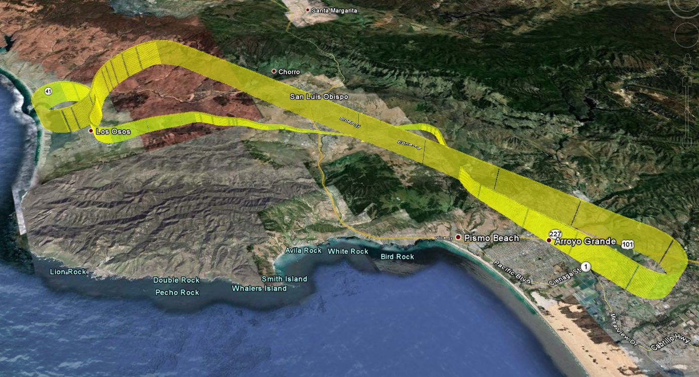

            Some time ago I mentioned to the RV List a free website called www.CirrusReports.com I record my flight data for every flight on the top MFD SD Card slot. About once every 4-6 flights I swap out the SD card for the backup SD card I carry in my flight bag camera case. Take the SD card to any computer, delete any small files that represent engine starts but not flights (they are obvious due to file size) and then upload the flight data to CR.com. The upload process is fast & easy. I uploaded 6 flights yesterday and it took probably 2 minutes. From there CR.com presents every single engine & flight parameter you can imagine including Geo-referenced map, and charts of every engine item with the option to display any 4 individual items at once so you can see for example Fuel Flow vs. CHT's. Speed vs. RPM. The combinations are enlightening. It also has a spread sheet function to give you Departure/Arrival times, Hobbs time, Flight time etc... In many ways it can substitute for your Log Book as far as accurate flight dates, hours, notes. You can choose to make your flight data public or keep it private. I have decided to make mine available to the public. http://www.cirrusreports.com/flights/N110EE/ Because it has this data it also has a simple export to Google Earth in both 3D view & Cockpit View. Here is a screen capture of the 3D view for a local flight I took back in August. Again this took less than 1 minute to produce:

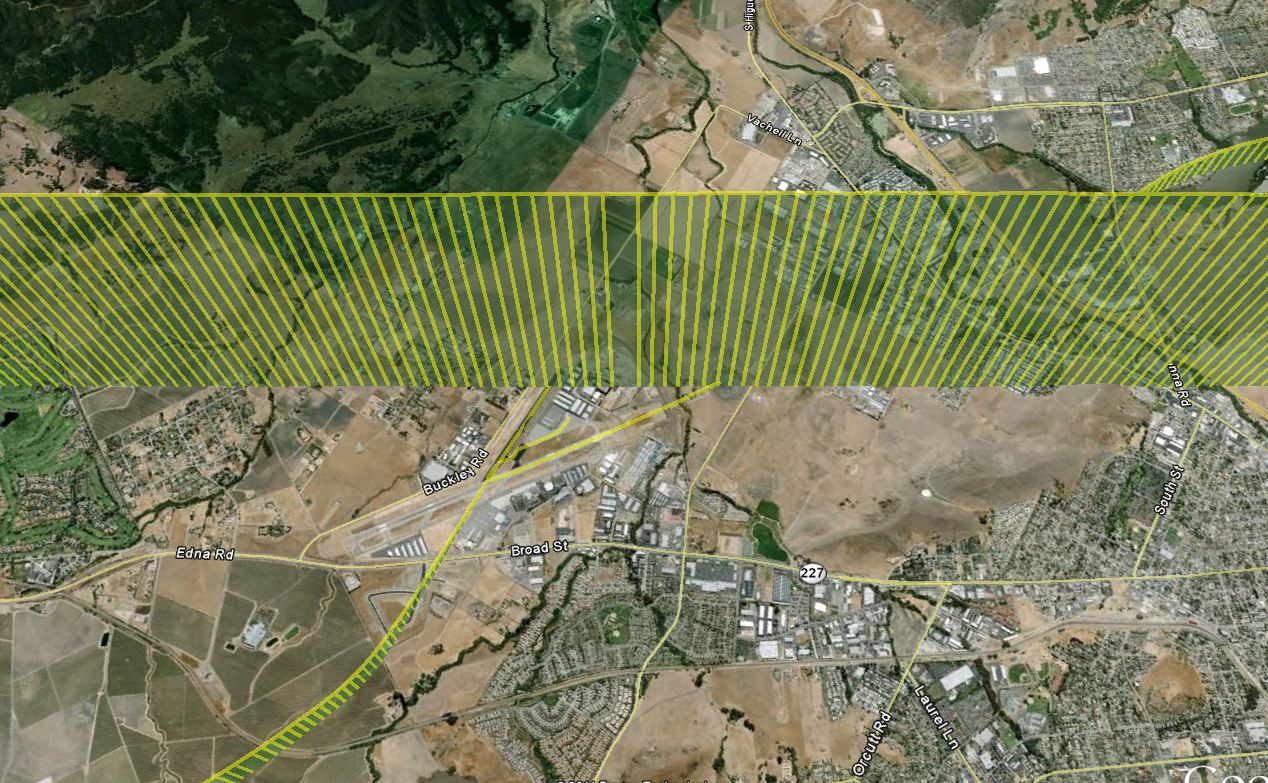

Here is a close up (from the other side of the airport) of my departure & arrival on different runways plus the over flight of the airport. It even shows I taxied back to Self Serve Fuel. Very powerful!
Nice feature!
