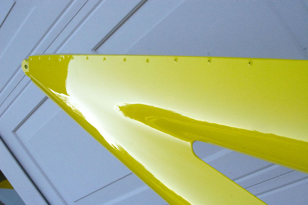

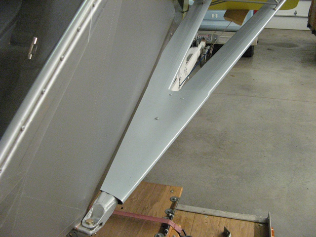

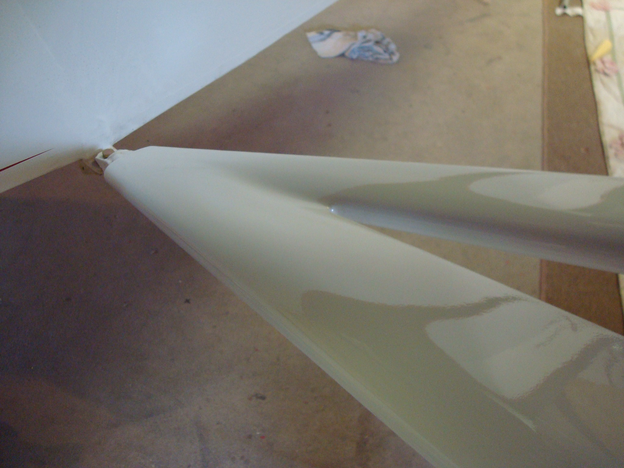

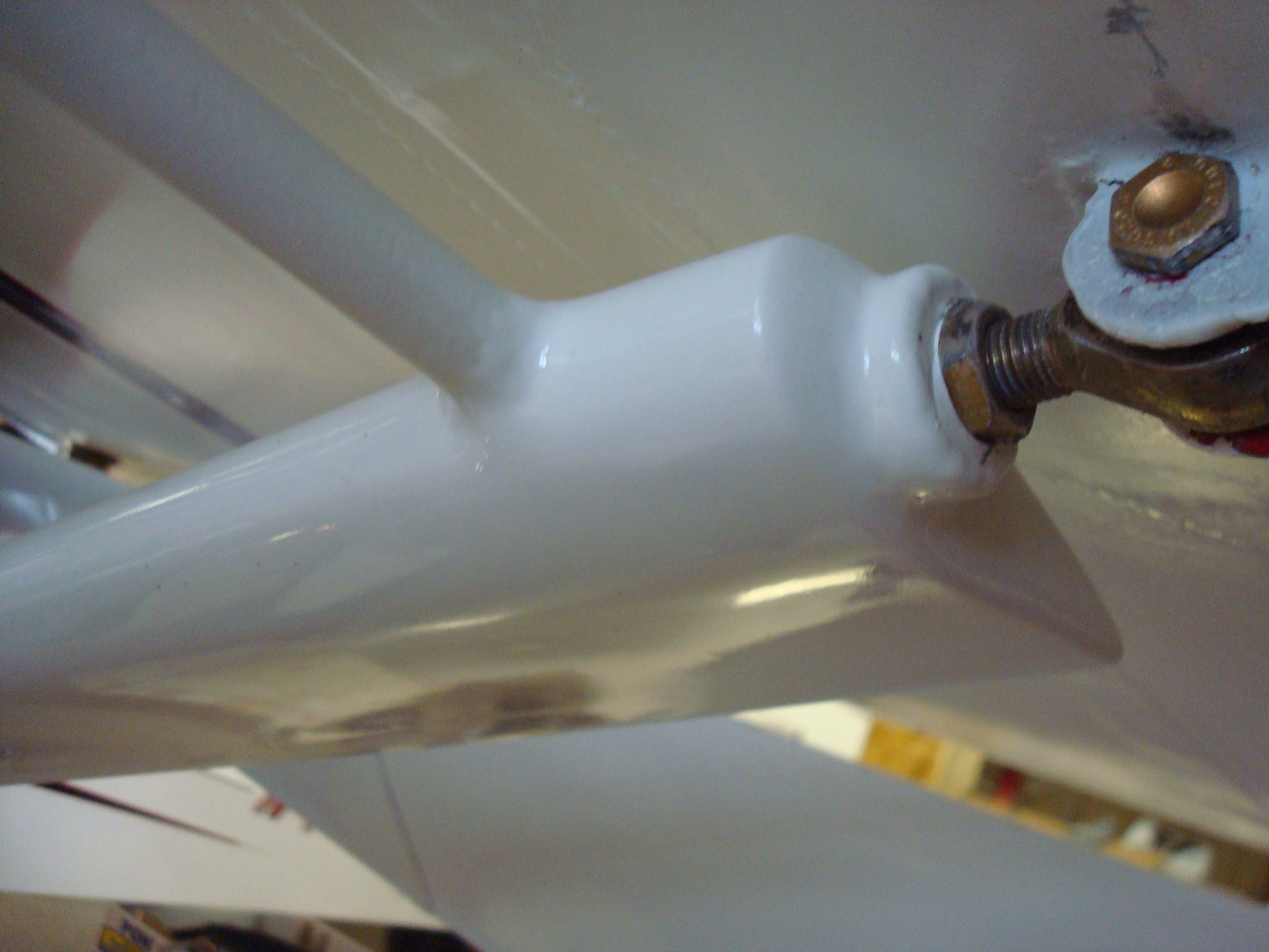

James,
I do not have any input for you on the pitot tube, however, this fall I
reworked the fairings on my 5. Here is what I did. They were finished by the
original builder using the aluminum wraps riveted together and sealed and
finished with Dacron fabric and PolyTone. I did not like that look so I
peeled the aluminum and fabric off and commenced to refinishing. I acquired
a short piece of fairing from one of the many helpful member of this list
and used it to extend the lower section of the fairings because the previous
builder just ran then long enough to reach under the aluminum wrap. I wanted
the fairings to have a smooth finish so I used a DA sander and a file board
to remove the extrusion lines that were in the fairings from mfg. I used
AeroPoxy with Flox to attach and fill all voids and seam the fairings
together. I used foam blocking as backers and fill under the Aeropoxy to
keep it light. I wet sanded to finish the plastic and shot it with a coat of
2 part epoxy primer so it would bite into the plastic, from there I used a
primer surfacer and final coat was white and clear coat automotive paint. It
is not the best way or the recommended way to do the fairings, it is just
how I chose to do mine. It all depends on how you want it to look and
function and the time and resources you have available to get it there.
Another slick job I have seen on the fairings is on the McBean's Radial
Kitfox, very nice. I attached a couple shot of my finished struts.

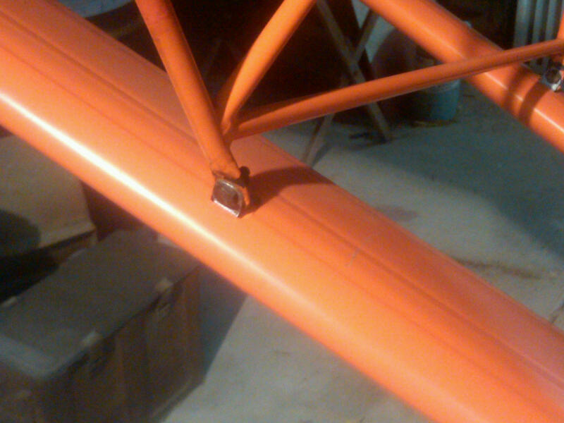

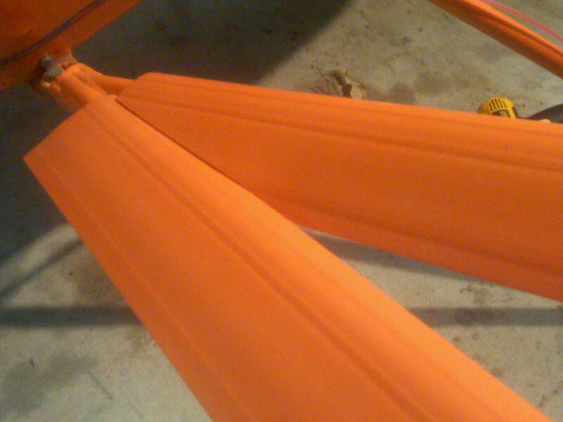

I didn't like the idea of the metal fairing either. So, I slowly sanded away on the front strut cover until it matched up with the leading edge on the aft one. I'll try to get a better picture later. It doesn't look nearly as good as Lloyd's, but it does look nice.
Also, I'd like to put in a plug for the Krylon Fusion PVC paint. I used it thinking that it would be a cheap temporary solution. However, it was extremely easy to use, and it has held up without a blemish to regular sod runway use. I was really lucky that their color was exactly the same color as the Aerothane on my plane, although the finish isn't as shiny on the PVC.
Anyway, you just wipe down the struts, spray them with the paint, and then wait a week for them to fully cure (the hardest part). What I really like about it is that I can remove the struts, and then snap them back on, and it doesn't affect the paint/covering.

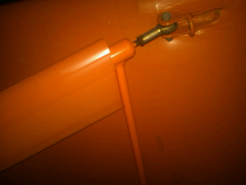

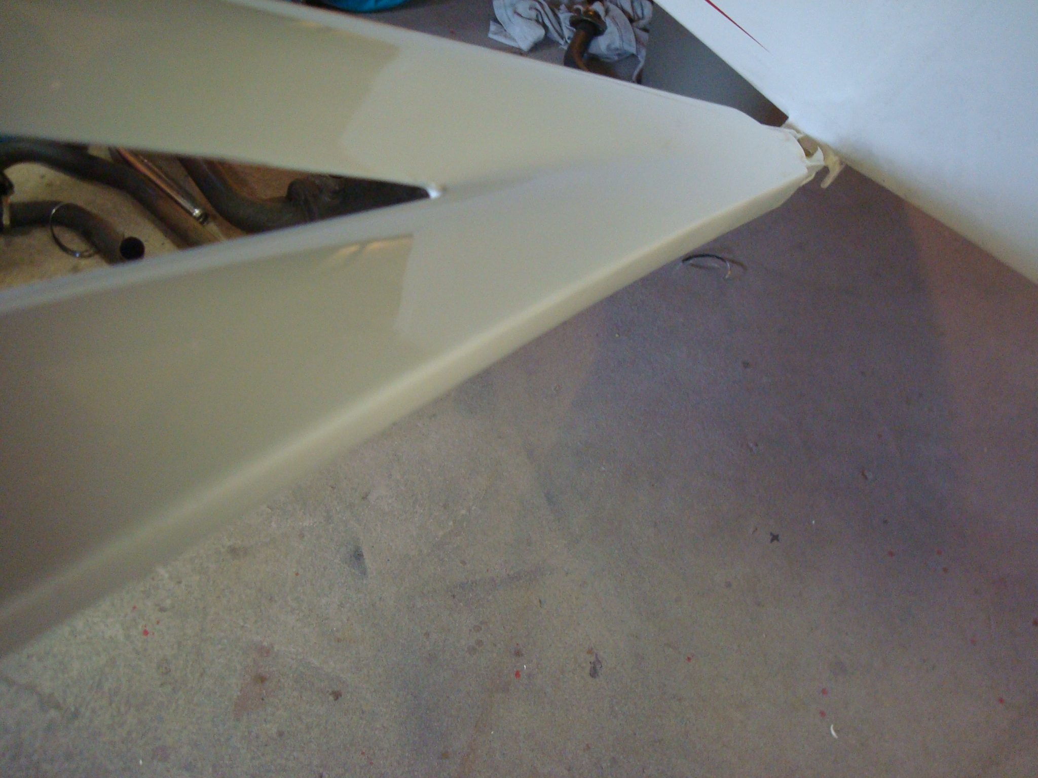

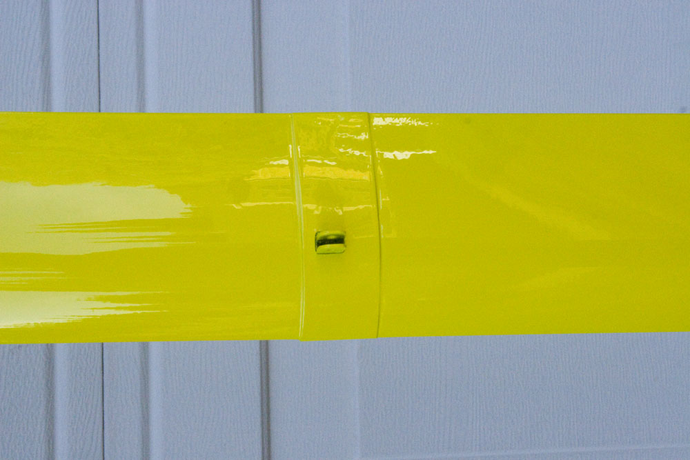

Here are the additional pics of the just cut, paint & install method. It isn't near as nice as Lloyd's and other installations, but it is cheap, easy, lightweight & removable. Another disadvantage is there are large gaps at each end (fairings are 96", struts are a little longer).

Ryan, just curious, but do you think you would ever actually remove the fairings? The work looks great. So for whatever dumb reason I actually threw one of the fairings on the scale and it weighed in at about 3 lbs so I am estimating about 15 lbs installed, does this sound about right? I have been hoping to put the KF on a little diet while I am doing all these mods, putting on as little weight as possible anyway. The good news is that the wing is off and the fuel tank install has started as well as the new pitot tube. The lift strut fairing has been shaped around the fuselage and now are ready for the actual mounting. Slow but sure progress will be made.

Ryan,
I see you are quite the craftsman. Those cuts are spot on. I don't know
how you did it.

I have been watching this. On my first Model IV, I did as suggested,
sanding off the extrusion lines prepping with micro and painting. I used
fabric at the V end as that what was the manual's way. This time, I had the
PVC, but weighed them and this time my goal is to be as light as possible so
went the aluminum way. They came out pretty good, though it was a ton of
work - mostly in figuring out how to do it. Finished they added 3.5 lbs to
the weight of the bare powder coated strut. To cover the V, I used two bid
fiberglass moldings and micro. We may be able to eventually offer these as
a kit.
Lowell

Don't forget you need to taper the rear fairing at the fuselage end to fold the wings.

PostPosted: Sun Mar 20, 2011 1:06 pm    Post subject: Wing strut Fairings and a new Pitot tube??? Reply with quote
Lowell,
You never cease to amaze me, they look great. Now if I am reading this
correctly, are you saying the entire fairing is made of aluminum and the "V"
end is from a fiberglass mold?
Lloyd
lcfitt(at)sbcglobal.net
PostPosted: Sun Mar 20, 2011 6:31 pm    Post subject: Wing strut Fairings and a new Pitot tube??? Reply with quote
Lloyd,
Not exactly as you describe. The fairings are aluminum - .014" thickness.
They are trimmed to come together in the V. Then a fiberglass shape about
2" wide and appropriately contoured (from a mold) is glued into the V with
Hysol and then faired in with micro. For those wondering about the very
thin aluminum, I poured two part Urethane foam into the structure for
rigidity and to hold the skins in position. I thought of putting the "No
Push" stickers on them, but after finishing, I don't think they are that
fragile. As I mentioned, I wanted the speed from the fairings, but didn't
want to add more weight than I had to. Incidentally, I planned on using the
two part Urethane under two BID fiberglass on my first project. I had
everything made up and was ready for the install when a neighbor at the
airport told me of some serious corrosion from the urethane foam on
something he had done. I definitely didn't want corrosion on the lift
struts so trashed everything and went with the PVC. I did a mock-up
though, using a piece of 4130 steel tubing. I masked it lengthwise and left
one third clean but bare. The other two thirds I sand blasted. Half of
that was painted with the epoxy chromate primer available then and the other
half remained sandblasted but unprotected. Then the whole thing was
assembled as planned using a section of fiberglass with the foam. I had
three stripes, natural metal, sandblasted metal and sandblasted and anti
corrosion primed. I cut of sections of the foam and fiberglass periodically
over two or three years and found no corrosion what-so-ever on any of the
surfaces, so this time, I believe it is a non issue. Maybe he used the foam
from a spray can - I don't know.
Another note. My equipment won't handle full length material so each length
of tube is covered by four aluminum sections. The sections are formed so
they pretty much snap together. Aluminum bands are positioned and Hysolled
over the joints as seen on the lift strut brackets - second picture.
Lowell
