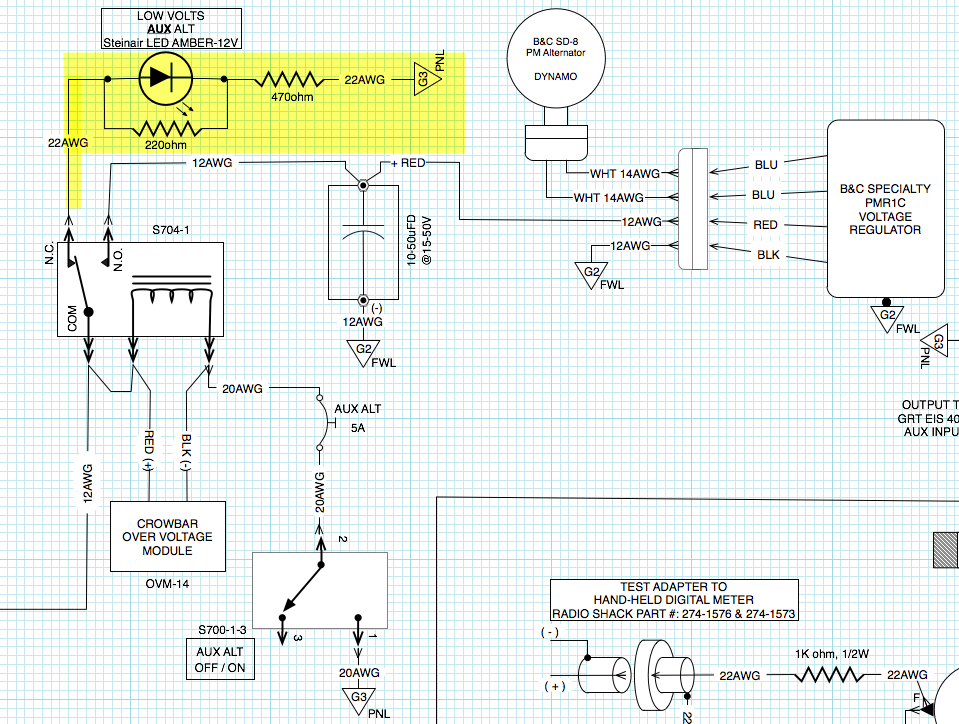

LSE has a recommended Dual Power Supply wiring schematic. I've
attached below, and link is also here.
http://www.lightspeedengineering.com/Manuals/PS_Diagram.htm
Should I just simplify my dual batt brownout schematic and just use
a single Shottky diode between the two as shown in LSE's schematic?
No. One ignition from the main battery bus,
the other from the endurance bus. Each to have
it's own breaker and one system to enjoy dual
power sources no matter what. You don't need the
second battery/diode combo. If you're not putting
in Z-13/8, THEN you use the dual batteries/diode
configuration.

PostPosted: Tue Mar 15, 2011 9:36 pm    Post subject: Need help in reviewing Z10/8 arch for dual Lightspeed ign. Reply with quote
At 08:07 PM 3/15/2011, you wrote:
I switched back to a Z13/8 architecture as my base. I did include a
very small (3 lb / 2.2Ah) battery to support my EFIS's, AHRS, and
Engine Information System (EIS4000) to be ON prior to start.
Again, my reasoning for this is that I want to be able to turn on
EFIS 1/AHRS 1 and EFIS 2/AHRS 2 to start the AHRS alignment since
that can take up to two minutes. I also want the EIS on for oil
pressure during start.
I'd like your feedback on this small AUX Battery circuit, since I

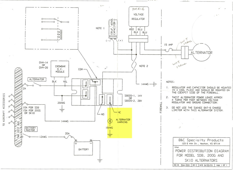

> "(a) on the LOW VOLT warning light circuit for the SD8
Alternator....is this wrong in your schematic?"
Which drawing? Warning lights shown on any
of my drawings become surplus if you've got
lv warning built into other systems.
I pulled that off the B&C Power Distribution Diagram for the
SD8. I've attached it below. It shows the alternator warning light
coming off the Normally Closed tab thru the light, and then to ground.
Please don't mix/match features of multiple architecture
sources. Let's pick one Z-figure and adjust as necessary
to meet your needs. I'll suggest Z10-8
Bob, did I wire this correctly for the SD8 Low Volt LED light in my
architecture?

Regarding your question on the SD8 Low Volt Warning light....
"Which drawing? Warning lights shown on any of my drawings become surplus if you've got lv warning built into other systems.
The only other LOW VOLT light I have is on the L-60 circuit.
Here's a clearer picture on my question regarding the SD8 Alternator LOW VOLT Warning light wiring. My goal here was that when running just on the SD8, I could use a low voltage warning for the SD-8 to indicate when the battery is actually carrying part of the load. At 2700 Prop RPM (SD8 (at) 3500 RPM) I get 8.4 to 10.1 amps with high fuel consumption. Having the Low Volt light allows me to make the tradeoff in flight, depending on the distance to destination.
I've sized my endurance bus to 3.7V....but if I wanted to keep some equipment on with the SD8 I'd like to be able to make that tradeoff to help get me down (assuming IFR, in the soup).
So directly my question is....by swapping in the LED light on the highlighted circuit is it wired correctly?
Since I couldn't find a Z-architecture that had this included, I used the B&C SD8 Power distribution diagram as reference on where to pull the light warning signal.
Also can you please explain how the OVM-14 module works in tripping the light to come on....or point me to one of your articles that explains that better. I'm not clear on how this works.
Thank-you,
Howard
B&C Specialty SD8 Alternator Power Distribution Diagram showing how to wire with a Low Volt Warning (INCANDESCENT BULB) light.
 Filesize:  308.36 KB
 Viewed:  5432 Time(s)
Snipit of the SD8 Low Volt warning light circuit from my GlaStar schematic.
 Filesize:  171.32 KB
Howard Plevyak
GlaStar / Cincinnati, Ohio
PostPosted: Wed Mar 16, 2011 3:57 pm    Post subject: Need help in reviewing Z10/8 arch for dual Lightspeed ign. Reply with quote
At 11:40 AM 3/16/2011, you wrote:
Bob,
Thanks for the quick reply. I'll make the tweaks.
These are NOT the kinds of things you want to be doing
in flight. When the big guy wanders off into the weeds,
then you should have a Plan-B for the little guy's
task. When A fails then B and continue flight to
airport of intended destination.
You don't need a light to tell you anything that
is pre-ordained by planing.
You won't find a pilot's operating handbook anywhere that
has the crew flipping switches, taking measurements, and
crafting new plans based on real-time judgement calls
as an in-flight activity. When the main alternator fails,
craft a plan, test the plan, exercise the plan as necessary,
fly the airplane . . .
That's not a "LOW VOLTS" warning light, it's an "ALT OFF"
annunciator.
Ditch that light. I was under the impression that
you had some form of Low Volts warning in one or more
of your panel mounted accessories. If not, then you need
some independent, timely, and insistent notification
like our 9005 DIY project or Eric's LV warning light
module.
See: Chapter 6 in the 'Connection.
