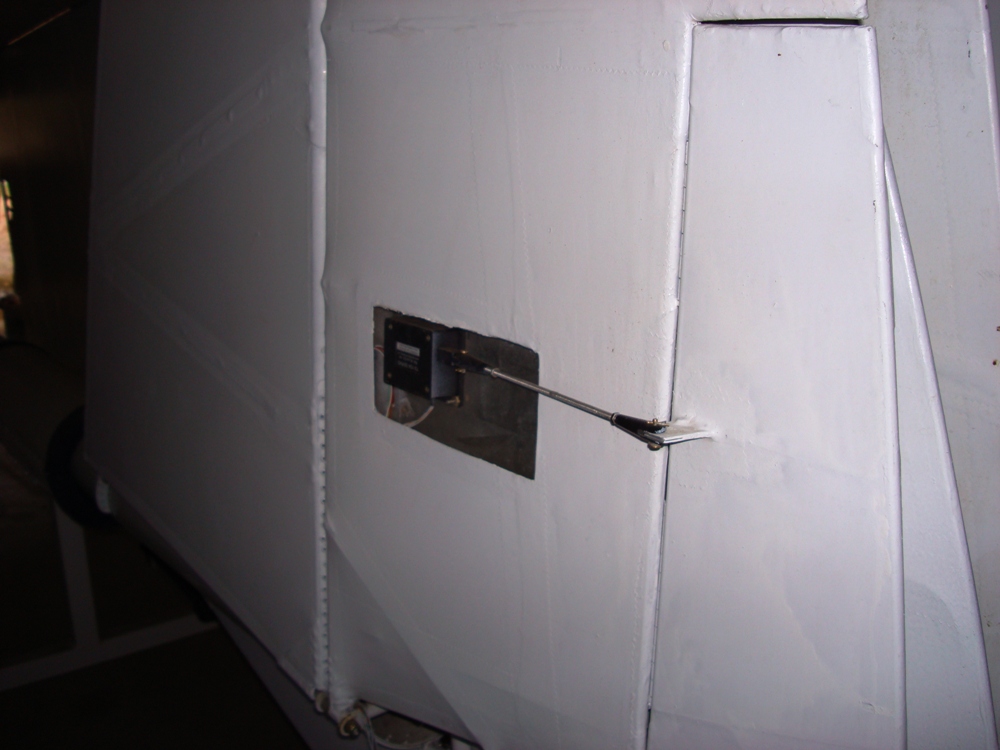

> mike
the spring adjustment is to add nose up trim... it will not assist with
down trim..
if he raises the leading edge of the stabilizer, that will eliminate the
need
for pushing forward on the stick. if someone did some experiments with the
leading
edge of the stabilizer> boyd young
mkiii
Boyd,
  Thanks for the clarification.
  Has anyone considered an Ray Allen electric servo to adjust a trim tab?  Wouldn't
something like this allow for an initial in-flight solution to a heavy "forward
or aft" stick force?
  Here's what I did.  (see photo)  I also built an electronic circuit the PRECISELY tells me
the exact position the trim tab is in.    (I have a vertical line of 10 LEDs (green, orange, red)
the show the specific and exact position.)
  The trim tab operation is controlled by a toggle switch on my stick grip for nose down,....or
nose up trim.
Mike Welch
MkIII
