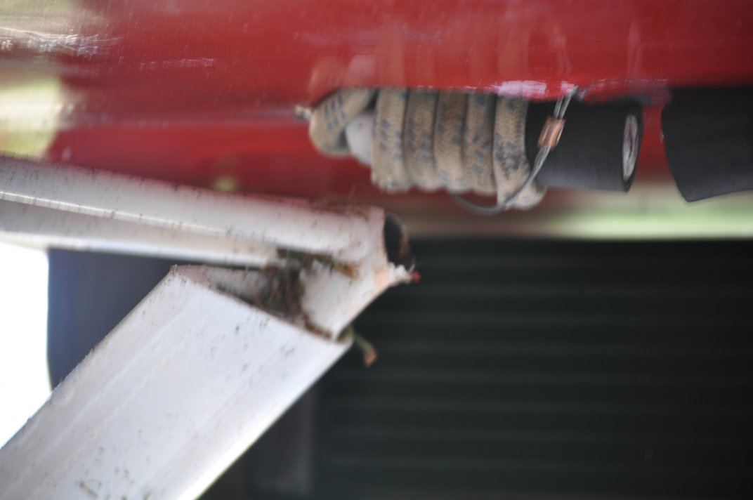

I too had experienced gear failure due to use of a thin walled replacement gear. Luckily, this happened during a slow taxi after landing. If this happened upon landing, it could have been catistrophic. It appears the thin wall tube was weakening after each landing and shows a flat area on top of the tube at the break. There's a lot to be said for a Grove Gear.

PMorel...On your pic, it looks like the weld on the underside was a little cold and let go, allowing the remaining circumference of the tube to oil can and finally fracture. I agree however that the thick-walled tubing is a good idea, especially at this highly stressed point.

OK so at any rate, I learned a few valuable things about the gear leg design. There have been lots of failures of this nature and all start at the toe of the weld with the crack propagating around the tube. When you have your safety cable wrapped around that part of the tube it does absolutely ZILCH for you when the tube breaks. I made my cables just a tad longer and I run it inside the triangle where the angled down tube comes in so you still have the safety cable in place when the tube breaks.
I went with the Avid wide / heavy gear (we used this gear on a couple of local kit foxes including my brothers). I chose to cut the tab off the end of mine and slid a tube INSIDE the gear leg so I had a good tube without any welds to start the fracture on. Welded the tab that holds the bungees from slipping off back on and now have a double tough tube for the bungee to wrap around.
