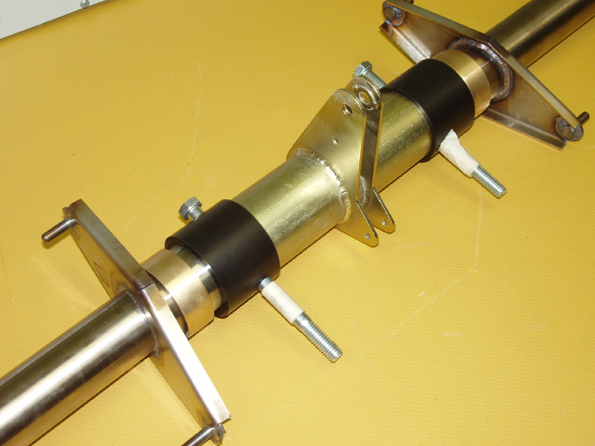

flyingphil2
Joined: 04 Dec 2009
Posts: 117
PostPosted: Tue Mar 01, 2011 8:55 am    Post subject: Re: tp9/tp10 retention Reply with quote
Hi Rowland,
With regards to the new re-designed torque tube then I have one of these. As Roger put it to me, the new torque tube no longer has any torque.
Basically the whole design has been beefed up and there are now only 2 pins involved, not 4, see attached photo.
My main concern when I received this was the weight increase. My numbers are below:
Old Tube:
TP4 - 1350g
2 x TP5 & TP6 - 270g
TP9 - 200g
2 x TP12 - 800g
Total = 2.620kg or 5.776lb
New Tube:
TP4 - 1330g
2 x TP5 & TP6 - 330g
TP9 - 1250g
2 x TP12 - 1060g
Total = 3.970kg or 8.752lb - 52% above original.
NB. (Pat Tunney's clamps would add 0.4kg bringing an original assembly to 3.0kg).
My mind was originally put at rest when I was told that monos (or conventional taildraggers as my aircraft is likely to be) like having an aft c of g and so this additional weight at the back would be ok. I tried not to think about it too much and decided it would be ok ......
Hope that helps.
Phil

peterz(at)zutrasoft.com
PostPosted: Tue Mar 01, 2011 9:26 am    Post subject: tp9/tp10 retention Reply with quote
Wouldn't the same issue with hammering out of the holes (if not an interference fit) still apply to the two drive pins?
Just curious,
Pete

PostPosted: Tue Mar 01, 2011 9:35 am    Post subject: tp9/tp10 retention Reply with quote
Phil
You could always put the battery in the original position under the cowling
on top of the foot well. That would save you a great length of thick copper
cable.
Pete

Hi Phil,
Do you nhave pictures of a new design?

Hi,
In response to other postings:
The thickness of the material involved is greatly increased. I guess the 2 pins may eventually wear the holes and introduce play but I think the rest of the aeroplane may have worn out long before.
Michel - picture attached with my posting.
Richard - I purchased my Torque tube early last year and I think the design had been around for a while before (at least 6 months). If you could post a picture of your tube then I/the forum could easily identify what type it is.
Phil
PostPosted: Wed Mar 02, 2011 5:25 am    Post subject: tp9/tp10 retention Reply with quote
Hi Phil,
Please excuse my lack of part number knowledge, but using descriptions instead:
- the center pushrod/counterweight driven assembly does indeed look thicker - and no longer stainless steel?
- the tailplane drive assemblies however look similar to the the original ones as far as material thickness is concerned... do they indeed have significantly thicker gauge tubes?
Cheers & thx,

PostPosted: Wed Mar 02, 2011 7:26 am    Post subject: Re: tp9/tp10 retention Reply with quote
Hi Peter,
You would have to check with the factory on this but:
1. Centre section (originally TP9) is beefed up and on the grounds that it is zinc plated, it won't be stainless steel.
2. The tailplane drive assemblies (TP12) are heavier according to my numbers and so yes, they are a thicker gauge. Not sure how much thicker.
Phil
