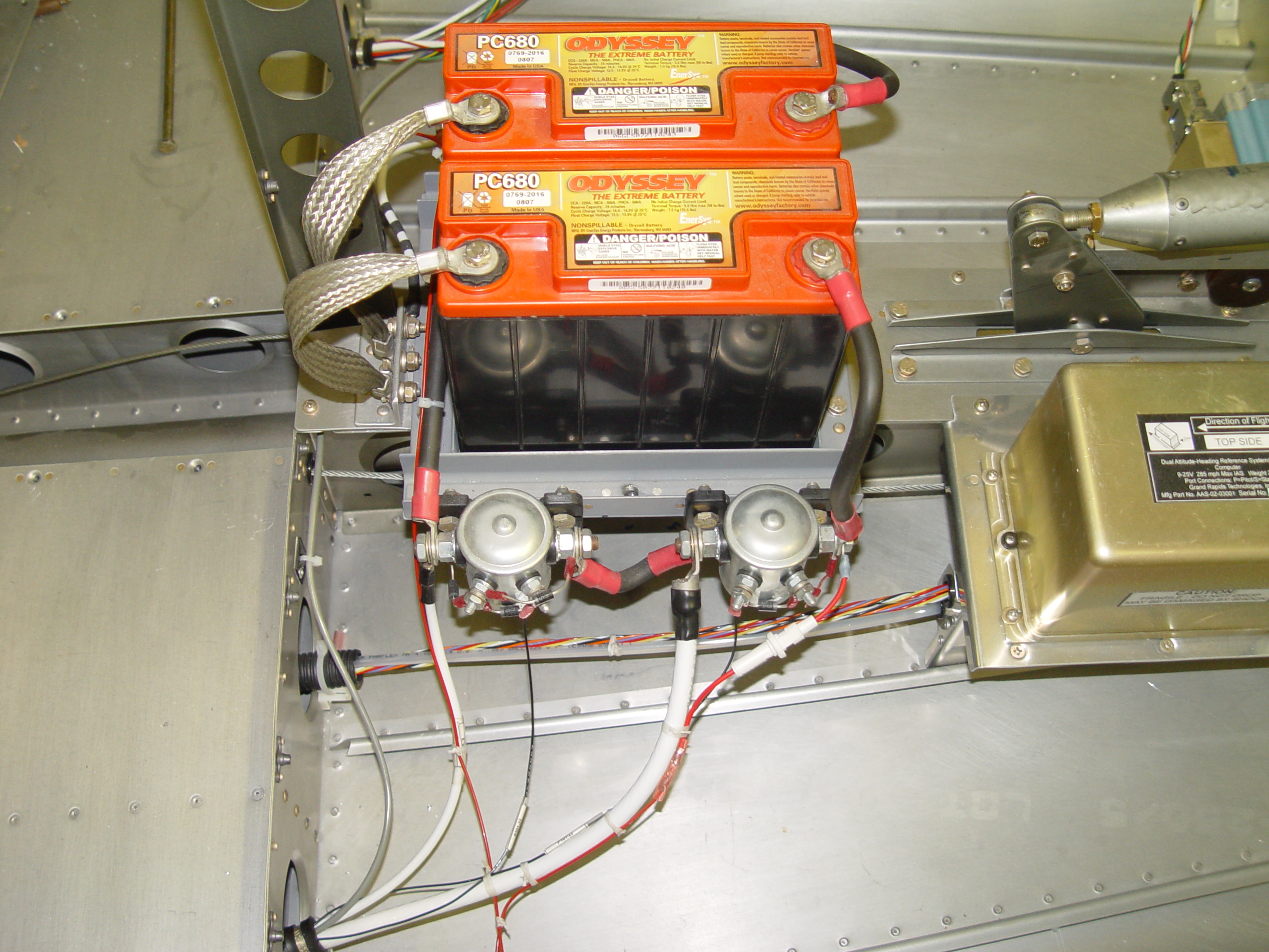

Added a pic of battery compartment to show some of big wire electrical
system stuff at the bottom, and a conduit run in the middle of the pic.
You can also see my battery to frame ground setup.
pic. You can also see my battery to frame ground setup.
