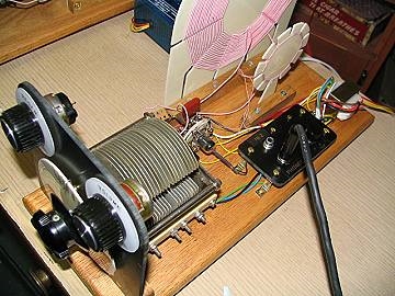

Back when grandpa was a interested in working with
that 'radio' stuff, it was not uncommon for the DIY
electronics project to be built on a sheet of wood
with devices simple screwed down to the surface. If
one needed the occasional tie-point, a brass nail
driven into the wood could be a place where multiple
conductors could be soldered together at a mechanically
stable location. This was often referred to as 'bread
boarding'.
Modern practitioners of the ancient arts are still
making good use of grandpa's techniques . . .
[img]cid:.0[/img]
