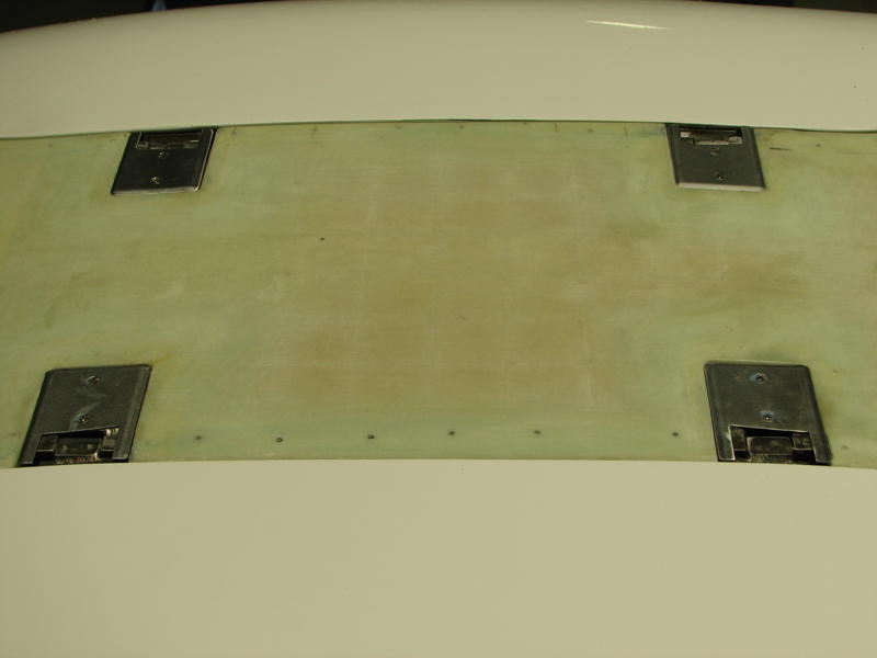

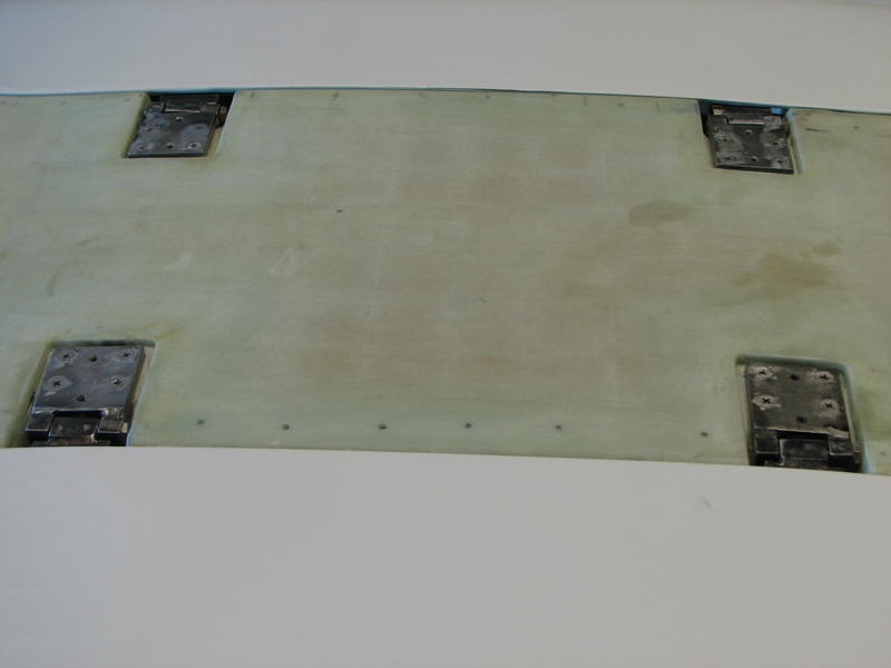

PostPosted: Mon Feb 28, 2011 6:06 am    Post subject: Door Hinges Reply with quote
Kelly, here is a couple of shots that should help..... btw, would you still like to have a set of the hinge covers. Sorry I hadn't sent them off already.

PostPosted: Mon Feb 28, 2011 7:37 am    Post subject: Door Hinges Reply with quote
FYI, the hinges definitely rate multiple trial fittings and clear
marking. I've found it impossible to visually determine which hinge is
which. When I guess, it's ALWAYS wrong. Only my markings allow me to
get them back on right. And when you paint and prime, make sure you
maintain your marks.
Bill "screw up once, then measure thrice" Watson
