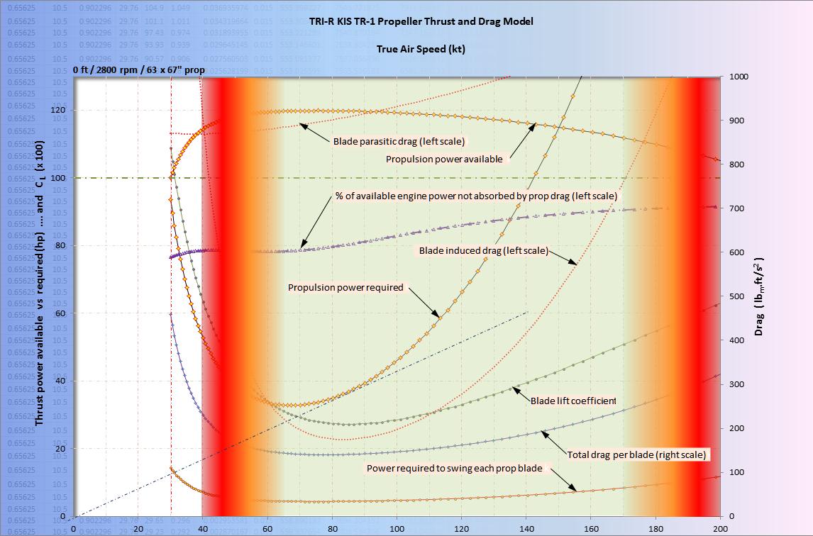

In late January I created a performance model for the KIS to aid my decision regarding a new propeller. Having consulted with Mark Ketttering off line I am now satisfied that the model is realistic.
Attached a view of the results for a particular point on the flight envelope.
There is one big caveat though and I hope the forum can help with that: I need a power curve for a O-240 or IO-240 engine to ensure that the engine power model is accurate.
I can only hope that someone on the forum has access to such information.
Anyways, take a look at the results. It seemed to work well enough for my plane (when it was still flying Confused )
Alfred

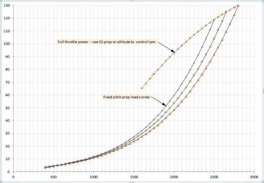

Ok, cancel that question about O-240 engine power curve. I hauled out the Rolls Royce overhaul manual for my engine and found a curve for the friction horse power (up to 22 hp at 2800 rpm). The manual makes it clear that friction horsepower is already discounted when in the rated b.h.p. figure of 130 hp at 2800 rpm.
So I simply matched a polynomial curve to the friction horse power curve and scaled it to 130 hp. Voila!
Result attached if you are interested. Scaled to suit rated hp, this curve would be quite accurate for the entire O-240 engine family.
Alfred

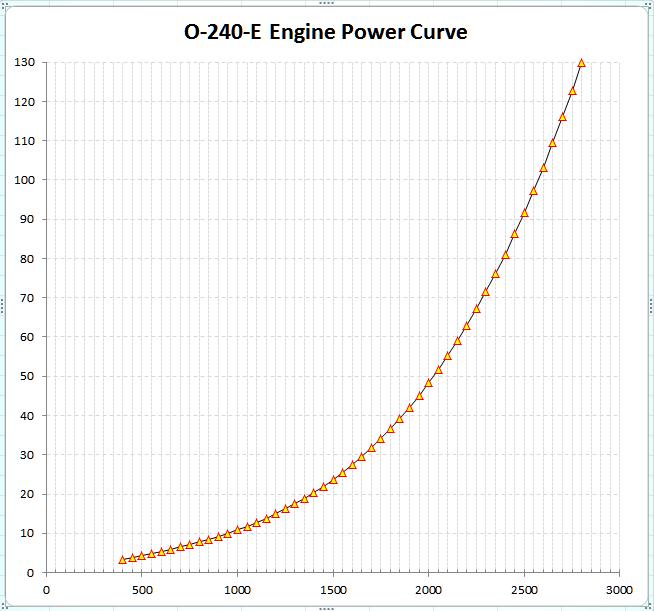

 Filesize:  61.75 KB
 Viewed:  18498 Time(s)
_________________________________________

PostPosted: Mon Mar 07, 2011 10:44 am    Post subject: Re: KIS TR-1 Propeller Reply with quote
With the aid of engine data provided by OC the engine power model has now been completed as per attachment.
Note: The charts in manufacturers' documentation often exclude the lower end of the rpm range (below ~1900) and therefore lines in those diagrams will appear to be straighter.
 Filesize:  77.56 KB
 Viewed:  18482 Time(s)

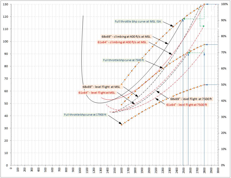

PostPosted: Sat Mar 12, 2011 1:10 pm    Post subject: Re: KIS TR-1 Propeller Reply with quote
Light a the end of the tunnel! ... and about time too Surprised)
In late January I started exploring to find the best replacement propeller configuration for the recently acquired KIS TR-1. The objective is to replace the old 2–blade 68 x 69 inch �cruise’ prop with a new prop which will markedly improve low speed climb performance after take-off at full weight. It turns out that the new prop should be a 3–blade 61 x 64 inch �climb’ propeller. The insights gained from these studies have turned upside down all notions I previously held regarding what may or may not constitute an optimal propeller.
Initially I was quite ambivalent about 3-bladed props, but results of the comprehensive performance modeling exercise showed conclusively that a 3-blade prop offers significant comparative performance gains at low speed and also at high altitude (i.e. high density altitudes) – with only a small sacrifice in top end speed. This follows from the fact that an 8-fold increase in power is required for a given speed increase. Trading power for top end speed is therefore not a very effective use of power unless you have oodles to spare … thinking of Scott here ;o). For us lesser mortals with engines cranking out 130hp or less (at best) it may be sensible to forgo a few knots at the top end (~ 5 knots ) in order to gain a bucketload of spare power to support much improved acceleration and climb performance at the lower end of the speed range in combination with better performance at high density altitudes.
For general interest, and for others who also have a problem with sluggish takeoffs, the findings are described below with reference to the attached diagram. From previous communications about propeller performance it seems that many KIS TR-1 planes are fitted with 68 or 69 inch pitch props. Those owners my find the information below particularly relevant.
For actual propellers the choice is still between Prince P-tip, Catto and Idrovario.
Kind regards,
Alfred
The old (61 x 69”) and the new (61 x 64”) propellers are compared for three typical operating points:
A) Climbing after take-off nominal MSL
B) Level flight at low altitude (nominal MSL)
C) Flight at 7500 feet (or equivalent altitude where only 75% of engine power remains)
Notes: (i) Green arrowhead lines connect the tips of the three pairs of old vs new performance comparison lines on the diagram.
(ii) Full throttle B.H.P. curve information supplied by OC Baker was instrumental in making it possible to complete the analysis.
(iii) Although I refer to the new prop as a �climb’ prop it cruises perfectly well – the distinction is merely in name, not in application.
(iv) Brake specific fuel consumption does not vary by much over the RPM range of interest. Refer http://en.wikipedia.org/wiki/Brake_specific_fuel_consumption
A) Climbing after takeoff.
With the old prop, engine rpm tops out at less than 2750 in level flight at low level. Upon starting to climb the rpm then drops – to just below 2400 rpm for climbing at 400 ft/min. When operating at this point, only 91% of the available engine power can be accessed. The rpm drops despite WOT and the operating point slides to the left and downward on the �full throttle’ b.h.p. curve for MSL – shedding power along the way. [Refer to the uppermost bhp curve in the diagram.]
Because it is so important to retain access to all of the power that the engine can deliver, the new prop has smaller diameter (less torque) and finer pitch (lower blade loading). It allows 2800 rpm to be maintained whilst climbing at 400 ft/min. For the O-240 engine this produces an extra 12hp in the climb compared to the old prop – and 12 horses can give the TR-1 a goodly lift.
With the new prop one can truly cruise and climb well at the same time. If WOT is used, the climb rate must exceed 400 ft/min to avoid over-revving. Correct handling of the throttle to prevent over-revving is essential. (A rpm monitor and alarming device will be installed.) The climb rate can of course be increased so that the rpm drops to ~2400 – as for the old prop. The resultant climb rate is then just about double that of the old prop. At MSL and 2400 rpm, the new prop will apparently sustain a cruise + climb combination of 122 kt + 780 ft/min. As altitude increases the climb rate could be steadily relaxed to maintain the speed.
B) Level flight at low altitude.
In level flight at low altitude the old prop could not achieve maximum rpm of 2800 and dropped to 2400 rpm and below when climbing at 400 ft/min. In stark contrast, the new prop could be over-revved in level flight up to altitude of ~8000 feet. This is an unavoidable side-effect if one desires to have the option to extract all the power the engine can deliver – essential for operating at �hot & high’ fields where density altitude routinely exceeds 8000 feet. During the cruise climb, rpm must be maintained at 2800 or preferably a little less. (If cooled properly, the Rolls Royce O-240-E is rated for continuous operation at 2800 rpm – not that one would do that all the time.)
C) Flight at 7500 feet.
At this higher altitude, only 75% of the original engine power remains – and that only if 2800 rpm can be maintained. Reduction of rpm below 2800 results in less power being accessible. [Refer the middle tier �full throttle’ curve in diagram below.] It can be seen that the maximum power available to the old prop with WOT in level flight was a mere 70%. The effect of climbing is to further decrease the rpm despite the WOT. The resulting loss of power seriously inhibits climb performance at this altitude. The new prop enables access to all the power still available at this level and provides the freedom to operate at any chosen point on that �full throttle’ bhp curve. In particular, climb performance is markedly improved. The same applies to all altitudes below ~8000 feet.

On Sat, Mar 12, 2011 at 3:10 PM, BlueSkyFlier <bleuskyfly(at)teledynamix.com>wrote:
replace the old 2–blade 68 x 69 inch ‘cruise’ prop with a new prop which
‘climb’ propeller. The insights gained from these studies have turned upside
density altitudes.
Idrovario.
Kind regards,
Alfred
(iii) Although I refer to the new prop as a ‘climb’ prop it cruises
the operating point slides to the left and downward on the ‘full throttle’
a goodly lift.
gbrighton(at)skymesh.com.

PostPosted: Mon Mar 14, 2011 2:43 am    Post subject: Re: KIS TR-1 Propeller Reply with quote
Chuckle chuckle ... Laughing
Hi Galin. I was thinking of you when I did the write-up because I did previously say to you that a 3-blade prop is rarely if ever better than the 2-blade -- that statement still holds if both prop types have the same pitch.
In such case the one advantage of the 3-blade is that the lower power loading per blade reduces the lift coefficent on the blades. Therefore the 3-blade stops cavitating (starts to 'bite' properly) at lower forward speed than a 2-blade generating the same thrust. Takeoff acceleration therefore benefits. The price to pay for that benefit is the higher parasitic drag of the 3-blade prop.
In any case, reducing the propeller pitch is what really makes the difference and is essential to release the extra RPM needed to tap into the top end of the 'full throttle' curves at any % remaining power. The parasitic drag penalty is offset by reducing the diameter accordingly.
One important observation from these studies is that steeply banked turns should be given a wide berth in the KIS TR-1 if you have less than 130 hp up front coupled with a propeller pitch in the high 60"s. Anything more than 55 degree bank has the potential to really spoil you day - and everyone else's too.
[Bonbons for those who spot the obvious little booboo in two of the labels on the diagram Surprised)]
Cheers,
Alfred

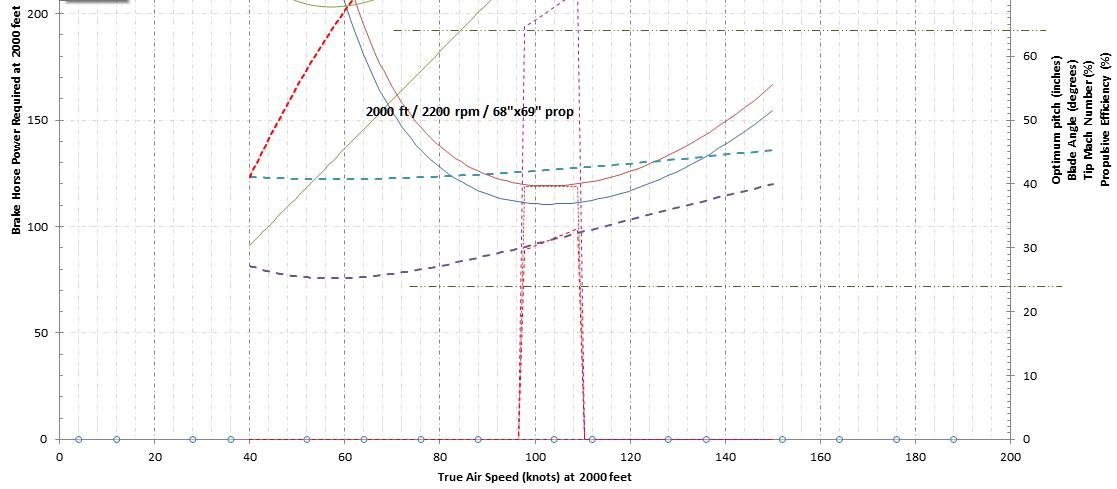

BlueSkyFlier
Joined: 27 Jan 2011
Posts: 74
Location: UK
PostPosted: Tue Mar 15, 2011 10:56 am    Post subject: Re: KIS TR-1 Propeller Reply with quote
Whoa guys! The intention was not to insult the plane. I own one too, remember.
Once you have done your HASELL check, no problem. We all need to do those turns to pass the checks. I also did a snap roll recently in training – sussing out where and when she drops a wing in stall speed regime - also when getting too slow in a slip, especially to starboard. No problem with recoveries if you have height.
The point I'm making (badly so seemingly) is that it puts you into a region of the flight envelope where you have preciously little spare performance to get out of trouble if you don't have height to spare. To answer OC’s question, that’s why engine power and prop pitch comes into the equation. Rich and Scott hit the nail on the head. With current parameters, the model indicates that - with 125hp engine and 69” pitch prop - it would be difficult to sustain a 60 degree turn above 3500 feet altitude.
I propped the propeller and power configuration for OC’s plane into the model. Results in diagram attached below match what he reported – the speed he referred to would be IAS. With the graph based on TAS, it is of course offset slightly to the right from the 100 kts reported by OC. The dashed purple line is RPM (divided by ten – on lefthand scale). Good to have another confirmation that the model works.
Cheers,
Alfred
