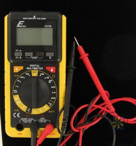

This one?
[img]cid:.0[/img]

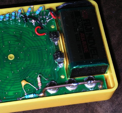

Every multi-meter of this genre' has what appears to
be a 'fat wire' jumper on the board that looks something
like this:
[img]cid:.1[/img]
Further, there will be one or more GMA series fuses
in open clips. The 'fat wire' is the high current shunt. It
a special alloy with a callibrated resistance. The really
GOOD ones use manganin wire which offers very low temperature
coefficient of resistance.
The fuse will be a very low current device . . . usually
0.5A or less that protects the lower current ranges from
overload . . . and may protect the ohmmeter circuitry
too.

>This one?
>Bob
Hi Bob,
  Yes, that's the one.   Yes, the large wire you refer to (shunt) is the one that
got toasted.  Yes, the little fuse was 500mA.  Yes, I accidently tried to measure
the 12V battery's current, although I didn't intend to!
