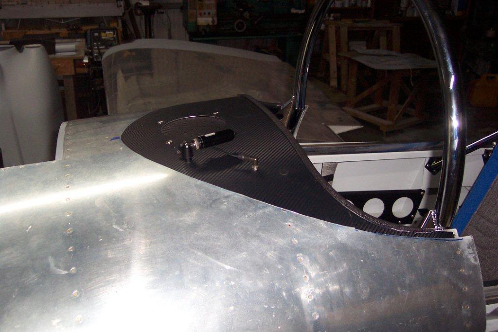

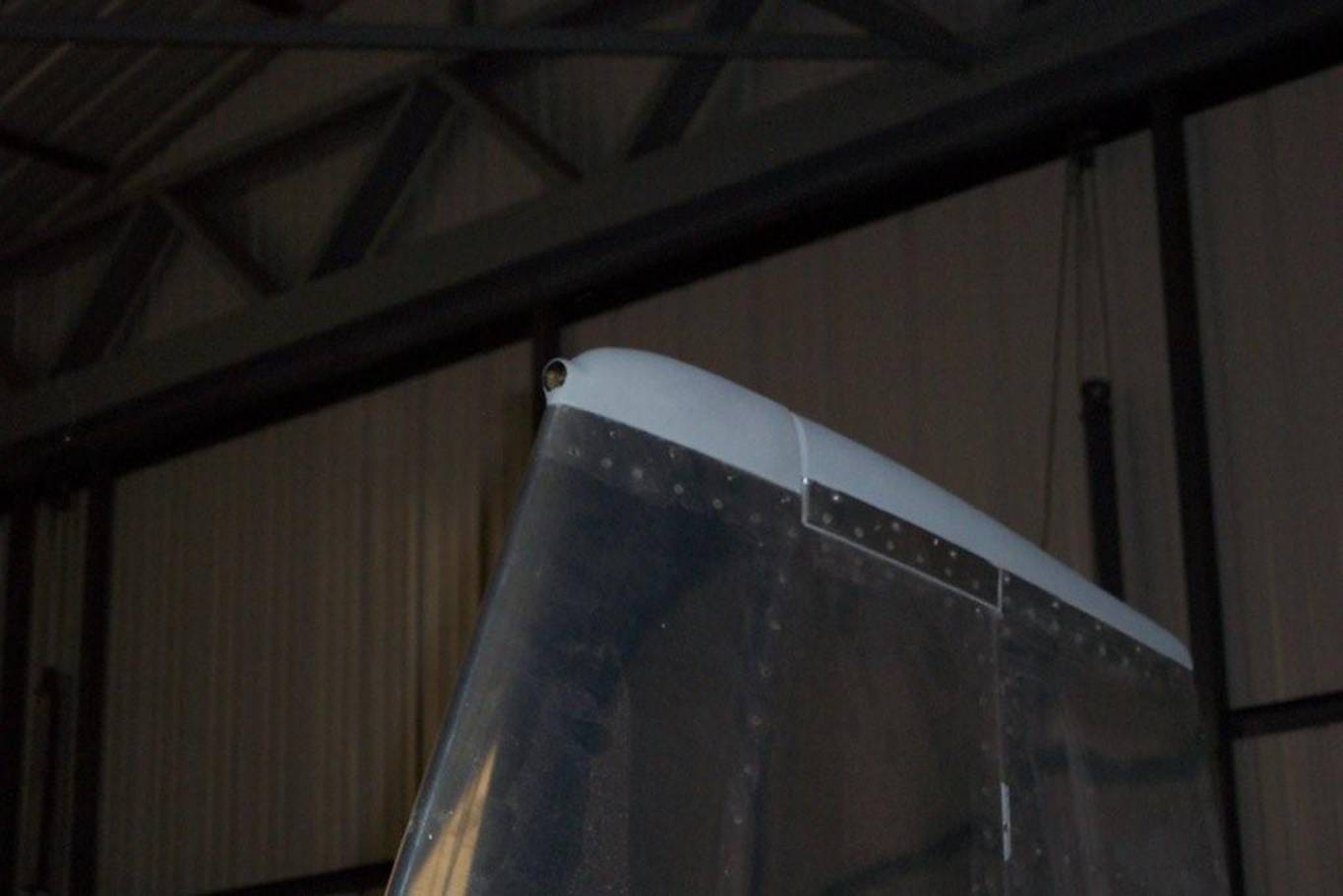

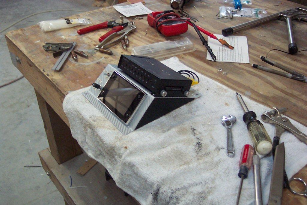

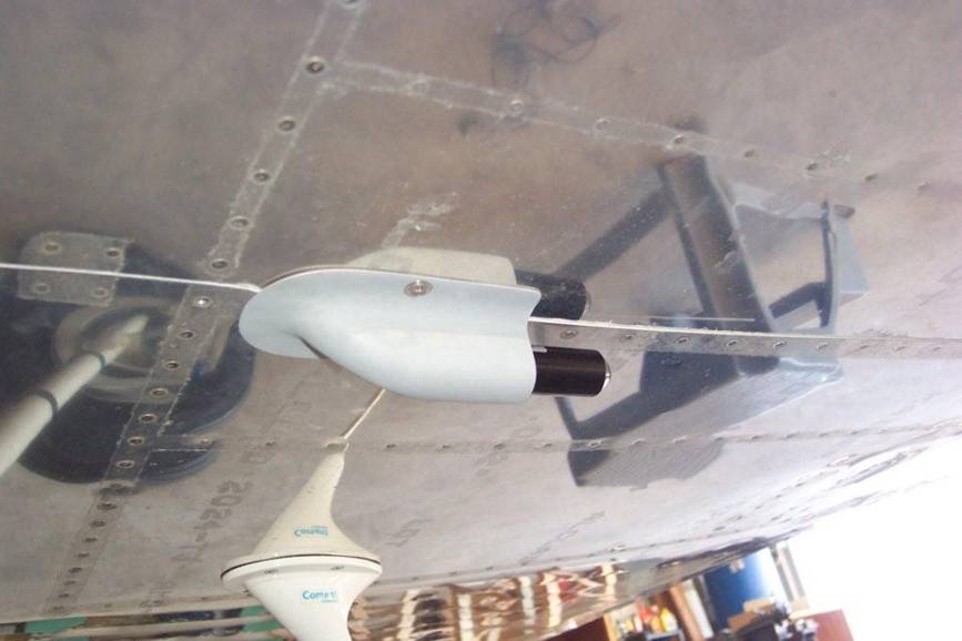

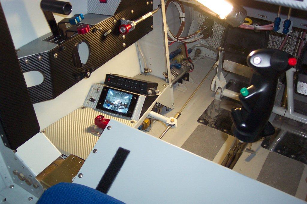

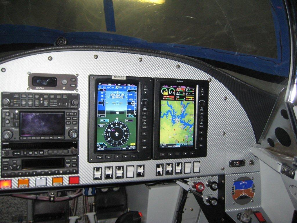

            I have placed a 3 camera (can add a 4th) video recording system in my 8A. One on the VS, one on the belly pointing aft and one in the cockpit to film both Pilot & squirming Passenger. The cameras are all 520 Line or greater bullet cameras with the choice of different lenses (~$100 each on eBay). The end result is a good looking image from multiple angles. The down side is the video is not HD. I was unable to find a small, reasonably priced remote DVR that recorded HD video so I decided to go with standard def and supplement it with something like GoProHD http://gopro.com or the ContourHD camera http://contour.com/  internally mounted. See Note at the end of this email.

DVR on top with removable memory card. Rotary camera selector.
View point shows full flaps plus cockpit, prop etc…
Rear facing belly camera. Should look good with the smoke on!
Tail camera

Can’t show you all these photos w/o showing the panel J
