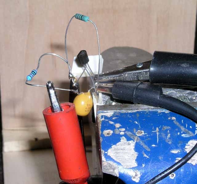

of the transistor. I spider-webbed the oscillator
[img]cid:.0[/img]
. . . and powered it up.

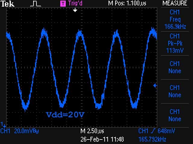

Sho'nuf. It WAS a weak oscillator given that the transistor had
to run on about .6 volts. Further, I couldn't get it to oscillate
at much below 15 volts. Here's the 20v trace showing about 100 mV
pk-pk signal.

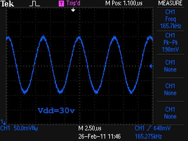

Here's the signal with a 30 volt supply (about 3 milliamperes through
the 10K resistor). The signal is much stronger, nearly 200 mV pk-pk.
