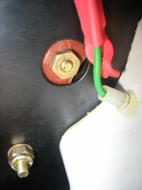

PostPosted: Fri Feb 18, 2011 3:51 pm    Post subject: Airmaster failure Reply with quote
<?xml:namespace prefix="v" /><?xml:namespace prefix="o" /><![endif]--> Ferg, Justin and Paul.
Should the nut come loose on that or any stud, the nut becomes the foreign object and can be responsible, but more than likely not, as the spinner hole is large enough that a foreign object can easily enter the hub. That said, the forward side of the back plate spins with the prop so in my opinion it can't generate enough torque to impact that stud hard enough. The next likely is fatigue failure do to some looseness in the bolt, over torque or the wrong material, and that is why I am so interested. Nylon lock nuts are great in that they don't need much torque and hold up well, but forward of the firewall heat it will sometimes rob them of there "stickiness" and age takes a bit of a toll. The prop does not get that warm to compromise a nyloc so it is an interesting failure. A good investigation and proper scratch analysis will Anyway
Anway
, I'll inform Martin at Airmaster.
Bud Yerly

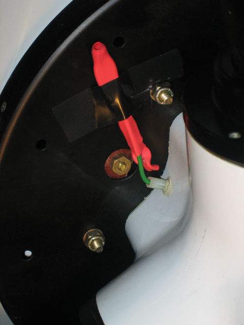

europa(at)pstewart.f2s.co
PostPosted: Sun Feb 20, 2011 8:27 am    Post subject: Airmaster failure Reply with quote
Bud
Herre’s a couple of pics Hugh has taken. As you can see he’s been in contact with Airmaster so no doubt they will respond next week.
Paul
G-GIDY

A couple of days ago, I was doing circuits and became aware that the Prop Controller had lost all power. Even the Manual Function was unavailable.
After landing, we discovered that the controllers thermal fuse/reset had tripped, as well as the 5 amp fuse in the main 12v supply. We could find no fault in the wiring this side of the propeller, so took off the spinner to look further.
The stud embedded in the slip ring plate to which the green Feather control wire should be attached, had sheared off. The remains of the stud and stiff nut must have been ejected from the spinner in flight, and the loose wire causing a 'short' which blew the fuse.
It would seem that we need a new Slip Ring assembly in order to put the situation right. We would appreciate any help and advice you can give us, and to dispatch whatever parts we may need.

Thanks for your rapid offer of help. Martin has a replacement slip ring winging its way to us.
