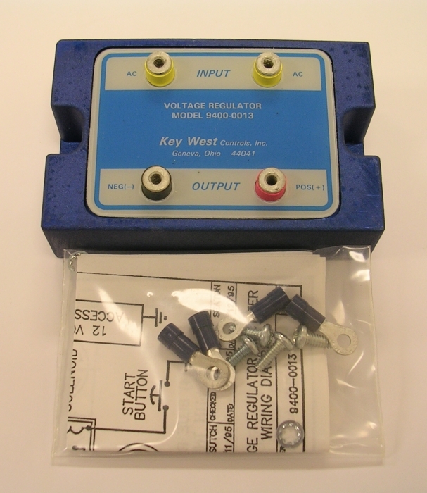

If I replace the regulator I'm considering the Key West. Question about integrating into the Z16 wiring scheme. I assume the + & - input terminals are connected to the yellow wires from the dynamo. Not sure how to hook-up the + & - output terminals. Can anyone help me with that?
Do you have the Key West installation instructions?
If it is this device:
[img]cid:7.1.0.9.0.20110220113902.01fbed20(at)aeroelectric.com.0[/img]
The terminal markings are pretty definitive. AC input is from
your alternator winding, NEG(-) goes to ground, POS(+) would
go to the control relay.
But check your control relay closure first. It seems unlikely that
you would suffer TWO Rectifier/Regulator failures.
