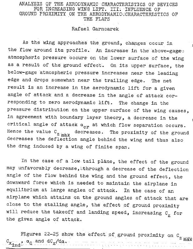

Since before buying the KIS TR-1 late last year I have been researching the possible reasons for the nose dropping tendency which the TR-1 is sometimes alleged to display on occasion. During this exercise I learned quite a bit about laminar flow wings and ground effect, the sum of which led to me to conclude in brief that:
1) NACA six digit laminar flow wing (even with straightened rear profile) definitely prefers to be operated within its design range – which for the KIS is nominally where 0 ≤ CL ≤ 0.4
2) Angles of attack which pushes CL > 0.8 for the 63(2)A215 profile profile rapidly increase the negative moment (i.e. the forward pitching moment) [where “A” in the profile code accounts for the flat surfaced flap and ailerons at the rear of the wing].
3) The flat surfaces on the flaps and ailerons could apparently be the reason (inter alia) why the TR-1 tends to mush gently in the stall instead of popping down the nose.
4) When entering ground effect whilst maintaining a fairly conservative angle of attack, the vlaue of CL will increase automatically by between 5% to 8% [refer attached diagram]. Viewed on its own this would seem to be a beneficial effect. However, at the same time, the critical angle of attack (i.e. the stall angle where boundary layer separation occurs) and associated CLmax decrease due to changes in pressure distribution. It follows that, if ground effect is entered with an angle of attack which is too close to CLmax , the combination of resultant increase in CL , decrease in CLmax and increasing negative moment may tip the balance over the edge and conspire to upset the stable state of affairs.
5) Furthermore, the changed angle of airflow across the low tail section could also reduce the elevator authority required to offset the increased negative moment and/or counteract the imbalance which may arise.
Over the weekend I finally came across two references below which seem to pull all these fragments together into a whole that makes sense.
(i) “Synthesis of subsonic airplane design” by Egbert Torenbeek, page 552 in particular.
(ii) Analysis of the aerodynamic chracteristics of devices for increasing wing lift – Part III – Influence of ground proximity on the aerodynamic characteristics of the flaps; by Rafael Garncarek – translated from the original for NACA’s library.
(Small excerpts from the relevant pages of these two reference are attached with due acknowledgement to the respective authors.)
So what does this all mean? To me at least, it indicates that the TR-1 (which is but one example of such laminar flow low wing aircraft) would provide a good margin of security during landing if the main gear is touched down at circa 55 to 65 kts with a fairly flat aircraft attitude and with only one stage of flaps - providing runway and other factors allow. Attempts to hold off at high angle of attack with full flaps close to the ground may well invite the unwelcome effects mentioned earlier, all of which can be avoided by getting the gear down before bleeding off the residual speed by carefully keeping the nose up while she runs out. Setting RPM in descent/glide to the “zero prop drag” value will also help. Such RPM setting can simply be calculated from the propeller pitch and intended touchdown speed and does not need to be very precise at all. Somewhere between 1300 and 1450 would work well for most propellers and of course this has to be reduced gently to idle as main gear settles down.
NOTE: I know that the matter of appropriate landing technique may be an emotive subject to some readers. So let me make it clear that I am merely sharing this information and what little understanding was (maybe erroneously so) gleaned from it for general interest. This does not constitute a recommendation in any way shape or form and readers are urged to draw their own conclusions from the original material and relevant further references therein if so inclined.
Happy landings,
Alfred

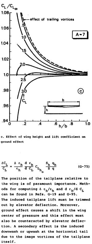

Note how ground effect can adversely affect the lift coefficient if full flaps and/or high angles of attack are used to achieve the higher values of CL.

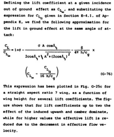

PostPosted: Wed Apr 06, 2011 1:27 am    Post subject: Re: Landing the KIS TR-1 Reply with quote
Of particular interest in the diagram which illustrates changes in lift coefficient in ground effect [attached to previous message above] is the tendency for lift to drop away when less than 20% of wingspan away from the ground if the CL > 2.
With full flaps the TR-1 wing can apparently achieve CL > 2 if the angle of attack is steep enough. In fact, when holding off with full flaps at high angle of attack in close proximity to the ground it is likely that this unexpected drop-off effect could be encountered - not to mention the contribution of adverse tail plane effects.
It therefore seems important to keep the angle of attack fairly conservative. This can be done by flying the main gear into touch with a fairly low angle of attack and comfortable speed (probably > 60 kts) . Once the gear is down the nose can be pulled up gently to generate maximum drag (the TR-1 will fortunately not easily lift off again without power).
(The equation from which the lift coefficient chart attached above was created is attached below for interest. The TR-1 aspect ratio being less than 7 will tend to exacerbate the unwanted effects.)

I may be wrong but it seems to me that this is looking for a complex reason for a very simply issue. As designed the main gear is too far aft. I think most if not all of the problem is once the mains touch down they impart a huge nose down moment due to their placement too far aft of the CG. I do not think anyone has had a real issue holding the nose up when flying even in low ground effect. I think the issue is only after the mains contact.
I also very much suspect the diagram and equation. I would really like to see the theory, math and experimental data behind it. To me it looks like a suspect empirical equation that seem to be way too popular in some aircraft design textbooks and in many papers. Not that empirical equations are not useful. They are! But you really need to be careful when applying them especially at one end or the other as in this case.
But even if the equation is correct I very much doubt the KIS achieves much more than 1.8 Cl even in the flapped area so this should still not be an issue.
Again, I could be wrong. And I am sorry if I am stepping on any toes but just wanted to express a counterpoint.

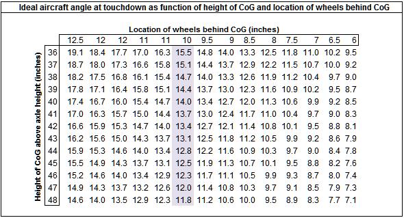

I'm not sure what the actual height of CoG is for the TR-1, but I know that my wheels are located about 10 inches behind the nominal location of my CoG.
Attached herewith a table in which I explore the aircraft angle (away from horizontal) required at touchdown in order to bring the wheels underneath the centre of gravity.
Assuming that CoG is about 36 inches above and 10 inches behind the wheels, it seems that one would need to have the aircraft at a 15.5 degree angle to get the wheels underneath the CoG.
Does anyone have nominal figures for height of CoG and/or aircraft angle at landing?

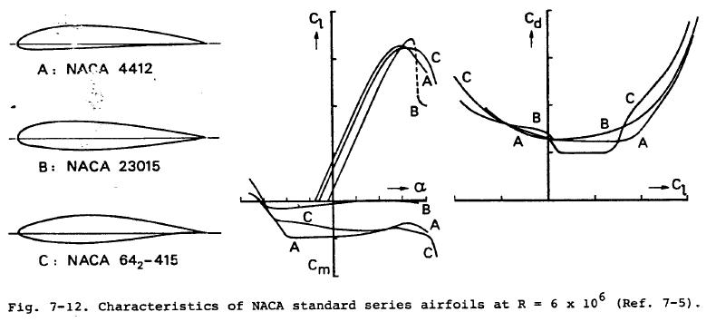

Earlier in this thread I referred to the tendency of NACA 6-digit wing profiles to prefer operation within their laminar flow design ranges. The KIS TR-1 uses a modified 6-digit profile which can be described as 63(2)A-215.
The 6-series was derived using an improved theoretical method that relied mathematics to derive the geometrical shape required to realise the desired pressure distribution. The goal of this approach was to design airfoils that maximized the region over which the airflow remains laminar. In so doing, the drag over a small range of lift coefficients can be substantially reduced.
To illustrate that, herewith attached a diagram in which the characteristic drag "bucket" associated with laminar flow can be seen - in this case for the NACA 64(2)-415 profile. This is from p.238 of Torenbeek's "Synthesis of subsonic aircraft design".
As can be seen from the diagram the drag increases rapidly as the lift coefficient moves beyond the optimal range, which helps to slow down rapidly but also results in high sink rate at non-optimal angle of attack. However, these profiles do exhibit docile stall characteristics.
A modification of the standard 6-digit series is the A-series in which the curved contours of the trailing edge is replaced with straight contours which run from about 80% of chord backwards - as manifested by flat surfaces on the TR-1 flap and aileron. The TR-1 wing therefore nominally represents a 63(2)A215 profile.
Just one more reason to avoid high angles of attack during landing ...

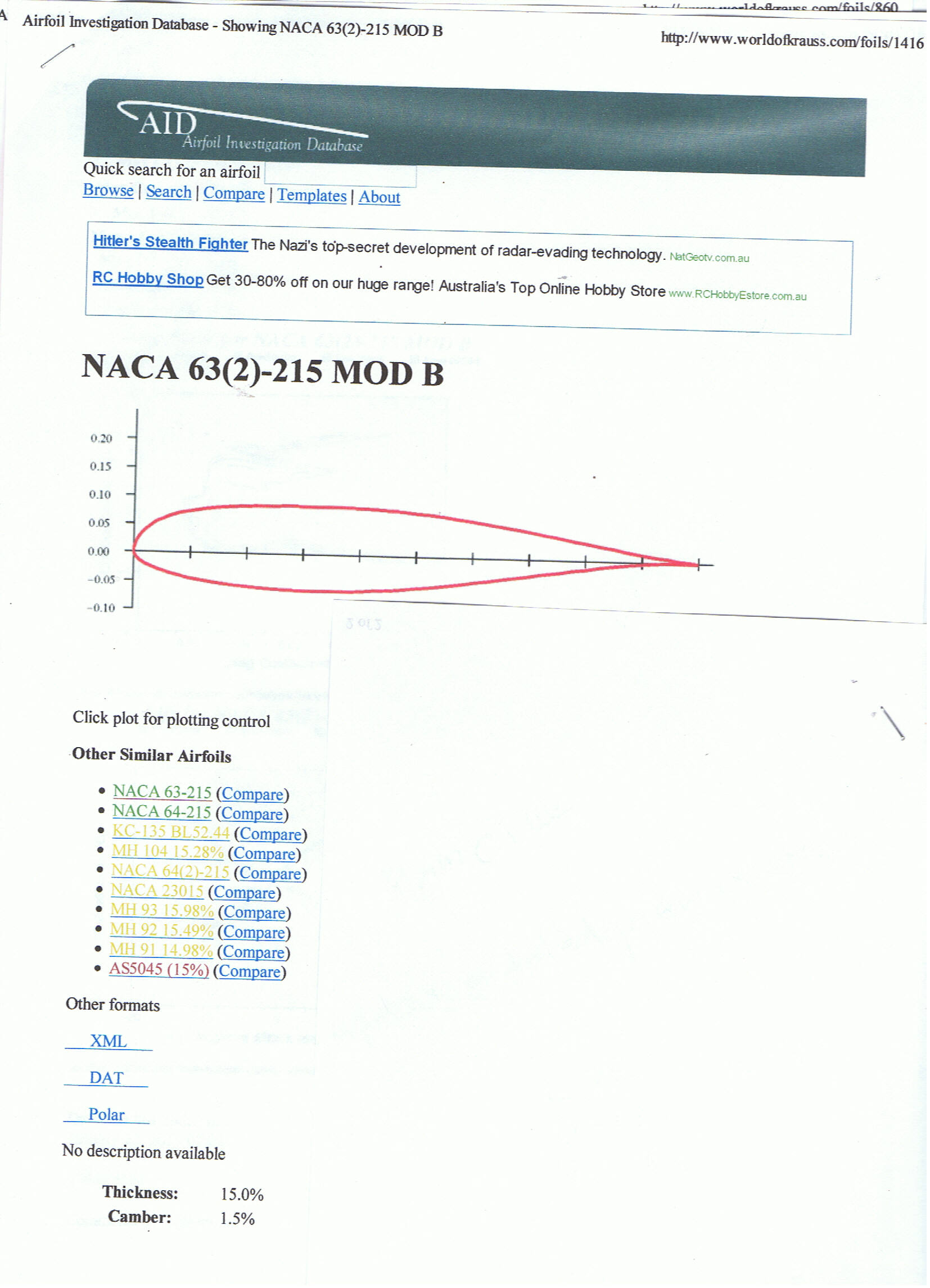

PostPosted: Thu Apr 07, 2011 7:39 pm    Post subject: Landing the KIS TR-1 Reply with quote
This is the only close Airfoil diagram i could find .but its not the TR1 profile is it .. Anybody got the correct one .?
Graham

I'm pretty sure the pitch down issue on landing is due to the main wheels being a bit too far aft and the elevator being a bit too small. It doesn't take much of an error in wheel placement to make a big difference in rotation speed and pitch down after touchdown.
When I was an engineer working on the proof of concept airplane for the Adam A500 we ended up with the main wheels a few inches aft of where they should have been (long story, not my fault!). The airplane hit about 100 KIAS before it could be rotated for takeoff and there was no holding the nose off after landing. Proteus is another good example. The main wheels are well aft due to the design and the nose comes crashing down right after touchdown.

Attached below a short list which compares pertinent characteristics of some of the 63 series foils (obtained from the same website a where Graham got the profile attached earlier).
The 63(2)A-015 profile in the table is closest to the TR-1's 63(2)A-215 and differs from the others in higher L/D ratio and larger trailing edge angle due to the flat trailing edge profile. The L/D ratio being highest even though the lift is less than the other airfoils indicates that the drag is quite low in comparison.
With Scott confirming effects of wheel placement, how about sharing figures for height of CoG? Since I have to work on my plane anyway I can just as well look at getting the main gear placement improved too.
Knowing that angle of incidence is 3 degrees and taking into account that stall angle is around 11.5 degrees (as from attached table) and assuming that full flaps decrease the angle of attack by about 2 or 3 degrees it seems that the aircraft angle at landing should be about 5.5 to 6.5 degrees maximum.
From the table attached to earlier message in this thread it then appears that the wheel location should be even less than 6 inches behind CoG - instead of the 10 inches it is now. If the main gear can be angled forward by about 10 degrees it should comes close to the sweet spot (depending on height of CoG).
I know that some builders have angled the gear forward. Does anyone have figures for that angle and or height of CoG?
Alfred
63(2)A-215.
