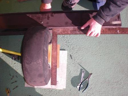

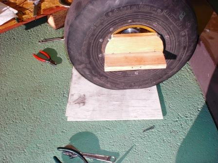

I made a piece of wood cut to the diameter of the wheel , and placing a piece of sheet metal to keep it centered on the rim. then added a side piece to help hold a carpenter square. then placed the wheel on a grease plate, (2 pieces of floor tile with a layer of grease between them. could use alum sheets)
[img]cid:3E442DAB8E3A4103A3F8F22FF71A7760(at)laptop1[/img]
by putting a straight board, or I used a steel angle supported with sections of 2x8 to hold it at the correct height. and held against the back of both tires. then used a carpenters square to hold against the straight angle. and laid it on the wheel bracket.

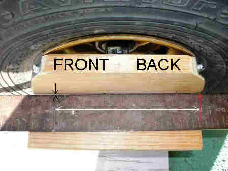

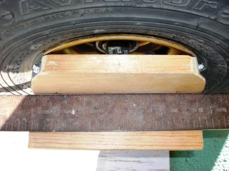

then holding the square against the back of the block measured the distance from the edge of the square to the front of the block. or more specific a spot on the block 5.725 inches from the back edge of the block. this measurement was chosen because of the ratio between the measurement and the angle.
[img]cid:58DC769DD86A4538A073F6536E007D5C(at)laptop1[/img]
if the measurement from the square to the tick mark on the front (left) side of the block was .052 inches the angle is determined by moving the dismal 1 space to the right. or .52 deg (I learned this nice little association with the distance from the square and tick mark at 5.725 inches and angle quite by accident while playing with a spread sheet,) and it will only work while the angles are very small.
the tangent of the angle = the measurement of the opposite side divided by the adjacent side. but we know the opposite and adjacent, we use the inverse tangent function. the inverse tangent function = the ratio .052/5.725 or TAN-1 power is .52 deg Toe In.
I measured the distance using a caliper depth indicator, on the back of the block it measured 1.5 inches, or the width of the square, and the left side measured at the tick mark 1.552 for the difference of .052 inch.
to measure the camber, place the wood block vertical, and hold the square on the floor and against the block going vertical.

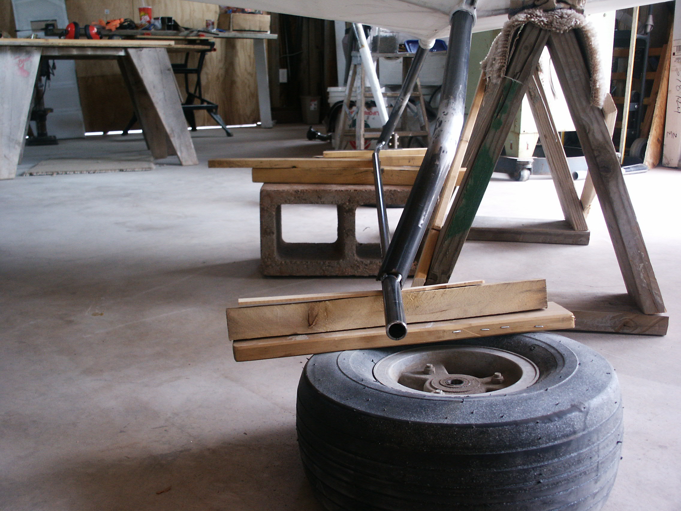

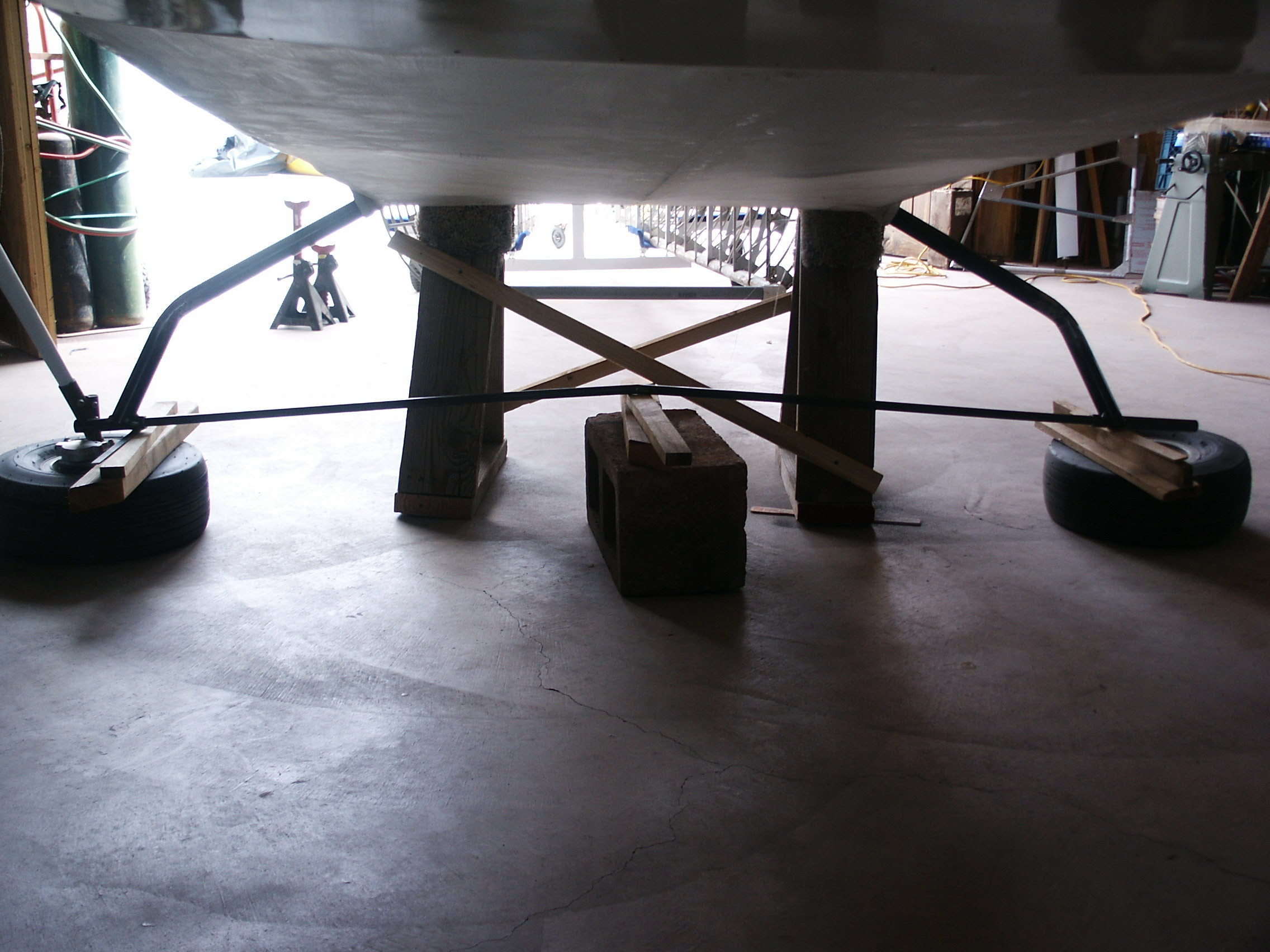

  When setting up my gear legs, I used a nylon string, rather than a chalkline.  I set a very heavy weight
on each end, after I found the centerline of the plane with a plumb bob.  However, later, I found this
isn't really necessary to have a centerline.
  Here's why;  If you slide two 5/8"tubes (like chromoly tubing) EXACTLY the same amount, into the axle
sleeves, they will meet at the exact center of the fuselage (assuming the fuselage is square).  By eyeballing
between the two tubes, you can mark a spot that is dead-nuts straight between the two gear legs.  You can see
this in my second photo (except my axles are twisted forward for toe out).  The cinderblock/wood shims show
how I came up with the positive camber, because you also see where the fuselage is shimmed to be level.
Using my digital level showed the tubes were raised 3 degrees up from pure level.
  In the second photo, you can see how I came up with 1) the tow out, and 2) the positive camber.  Once
I was satisfied with the chromoloy tubing being perfect, I tack welded them in place.  Next, I cut off the excess
tubing, and took them to my welder buddy to TIG weld them.
  All this talk about toe out, tow in, etc. was mostly after I set the tow out on my axles.  However, the
concensus seems to be I would have been better off with a slight toe in, rather than the tow out I did.
  For setting toe in or out, I find it easier to slide the 5/8" tubes through the axle sleeves (to the exact midpoint),
mark them for zero, (straight line between axles), and twist the axles for adjusting toe in/out.
  Yes, this DOES affect the camber a little twisting the axle, but not enough to change it much.
  Rather than using trigonometry like Boyd did, I did it a little different.  I'll use example numbers;  let's say the
tape measure gap between the axle sleeves is 80".  Because I have a tiny bit of camber, this causes the distance
to increase a small amount, when using two tubes.  I mark each chromoly tube exactly 40", and slide them in
the axle sleeves.  The marks are about 1/4" each inside the sleeve.  I can eyeball the 1/4" each side to insure
the tubes are equal!!  By definition, they meet at the plane's centerline!!
  Mark a spot on something that helps support the two tubes (like my cinderblock/wood support), at a point
that is straight (zero toe).
  Here is my math;  let's say the axle is actually rotating from 2 3/4" from the tube marks.  This adds up to
40" + 1/4" gap + 2 3/4" = 43"  So, we have 43" from axle pivot point to the centerline of the plane.
The circumference of a circle pi x D, where 'D' is 86"  (2 x 43").    3.14 x 86" = 270.04 inches.  I know
a circle has 360 degrees, so I divide 270 by 360, which equals .75".  Therefore, if I want to adjust those
gear legs, I know every 3/4" I rotate the axle equals 1 degree.
  In the final product, my gear legs ended up being 2 1/2 degrees positve camber, which I really like,
and 1.25 degrees toe out.  I'm willing to listen to arguments recommending toe in, tho.
  Very easy way to set the gear legs.  Anybody care to recommend the EXACT toe in they find that works
the best on a MkIII?

[img]cid:672C4DF11F604DEE89B8689A5D47EDC0(at)laptop1[/img]
OK no trig necessary now that i have done the homework.
slide the square in till it touches at the red arrow, the square is 1.5 inches wide. so the measurement should be 1.5 at the red arrow. now measure at a point on the block 5.725 inches from the red arrow (the white line),, this is the sweet spot in doing the trig that eliminates having to do it. i measured from the near side of the square to the block at the black arrow, it was 1.552 inches.. subtracting the 1.5 for the width of the square, i ended up with .052 inches between the black arrows. now for the easy part. take .052 X 10 and the answer .52 that is the angle of "toe in" in degrees. if the measurement between the black arrows was .0625 inches... the angle in degrees would be .0652 X 10 or .652 deg. easy
now for the best angle for toe in on a mkiii.... i have with 15 psi in my tires been at 1.7 total lfor both wheels... 1.48 at both wheels and the plane would dart arround,, example if i started going left. i would get more pressure on the right wheel and it would force the plane harder left. low air pressure it seemed ok. at 0 deg toe in i was riding a jackhammer down the runway at speed.. at 1.2 deg it rolled very smooth with very little input to keep it straight at 50 mph,, and only a tiny shake when breaking,, and only on 1 wheel so with my gear 1.25 toe in may be perfect if you have the alum gear your numbers may be different bacause of the stiffiness of the gear will be different.
boyd young

Here are the two pictures I took while setting up my gear legs.

it is maybe hard to tell because of the angle,,, where the 2 pipes join at the center, shimed on the block (second piucture),,, it looks like the joint is forward of the axels fittings.. which will give you toe out. but as i remember you said you have toe out,,, so that makes sense.
that is the meatiod i used for the first set of gear, the factory aluminum.. the gear i have now is 1 piece, and there is nothing to put a pipe through,,, and because of the break attach plate, i had to build an offset then try and run a pipe accross the offsets,, it was kind of hard to keep all the pieces lined up.
