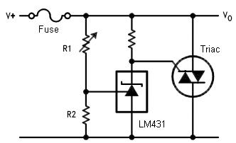

I did find some other interesting devices that could be used in an O.V. protection circuit.
http://www.fairchildsemi.com/ds/LM/LM431B.pdf used in this circuit:
http://en.wikipedia.org/wiki/File:Crowbar_Circuit.jpg
[img]cid:.0[/img]
This is a very rudimentary crowbar ov protection circuit.
It has no provisions for time-delay from onset of
ov condition. The LM431 is an integrated circuit
voltage regulator that can function as a zener
or, as shown above, a comparator. Further,
by adding a couple of resistors, you can calibrate
its switching point.
Out of the box calibration point for the
LM431 is 2.5 volts. So if you're wanting a
16.3 trip point, you can put 2.49K, 1% in
R2 and 13.7K, 1% in R1. You'd need a capacitor
across R2 to establish the cited time delay.
The problem to anticipate is setting a value
for the resistor from Gate to T1 of the triac.
For best noise immunity, it needs to be low,
like 10 ohms or so. Since the LM431 can't
deliver the high current pulse offered by
the legacy avalanche techniques, you may find
that optimum resistance for a good trigger
performance is too high for noise immunity.
When I run out of MBS4991, and assuming I'm
still offering crowbar ov modules, I'll look
at a variation using the LM431.
And here is a 16.1 volt zener diode that might work in your circuit without voltage dividing resisters:
http://www.mouser.com/Search/ProductDetail.aspx?R=NZX16B,133virtualkey66800000virtualkey771-NZX16B,133
If you can get it to hold tolerance over temperature
range. It's probably a 5% device to start with.
If you hung it from gate to ground, you'd have
to ADD the trigger voltage to the zener value to
deduce the trip point. Both gate and zener
voltage wobble with temperature pretty bad.
The schematic shown above (as modified) is
probably the best experiment to explore.
It might be fun playing around with some of these components.
Sure . . .
On the other hand, it is hard to beat the proven circuit that you have provided.
The 'proven' circuits HAVE been field tested over
decades of experience and thousands of delivered
products. But virtually all received some degree
of optimization early in their service histories.
The solid state crowbar system proved a practical
for replacing electro-mechanical relays.
But history has repeatedly demonstrated that every
idea is subject to assault from new technologies,
processes and design goals.
Suggest you brass-board your experiments and give
them a try on the bench. You can do some pretty
good tests on effects of temperature using
your freezer.
