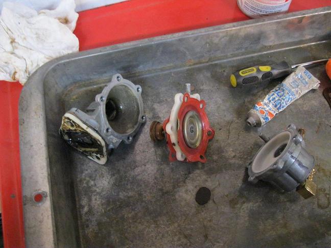

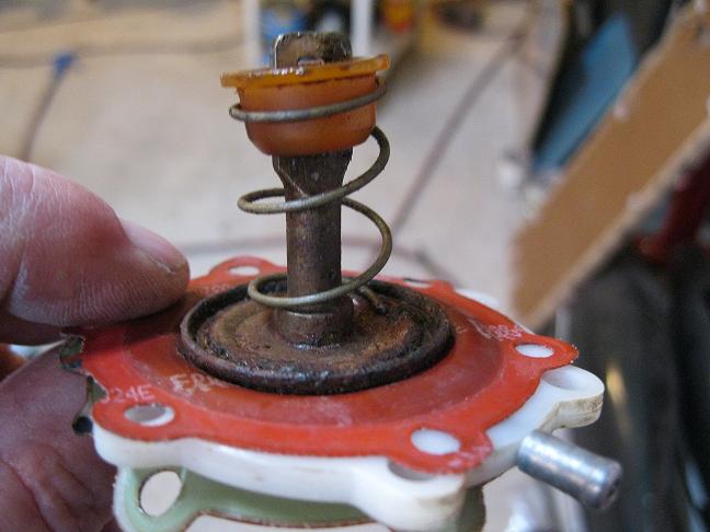

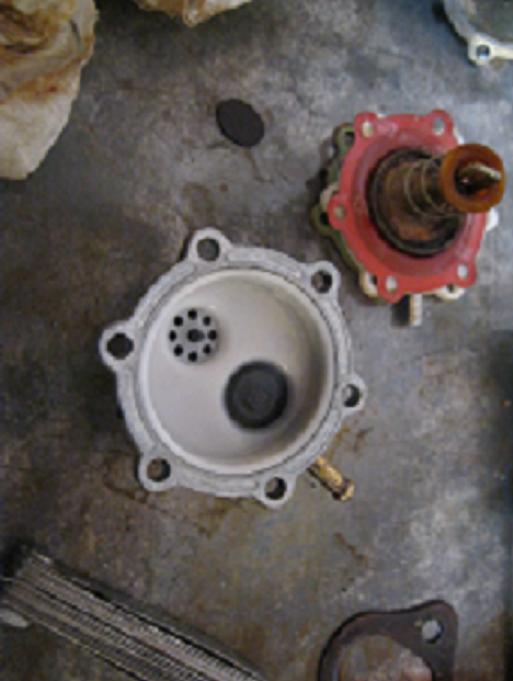

As you all know I had the problem with the float needle too and after replacing the needle had the same problem...after 3 successful forced landings in 3 weeks,we finally fixed it today...I'm not so sure it was even the float needle to start with...today I got a fuel pressure reading and it was putting out 7 lbs of pressure ! Disconnected the mechanical pump and ran it on the electric pump that was putting out 2-3.2 lbs and it ran perfect ! I removed the mechanical pump,placed an extra .030 gasket between the pump and the engine and the fuel pressure went from 7 lbs to 3.2 and stayed right there and ran great...
Why it started pumping so much more gas I have no idea...

Very glad to hear you found the actual problem. It IS a mystery as to why it changed over time.
A couple questions:
1- Had you done any fuel pump maintenance before this happened? What is the total gasket thickness now?
2- Are your electric and mechanical fuel pumps in series or parallel?
3- Do you normally run the electric during all phases of flight?
FWIW, my electric pump is plumbed in parallel with the mechanical and I use the electric to fill the float bowl before starting and during approach and take-off. I know the Facet is a 100% duty cycle pump which could be run full time but it is an old habit of mine not to use it except as stated.
Also, I've never removed my fuel pump so don't know how much gasket is there and I don't have a fuel pressure gage installed so don't know what it is producing. I think I'll ckeck it out during next condition inspection.

Ok...Chapter 14....I thought I had the problem solved ,then I flew it today...stayed over the airport for about 10 minutes and it seemed to run fine...headed out over the lake,throttled down to loose some altitude and it started all over again...I headed back to the airport and it sounded like it was going to quit again...I kept the throttle wide open and luckily it started to clear out and kept running....land ... Called Pete at Jabiru ,told him about spacing the pump out .030 and it seemed to be ok....his thought now was the spring in the pump needed replacing...I removed the spring...took about 7/16 off the spring put it back on the plane with a fuel pressure Gage and at idle I had 1.7 and it went to almost 3lbs wide open....when I GET THE NEW SPRING ,i WILL PUT IT IN AND TAKE ANOTHER pressure reading....
stay tuned...

Our theory on the spring is this....as the spring gets rusty from condensation it gets more brittle and harder thusly,making more pressure as it pushes the fuel into the carb...cutting it off,making it shorter also made the spring weaker and reducing the pressure...you think ???When I get the new spring ,I am going to rust proof it just for the heck of it then re-install it and take another pressure reading....

seems that springs loose tension after time.... I am puzzled on how you would get an increase of pressure.... is there any chance at a reduced power setting there is a vibration that is putting enough bubbles in the float bowl that the float wont sense the correct level?

Hi Jabbernuts !
Did anyone here know there are 2 different springs?? The silver one is the one we are supposed to have ..it puts out 2-3 lbs....the gold spring puts out 7 lbs....and some of the engines "got out" with the gold springs.....Imagine that.....Mine was to rusted to see what color ( seee picture) even after we cleaned it up...

PostPosted: Wed Jan 12, 2011 5:21 pm    Post subject: Re: Kolb/Jabiru carb overflow Reply with quote
sorry...forgot the pictures...
chris ambrose

Chris- looks like condensation from somewhere.

PostPosted: Wed Jan 12, 2011 6:09 pm    Post subject: Kolb/Jabiru carb overflow Reply with quote
Wow..."got out"....we used to call that an "escapement " in the DoD universe. Sounds like you are very close to getting back to a highly reliable powerplant!

PostPosted: Wed Jan 12, 2011 8:42 pm    Post subject: Re: Kolb/Jabiru carb overflow Reply with quote
"Wow..."got out"....we used to call that an "escapement " in the DoD universe. Sounds like you are very close to getting back to a highly reliable powerplant! "
This really has been a very reliable engine and other than this,I could be happier with this engine ! It should be all better next week....then look out for the new videos !!! lol
