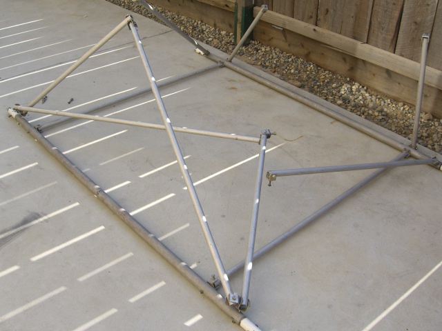

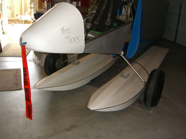

Thanx Steve...
These are the floats I sent you a picture of awhile back...
I had received this information from a Kitfox owner, "5 to 6 degrees (nose up) between the fuselage leveling line and the top of the float. I used the door frame on the kitfox....you need to know where the fuselage is level. This will make your floats slightly nose down when you are in flight, which is OK. I do know that if you don't have at least this much difference, you won't be able to get up on the step. Don't get carried away with this, because your tail will drag in the water when you try to climb up on the step. 5 to 6 degrees is the number that works!
Step needs to be 4 to 6 inches AFT of your MAX AFT CG, so that you can rotate around it, otherwise you can't get the nose up to takeoff position
.", and I thought I'd use that as a starting point...
There's not a lot of information out there on proper float placement...
The floats are new, but I think the rigging is for a two-place Quicksilver, so it's all "by gosh, by golly" at this stage of the game...
Thanx again...
