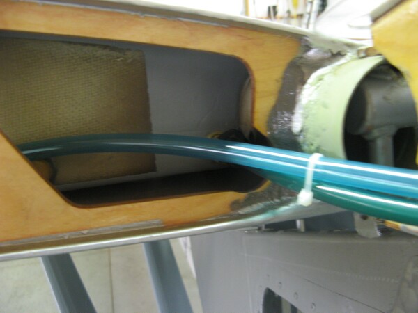

Kirk, my kit came with a straight fitting to attach to the finger strainer. The manual says to notch the rib to clear the fitting and fuel line. You will probably have to notch the butt rib also. picture attached.

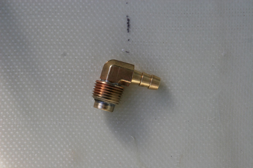

Interesting problem and parallels ours exactly. I am helping a friend finish a previously started Model V with the center wing tank ports. The previous builder had done some interesting things, which included an electric fuel gauge which required, at least in his mind covering most of the first rib with thin plywood which seriously limits access. He then mounted a half inch bushing which he glued into the tank, then a 3/8" finger strainer with integral straight hose barb. There was no way to attach hose to the hose barb and fold the wings, or unfold them, for that matter.
What came of it is a polycarbonate doubler glued to the bottom fabric in the area of the outlet, then cutting the fabric and removing the threaded parts one by one and after some hairy moments finally got the large bushing out without damaging the tanks. I got the larger finger strainers and as you find, discovered that there is not the ideal elbow fitting out there in the real world. I did find a couple of 5/16" hose low profile elbows, but they were in 1/4" thread size and there was absolutely no room for another bushing. What I finally did is chuck the elbow in a lathe and cut off the threads, then chuck a 3/8" bushing in the lathe and bore a hole to math the thread free elbow and sweat solder them together. We now have a low profile elbow with threads that match the finger strainer. Thinking about it, I realize I will have to modify a wrench if we ever want to remove the hardware to check the finger strainer. Picture attached.
Let me know if I can help.
Lowell

My instructions called for making a notch in the rib which I did and
a straight 1/4 NPT fitting clears the rib perfectly, and screws right
into the 3/8 NPT finger strainer. About 980 hours on this setup, when
I decided to add front ports to the tanks (13 gallon original
Kitfox), which I did by building up the front area with fiberglas,
drilling and tapping to 3/8 NPT, and installing the usual finger
strainer and another straight fitting, albeit at a *slight* up-from-
horizontal angle to clear the rib in that area. Another 100 hours on
the combined 4-port system, and no problems.
