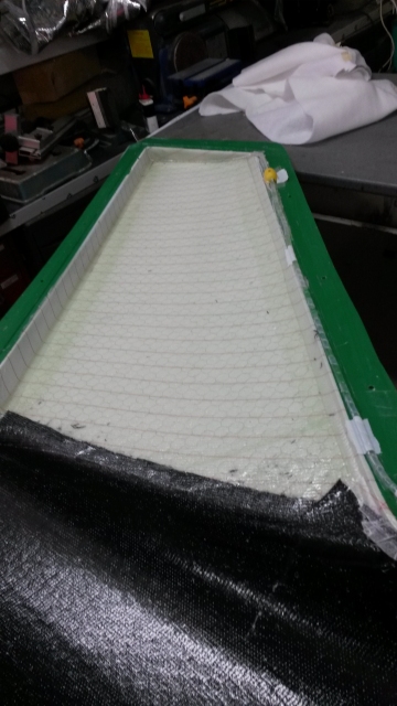

Hi all,
My buddy is starting a new ultralight project.
The airframe is carbon fiber (resin infusion) with glass fiber fin to
house a built-in VHF antenna.
On the attached picture of the rear half-fuselage, the glass fin can be
seen, with the carbon fiber tail cone at the base. A small number of
foam ribs will be added.

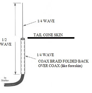

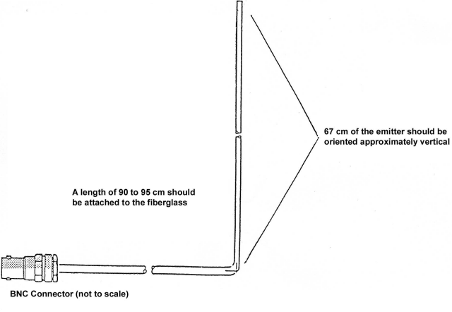

Since there is not enough room for a dipole, it seems that a quarter wave is required. Ideally there should be 4 ground plane radials using copper tape. If there is no access to the inside of the tail, then the ground plane radials could be glued to the exterior of the tail. If exterior radials are not desired due to cosmetic concerns, then only one radial could be placed horizontally in the vertical fin-tail cone junction. Not ideal, but might give adequate performance.
Here is a picture of another homemade option. It is very inexpensive using only coax. It should work good enough.

PostPosted: Thu Dec 21, 2017 8:25 am    Post subject: VHF antenna in the tail Reply with quote
At 12:14 AM 12/21/2017, you wrote:
As I recall, the characteristic impedance of a folded dipole is 200 ohms, so you would probably need a 1:4 balun to feed it from 50 ohm coax?
Bill
Actually, closer to 300 ohms. WAAaaayyy back when television
Yagis featuring folded driven elements were a close match
to 300-ohm twin-lead.
Antennas and airplanes just don't really play nicely
together . . . the most elegant solution is almost
always a compromise . . . a departure from that which
can be achieved in terrestrial environs.
Fortunately, VHF communications is (1) mostly short
range and (2) line of sight. Hence, a few watts of
transmitter and a wet string for an antenna will
generally put you in contact with the other station.
For the build in question, the goal is to get as
much of a 1/4 wave, vertically oriented radiator
supported on the leading edge of a composite vertical
fin . . . which MUST be glass/epoxy structure to
minimize RF attenuation.
Then, it would be NICE if we could put an 1/4 wave
radius ground plane around the base.
[img]cid:.0[/img]
Hmmmm . . . that would make for a funny looking airplane . . .
even the first level compromise of crafting a ground
plane from multiple radials is out of question.
Okay, compromise #3, a SINGLE 1/4 wave element that
extends back along the feedline toward the radio. Here's
one of dozens of examples in the DIY antenna crowd.
https://goo.gl/HXCBzh
This article is pretty close. The author stubs his
toe in assuming that the velocity factor of the 'bazooka'
section is the same as the velocity factor of the
coax used to fabricate the feedline and antenna.
In fact, velocity factor is a function of dielectric
characteristics between two conductors, in this case
center conductor and the surrounding shield. For
coax, the dielectric is some material designed
to hold the center conductor alignment while minimizing
losses.
It's true that the outer braid of the bazooka
does form a coaxial section over the
outer braid of the feed line . . . but with a
DIFFERENT dielectric which is not low
loss center conductor support but a robust outer
jacket of the coax that has nothing in common
with the RF characteristics of the inner
insulation. Hence the velocity factor of the
feed line has no relationship to the design
of the de-coupling sleeve.
This antenna can be installed in a glass/epoxy
airplane with the radiating element firmly
built into the vertical fin structure. The
feed line can be fitted with a de-coupling
'bazooka' . . . and essentially treated as
any other feed line.
I've got the test equipment necessary to tune
the de-coupling sleeve to accommodate the new
dielectric/conductor combination . . . but it
will probably be after the first of the year
before I'll be able to get to it.

gilles.thesee(at)free.fr
PostPosted: Thu Dec 21, 2017 4:24 pm    Post subject: VHF antenna in the tail Reply with quote
Hi all,
Thanks to all who responded.
Indeed the dipole is out of the question and we'll have to go the 1/4 wave route.
Most interesting.
Maybe this as something in common with the Becker 1A005 ?
http://www.beckerusa.com/Products/1a005-2/
Which we find too expensive at ~100 €.
[img]cid:part2.B5DF07BE.5DFF4BD7(at)free.fr[/img]
I'd be most interested in your findings in order to craft a bazooka for an acceptable VHF antenna in the tail fin.
Thanks again,
Best regards,
Gilles
http://contrails.free.fr
http://lapierre.skunkworks.free.fr

PostPosted: Fri Dec 22, 2017 4:27 pm    Post subject: VHF antenna in the tail Reply with quote
Hi all,
Thank you everyone who responded.
The project is a small airplane with the fin about 800 mm high (~950 mm leading edge), so space seems a bit limited for a dipole antenna.
Still looking into any solution.
The idea is to design something mostly DIY for cost reasons, so this seems to rule out off-the-shelf antennas.
Any ideas ?
BTW, what is the influence of the radiating element width/diameter vs selectivity or else ?
Any hard facts on the subject ?
Can you describe the physical configuration of
the vertical fin vis-a-vis the empennage? Is
the vertical fin detachable?
I presume the antenna, once installed, will
forever more be inaccessible for tweeking?
