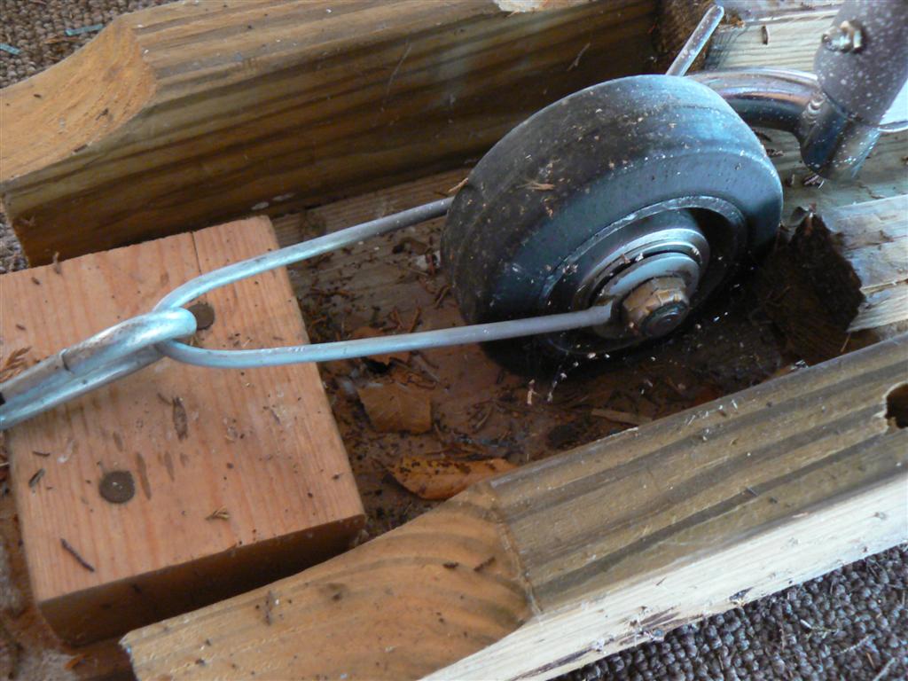

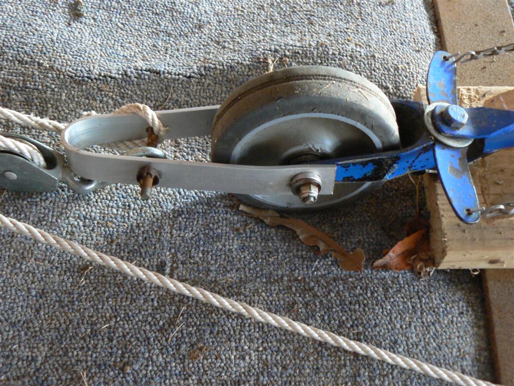

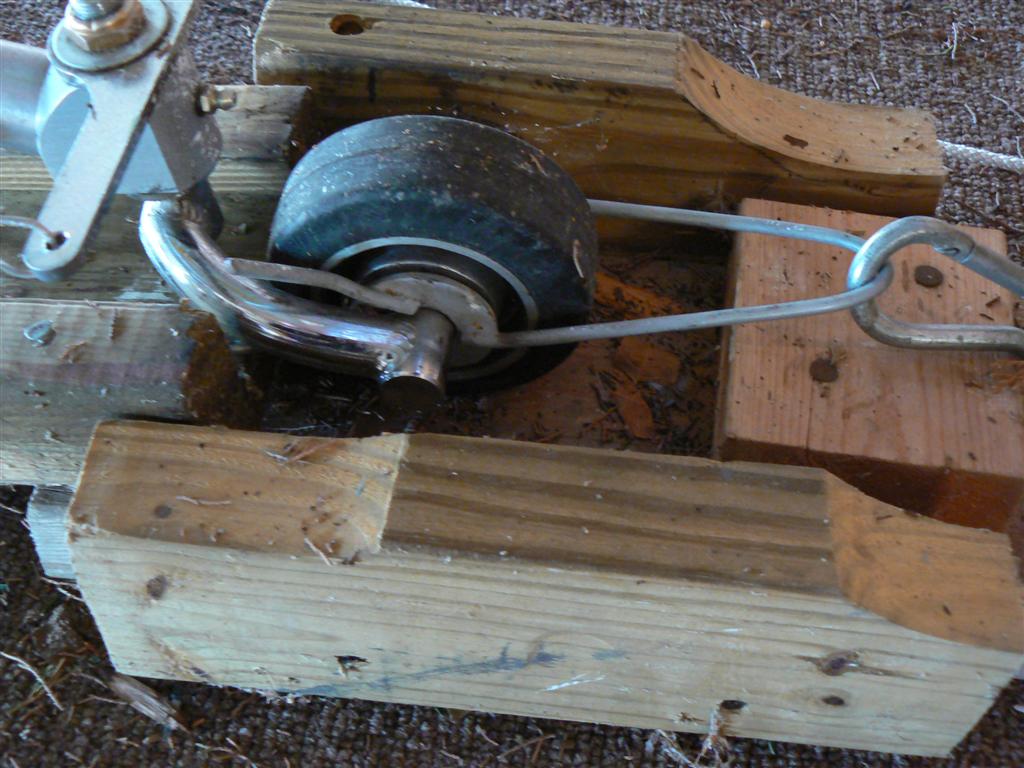

Took these this morning, the swivel tail wheel is on the FSII, the black and blue one (needs painting, huh?) is a Sorrell Hyperlight tail wheel on the MKIII. (The groove in the middle of the tire is because of a stone that got caught there and scored the solid rubber tire)
The yoke for the MKIII is just a bent piece of aluminum flat stock with a couple holes in it. It slips over axle extensions that protrude from either side of the tailwheel yoke, and is tightened or removed with a thumbscrew. So it is removable from the airplane.
The full swivel tailwheel on the FSII is the kind that Kolb sells, took two flat washers and welded a 3/16" bent rod to them to make the yoke extension, the washer on one side has two 3/16" rod extensions welded on to keep it from flopping up or down. It stays on the airplane.

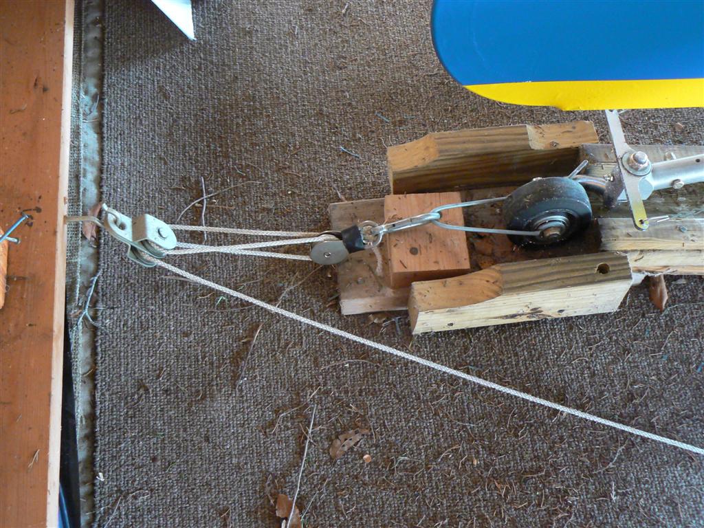

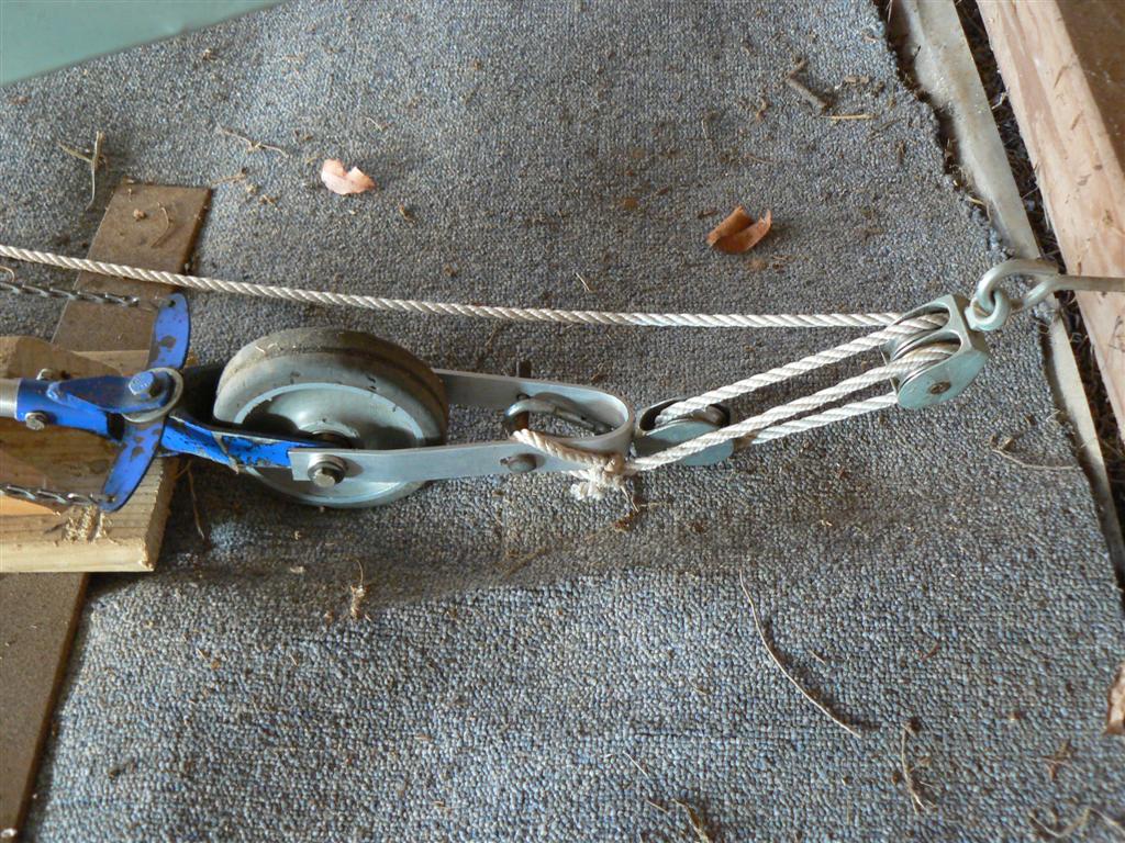

We have used this method for years to drag the airplanes up the hill into the hangar. I had to replace the tailwheel strut on the MKIII last year when it broke at the lower through bolt, but I seriously doubt that pulling the airplane into the hangar by the tailwheel was a factor.
Since this is a hangar situation and not a trailer situation, we are using 100' of nylon rope to pull with. Just pick up the loose end (which has a loop in it) stick a screwdriver through the loop, and start walking backwards. When the tailwheel drops over the lip at the end of the track, stop. And that lip on the track keeps it from rolling back out of the hangar.
