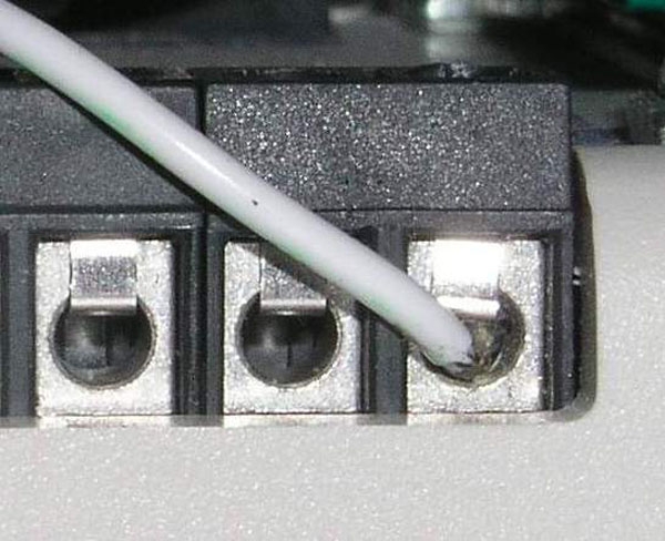

Just so we're all on the same page . . .
The twist-n-squash terminal strips featured in this
thread are probably the best there is for taking
wires to etched circuit boards with convenience,
minimum cost and reliability . . . UNDER CERTAIN
CONDITIONS. Here's one example of the technology:

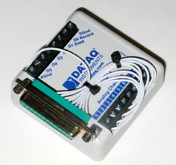

Here's one of my favorite $100 data acquisition modules that
uses the same terminal strip.
[img]cid:.1[/img]

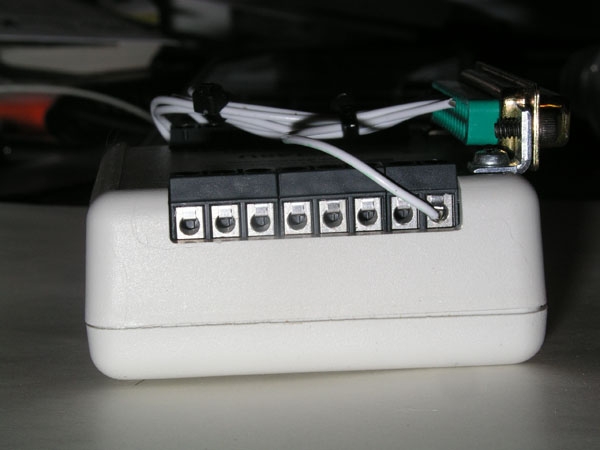

Note that the bared end of a wire is NOT captured by
a head of the mash-screw . . .
[img]cid:.2[/img]
But by the END of the mash-screw. Further, there is a buffer
strip between the wire strands and the end of the screw. If one
REALLY needs to use a twist-n-squash technology, this is one of
the best.

Without getting in too much of a dither about new design
goals, I think the best application of this process calls
for parallel strands of wire pressed into the lower
concave surface of the cavity with force from above
offered by the screw. Then supply bundle support within
a couple inches of the squash-joints.
Note that is NOT what I did on this particular example . . .
but then this DAM isn't expected to be in place and
functioning after what we hope is decades of otherwise
unattended service.

Robert L. Nuckolls, III wrote:
At 10:26 AM 2/2/2011, you wrote:
> Bob,
> Interesting. I plan to put a pair of P-Mags on the Lycoming for my
> Toot.
> Rather than bare wires under a screw, I'd think about crimping a
> suitably sized ring terminal onto the wire with proper shrink tube
> and placing the ring under the screw along with a lock washer.
> Others, please chime in if there's an error in my thinking as it's
> info I'll eventually need.
Emacs!
Emacs!
Emacs!
the best.
Legacy design goals for aviation (and other disciplines)
have adopted processes that offer gas-tightness in the
metallic joints of the current carrying pathway along
with wire support immediately adjacent to the gas-tight
joint that prevents failure of the wire under vibration.
unattended service.

The DataQ device has the SAME terminal strips. The
pictures showed how I reduced the inconvenience of
of those strips with a D-sub connection adaptation . . .
