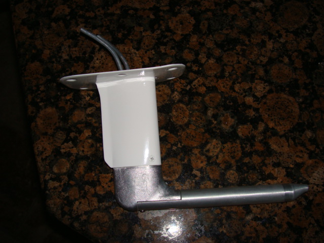

  Cutting off the probe is not possible.  I have a Dynon EFIS probe, with the
built-in AOA sensor port.  It is exactly like this one;
 http://www.dynonavionics.com/images/AOA_new_unheated.jpg
  I added my own extension, to get it down low enough to not
be affected by diverted air from the nosecone.  (see photo)
  Besides, I've already relocated it.

Hi Mike,
<< I added my own extension>>
Nice neat job.
