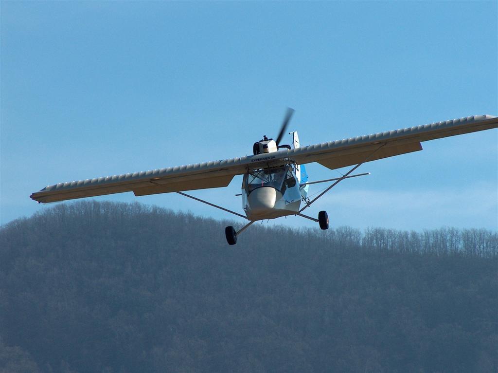

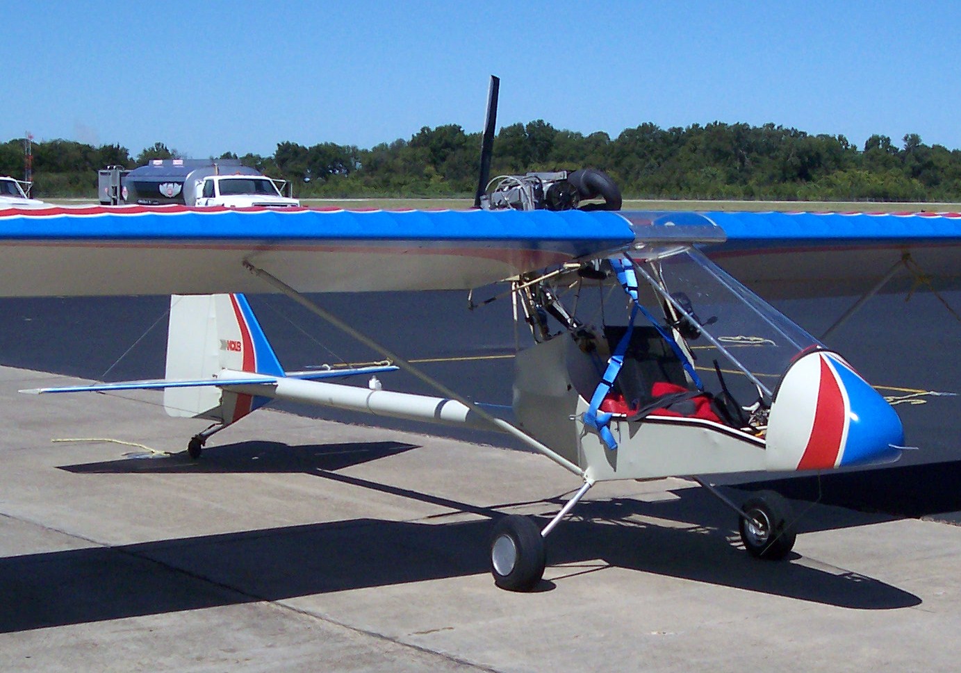

From this:
 Filesize:  286.27 KB
 Viewed:  10993 Time(s)
To this:
 Filesize:  1.12 MB

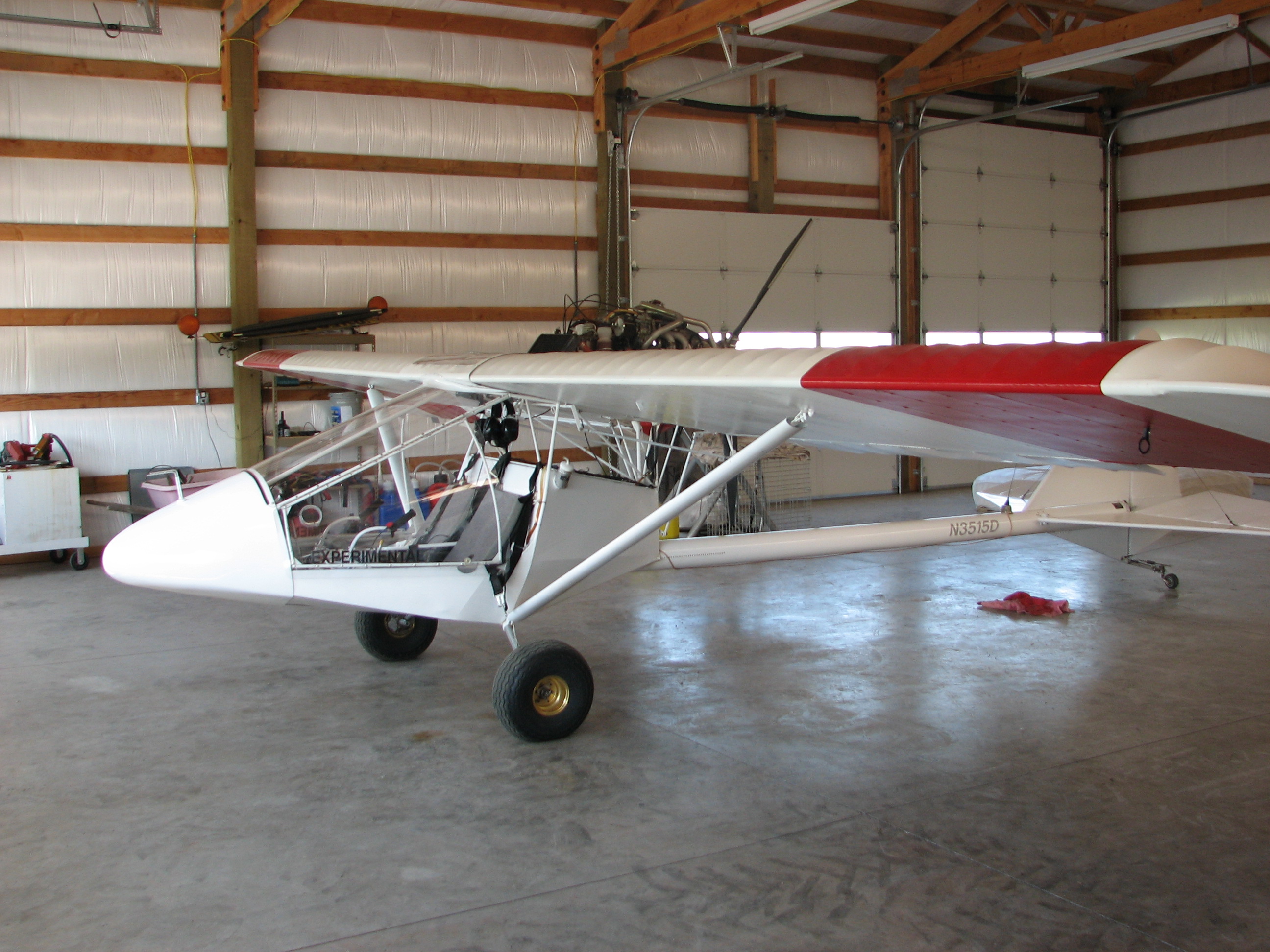

Having owned a MKIII since 1995 and having a FSII in the hangar next to me since 2005 (which I could fly whenever I wanted,) let me weigh in on this.
If you leave the aileron bellcrank which connects to the aileron pushrods the standard distance between the two pushrod bolt holes, then I would agree with you, and would also add that both of them require heavy stick forces to extract maximum agility.
If you reduce the distance between the bolt holes to improve your stick leverage on both airplanes, then the FSII simply becomes a lot less labor intensive to fly, and the MKIII becomes not only less labor intensive, but a lot more agile in the process. This might seem a bit counter-intuitive, nonetheless that is how it works, probably because none of us is likely to try and get serious agility out of an airplane when it seems like it takes "too much muscle" to do it.
Modified you have a situation where the FSII handles like a smaller sports car, and the MKIII like a well designed sports sedan with all the handling options. Plus room for sweet thing & a picnic lunch...
MKIII aileron mod: http://www.bcchapel.org/pages/0003/pg7.htm
FSII aileron mod: http://www.bcchapel.org/pages/0003/FSII%20ailerons.html
