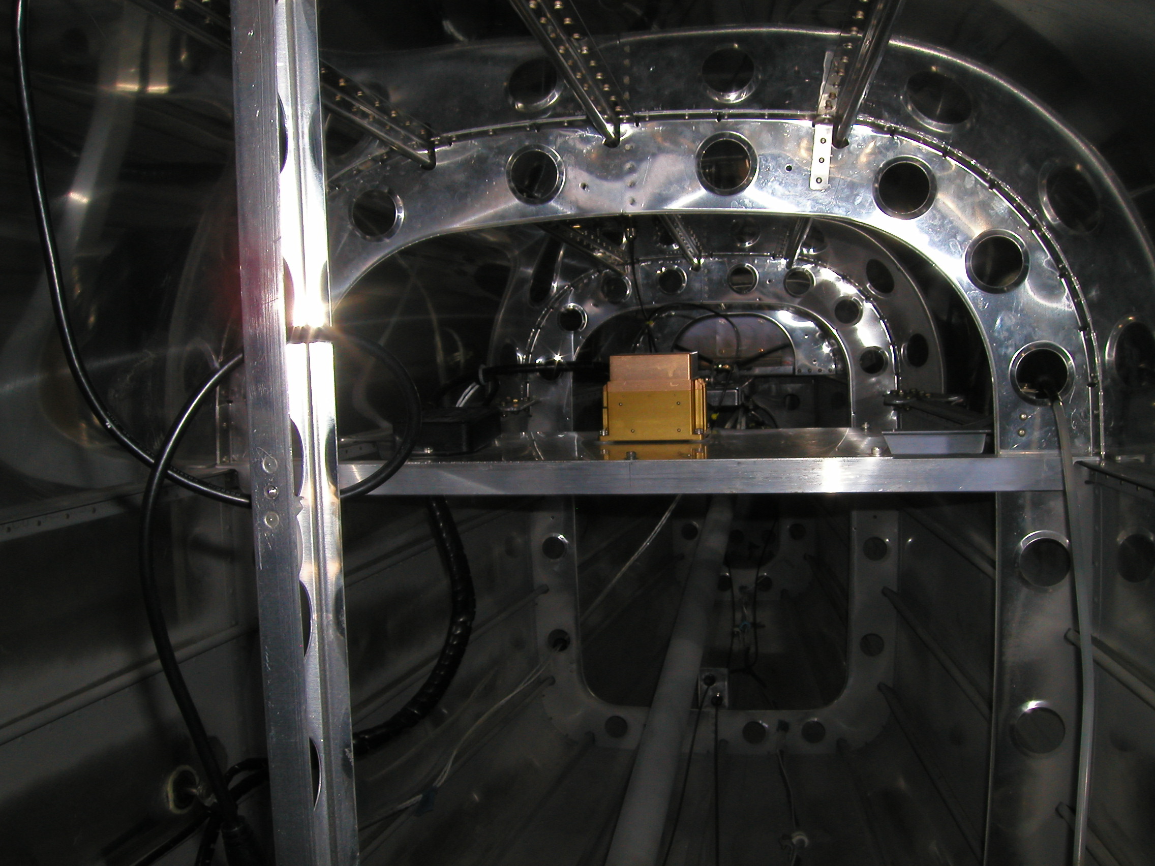

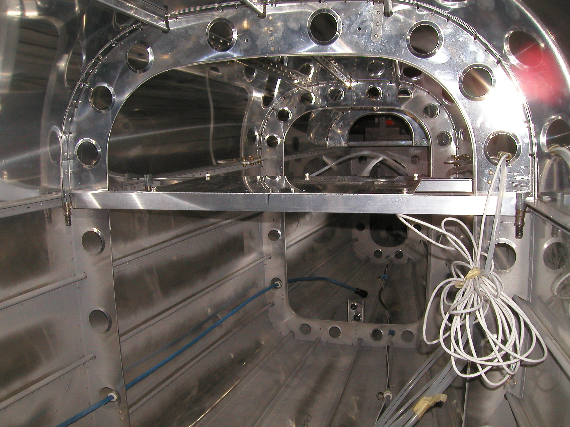

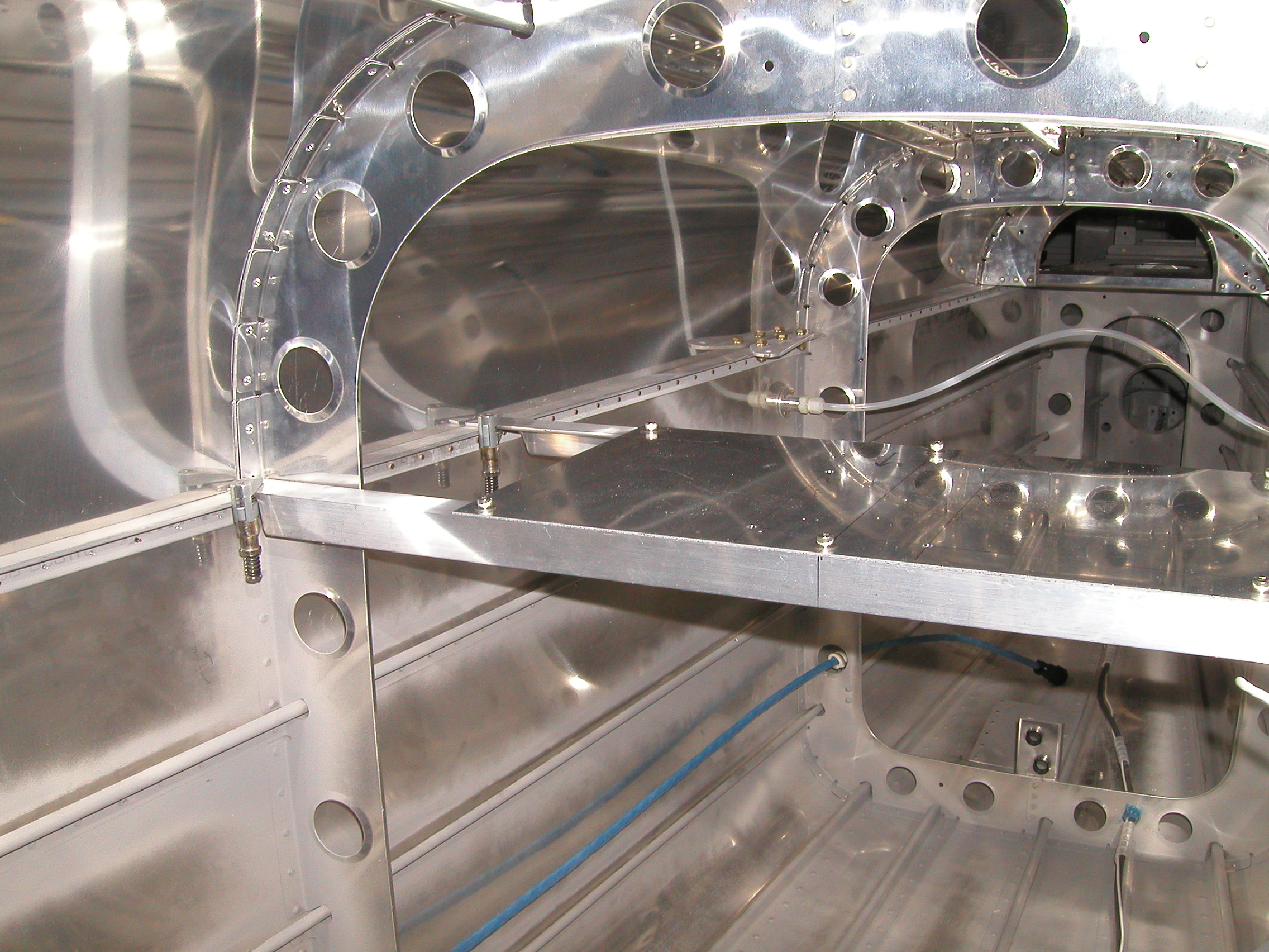

PostPosted: Mon Jan 31, 2011 8:56 am    Post subject: AHRS Mount angle Reply with quote
Since my install was in 2005 I established the plate on two angles across
the longeron and then ran a fish line from the aft center of the tail cone
to the front center of the tail cone. See before and after pictures
 Filesize:  889.17 KB
 Viewed:  6088 Time(s)
 Filesize:  843.23 KB
 Filesize:  740.08 KB
