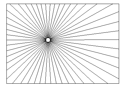

Not much . . . if any. Let's consider the way
a ground plane works. In an earlier post I
explained how the sum total of 4 'prefect'
radials routed 80% plus of energy delivered
to the end of the coax to be delivered to
the antenna.
Now, if you draw say 100 equally spaced lines
from the antenna location on your ground plane
out to the edge, we can see that the minimum 'radial'
length is on the order of 12". No single 12" radial
is very useful . . . but there's a lot of them.
The longest radial goes out to 2 or more corners.
They might be as short as 20' but perhaps longer
if the antenna is not directly centered on the sheet.
[img]cid:.0[/img]
Obviously, the ground plane is not "ideal". But
then lots of satisfactory antenna installations
were 'grounded' to small plates welded to the
structure of a rag-n-tube airplane. Terrible
radials.
Your ground plane sheet is blessed with a few
pretty good radials and lots of not so good
but the SUM TOTAL of their effects at the base
of the antenna is substantial . . . and probably
quite adequate.

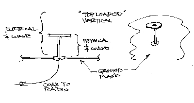

Antenna choice, revisit?
Cobham/Comant isn't very positive about bent whip antennas for Comm 1. They say "Bent whips may not provide the best VSWR because of proximity to the ground plane (aircraft skin), which can cause reflections, plus they lack overall height. Remember, VHF antennas “like” to be tall and straight for best operation." See FAQ #2.
Not true. It's the current flowing in about the bottom
20% of the antenna element that controls most of
an antenna's performance. In fact, it's common practice
to mechanically shorten an antenna with "capacity
hats" that act strongly in low current, high voltage
portion of the antenna element.
Bending the top of the antenna horizontal has little
effect on radiation pattern but will lower the frequency
of resonance.

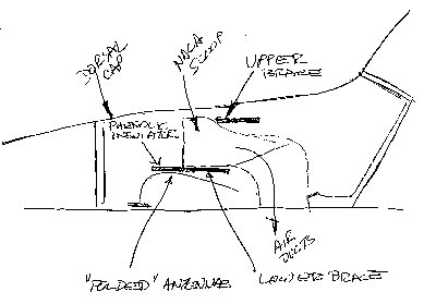

This discussion about ground planes has forced me to send another one of my way off subject messages! <G>
Some of you may be aware of the speed modifications that Mike Smith was selling for Bonanzas a few years ago. While Bonanzas are certainly NOT homebuilt aircraft, Mike's work was very much in the realm of what homebuilders do. He guaranteed a speed increase of at least ten knots on any Bonanza that used his full set of speed kits.
In his quest for speed, he took EVERYTHING off the top of the fuselage and as much off the belly as humanly possible. He even installed a VHF communication antenna in a fiberglass tail cone. It was horizontally oriented rather than vertical and the ground plane was no more than six inches by eight inches.
Did it work? Some folks found that it was a perfectly usable solution and are still using it regularly. Others have either eliminated it or added another stock antenna on the belly.
Personally, I have never flown a Bonanza that was equipped with the tail cone antenna, but I have personally spoken to a pilot who has flown his that way in heavy IFR operations for over twenty years. Just how good do antennas really NEED to be?
Mike also was a big exponent of using a set of VHF Navigation blades mounted as far back on the Bonanza fuselage as possible. The manufacturer of the antennas said they were way too close to the tail feathers to work properly. I have personally mounted several blade antennas in that position and they have all worked very well.
Just some data for further thought.
the antenna.
radials.
quite adequate.

Here's the ELT antennas on a Beechjet. Both
are installed under a fiberglas fairing just
forward of the vertical fin.
[img]cid:.1[/img]
The 121.5 antenna had to be folded over under the
fiberglas to clear some ductwork. This distortion
caused the ELT to go into "hi SWR shutdown".
[img]cid:.2[/img]
I made the suggestion that we build a top-hat
loaded vertical that could be tuned for that
location and wouldn't have to be bent over under
the fairing.
Certification time-line issues shot that idea down.
