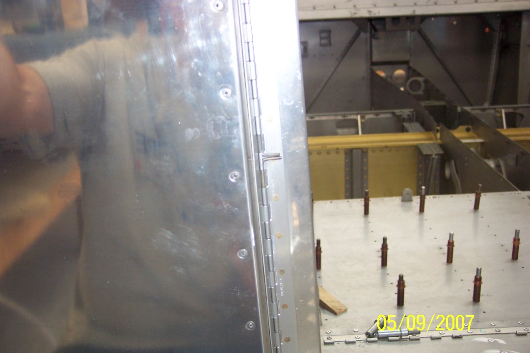

PostPosted: Wed Jan 26, 2011 5:44 pm    Post subject: Baggage Door Removal Reply with quote
Simple solution to build as plans intend and still remove the door with no effort. Very common in the RV world.
Photo attached,
Robin

PostPosted: Thu Jan 27, 2011 3:03 pm    Post subject: Baggage Door Removal Reply with quote
Many thanks Robin, that has concreted my thoughts.
I now have very little aluminium work left and have installed the cabin and now I'm on to the doors. I might install the landing gear and engine mount to lower the fuselage for easier access.
There is now a three month lead time on engine and instruments, bugger!
Many thanks once again my friend, your input is invaluable.
Kind regards, Pat
