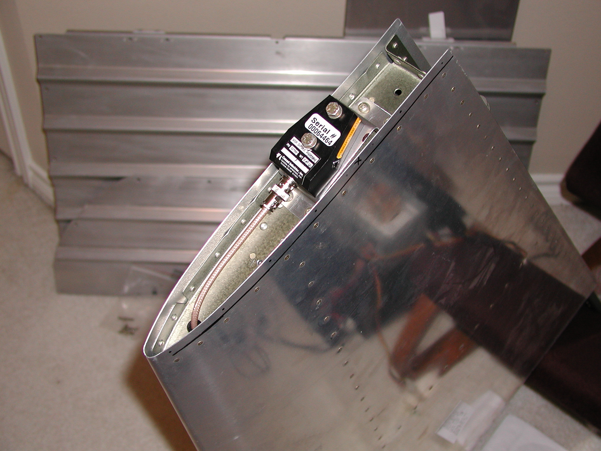

recapen(at)earthlink.net
PostPosted: Wed Jan 26, 2011 2:27 pm    Post subject: NAV/COM/GS Antenna Reply with quote

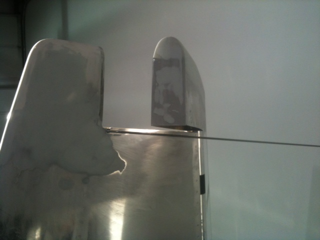

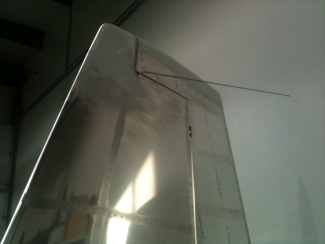

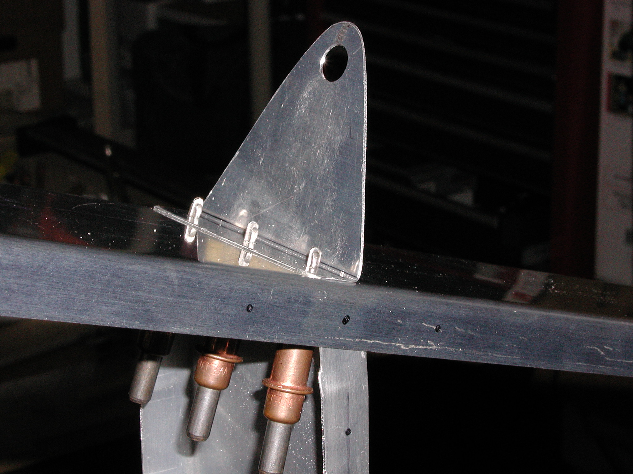

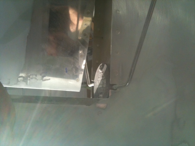

I have a comant CI-182 installed on my VS under the fiberglass fairing on my RV6A. I don't know if you can still get one - and how the counterweights will affect the installation.
Hope these tell enough of the story.

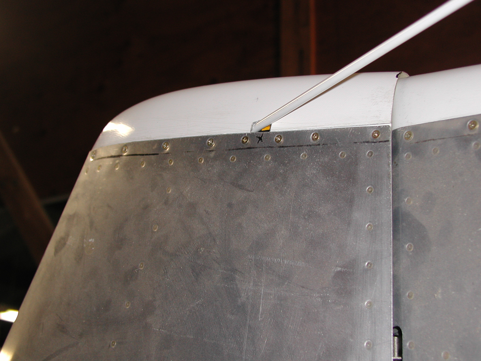

PostPosted: Wed Jan 26, 2011 6:08 pm    Post subject: Re: NAV/COM/GS Antenna Reply with quote

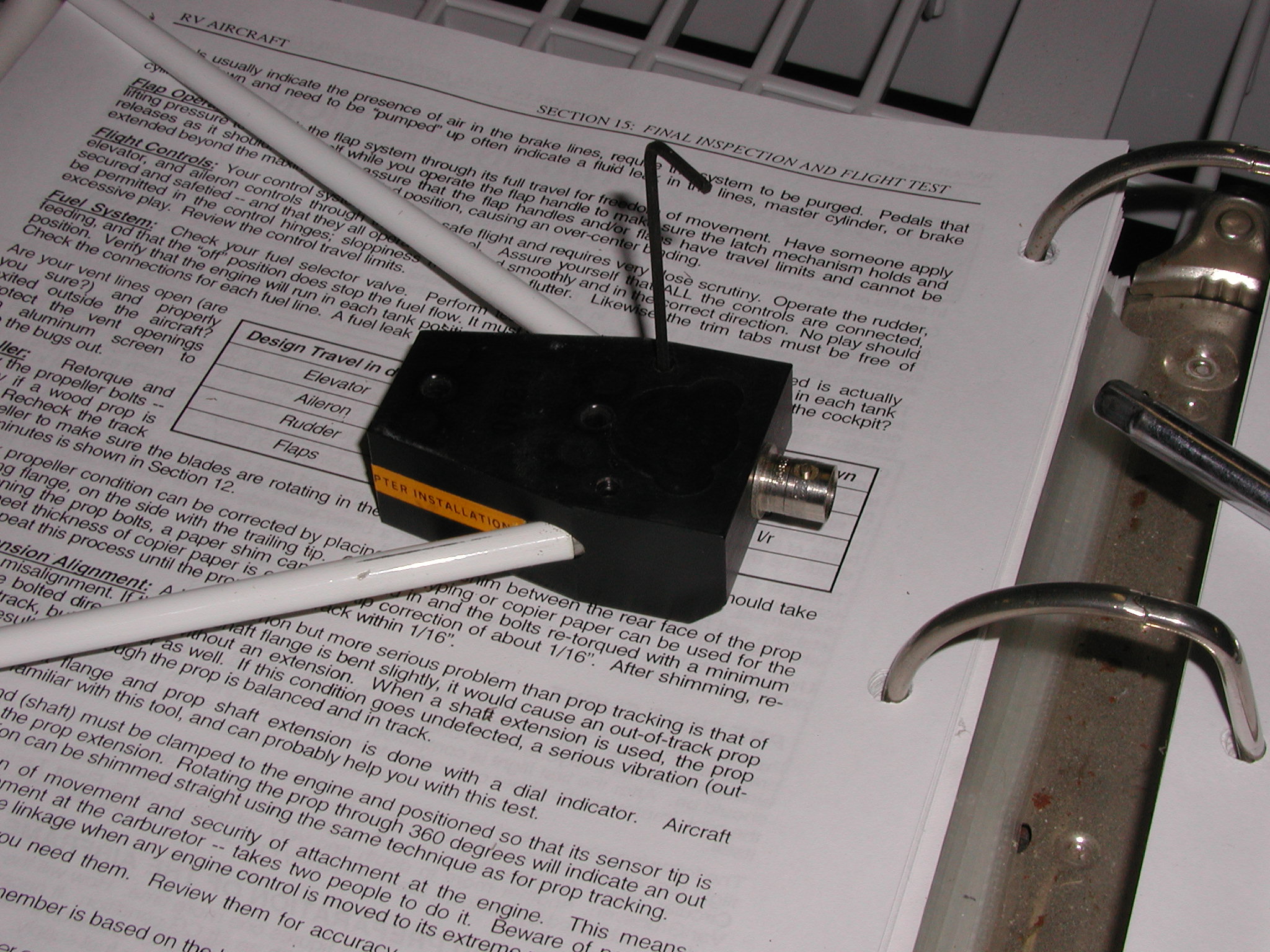

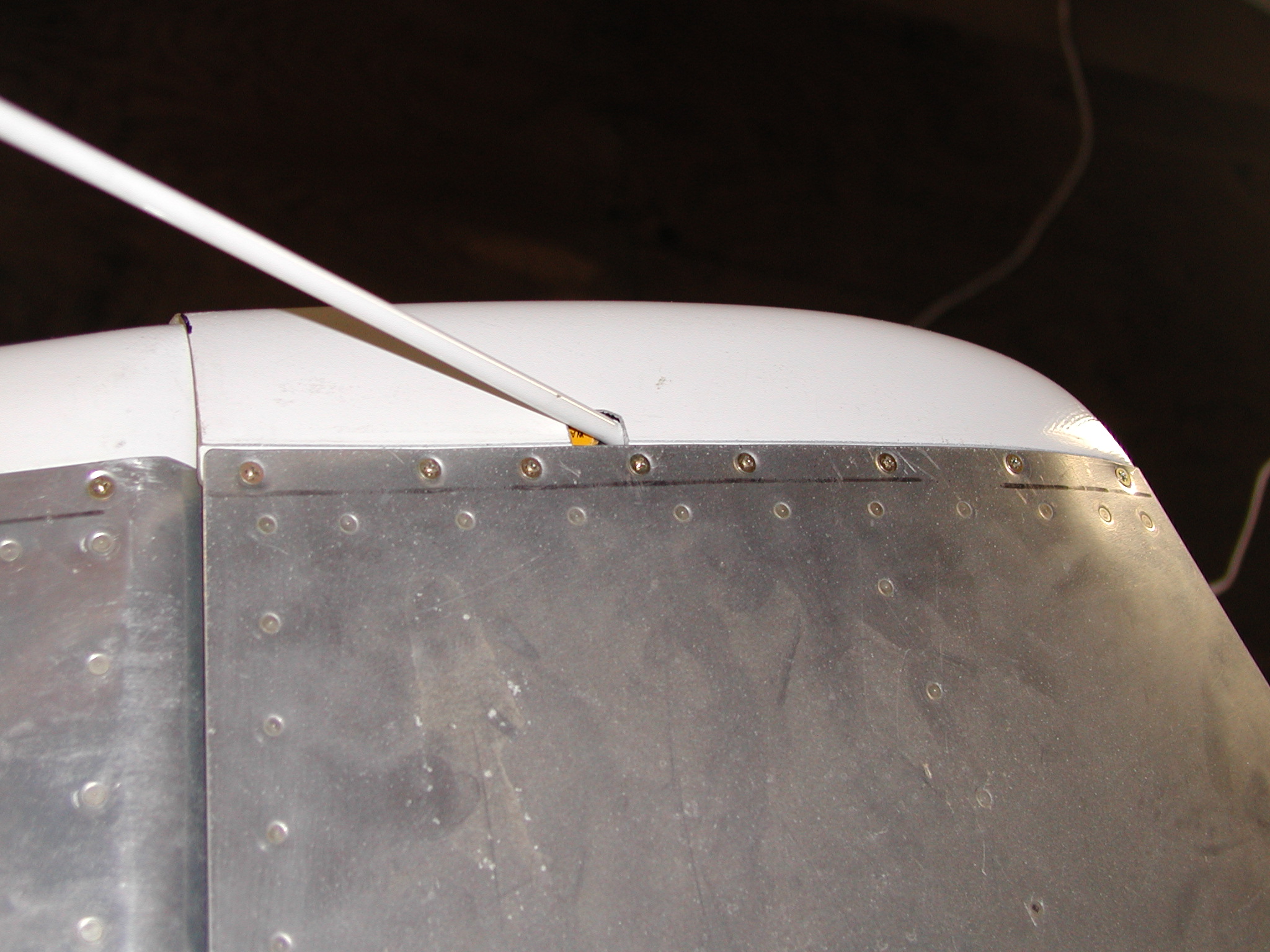

Here are some pics of my install. I just made a plate with nutplates and blind riveted it on the top of the VS rib and sealed with proseal. I cut it to drop the plate in and cleared a spot for the nutplates. No interference problems with the whiskers and no extra fiberglass work.
