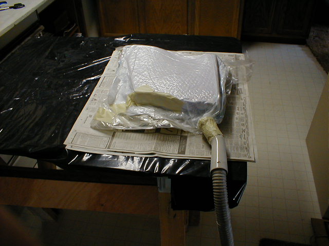

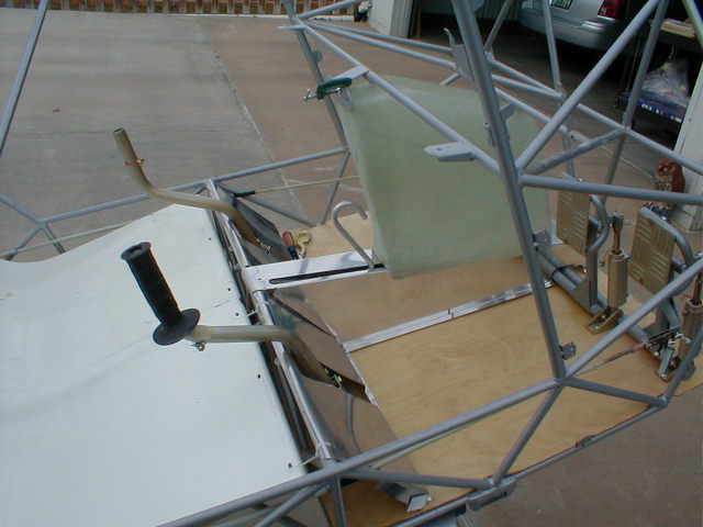

I made a narrow console for my plane (M-IV). It mounts to the panel
at the throttle holes and to the Al bottom where the flap handle slot is.
Anyway the method I used is a layup over a plug mold and vac bag I
used hardware store styrofoam for the plug and fabric store poly knit
for the resin absorber. I covered the plug with stretchy plastic to
make it easier to remove, but gasoline will disolve the foam and work
just as well. The vac pump was a small household vacuum that was
laying around in my shop.It took 2 tries because the first one was
not narrow enough and my legs felt confined. The vac was left on for
24 hours and I did not do a heat cure (probably a mistake). The rule
is cure to above the temp the product will see in use.

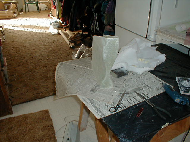

In the pics you see the final glass shell with no filler. The filler
could be applied and sanded smooth. The absorber is poly fabric from
the fabric store and results in a very brissilly surface to allow
great adhesion for more glass or a textured finish. Others probably
would like the finish obtained with filler and paint for a gloosy
finish. Mine will be lightly sanded and a coat rattle can
undercoading and it leaves an orange peal texture on smooth surfaces.
Black only.
I use the epoxy pump system with a proper beam scale I made and
West epoxy with no filler and applied it with a squeege. Turns out
the scale is not needed because the pumps do it exact. Glass cloth
was BID I had laying around from a Longez practice kit. Pretty light
weight cloth. I used 2 payers with a cross ply orientation. The whole
project took 2 days, but the actual work effort was ony a few hours
for each try.

PostPosted: Mon Jan 24, 2011 10:03 am    Post subject: My Composite console Reply with quote
Nice place to do a wet layup with bagging

Hardware store styrofoam, fabric store poly knit, household vacuum cleaner, rattle can undercoating, homemade beam scale--and all done in the kitchen. Man, I like the way you think Paul!
