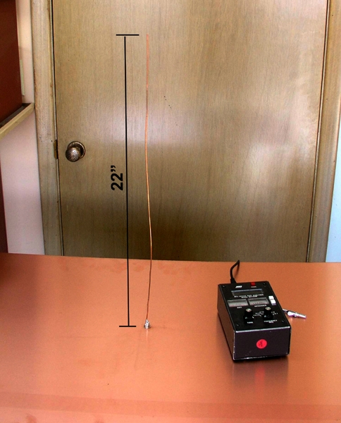

Just went to the bench and fabricated this test
article.
[img]cid:.0[/img]
It's 22" of 12AWG copper soldered to a BNC chassis connector
mounted to approximate center of a copper sheet 24 x 36
inches.

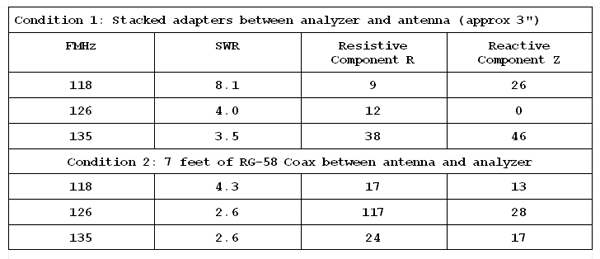

The investigative instrument of choice is the MFJ-259
antenna analyzer. Here is a chart of measurement results:
[img]cid:.1[/img]
A fine wire, 1/4 wave radiator has a resonance base impedance that
is quite low. As you can see, at 126 MHz and minimized feedline,
the reactive component of this antenna went down to 0 ohms (resonance)
and the resistive component was about 12 ohms. Hmmm . . . 12/50
explains the 4:1 SWR reading that was observed. So in terms of best
performance (resonance) this antenna is rather crippled for accepting
all the power that a 50 ohm feedline has to offer.
At the extreme ends of the comm band, the reactive and resistive
components did their expected hat dances with SWR readings that
never got better than about 3:1 at any frequency.
Okay, let's put a piece of "test coax" between the antenna and
instrument. SWR figures got better over the range of interest although
resistive and reactive components became a bit more agitated.
This is because of the effects of frequency on a mismatched
piece of coax can be profound in terms of what is viewed
looking into the same end as your transceiver. We take advantage
of these "transforming" effects offered by mis-matched transmission
lines but in the case before us, there's no particular advantage
to be gained. The question to be answered is "how much practical
difference does it make?"
Interestingly enough, the longer a transmission line, the
BETTER things get. This is because of losses in the line.
You can hook your transponder to one end of a 1000' spool
of the best coax out there and it wouldn't know if the
other end was open, shorted, or had a good antenna on it.
Even if there WAS a good antenna on it, no practical amount
of energy would even reach it due to transmission line
losses.

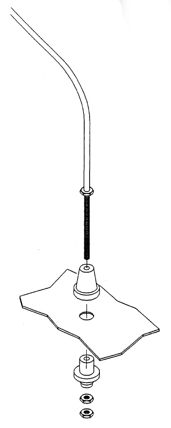

Finally, keep in mind that Cessna and others fitted their
products with antennas that looked a lot like this:
[img]cid:.2[/img]
Tens of thousands of antennas went out the factory
doors with this or similar configuration. This was
in a time when radios were MUCH less capable in terms
of sensitivity and signal/noise ratio of modern
avionics.
The upshot is that it's more important to BE CONNECTED
to what ever antenna you have than it is to massage
measured or perceived performance. No antenna is bad,
any antenna is probably good.
