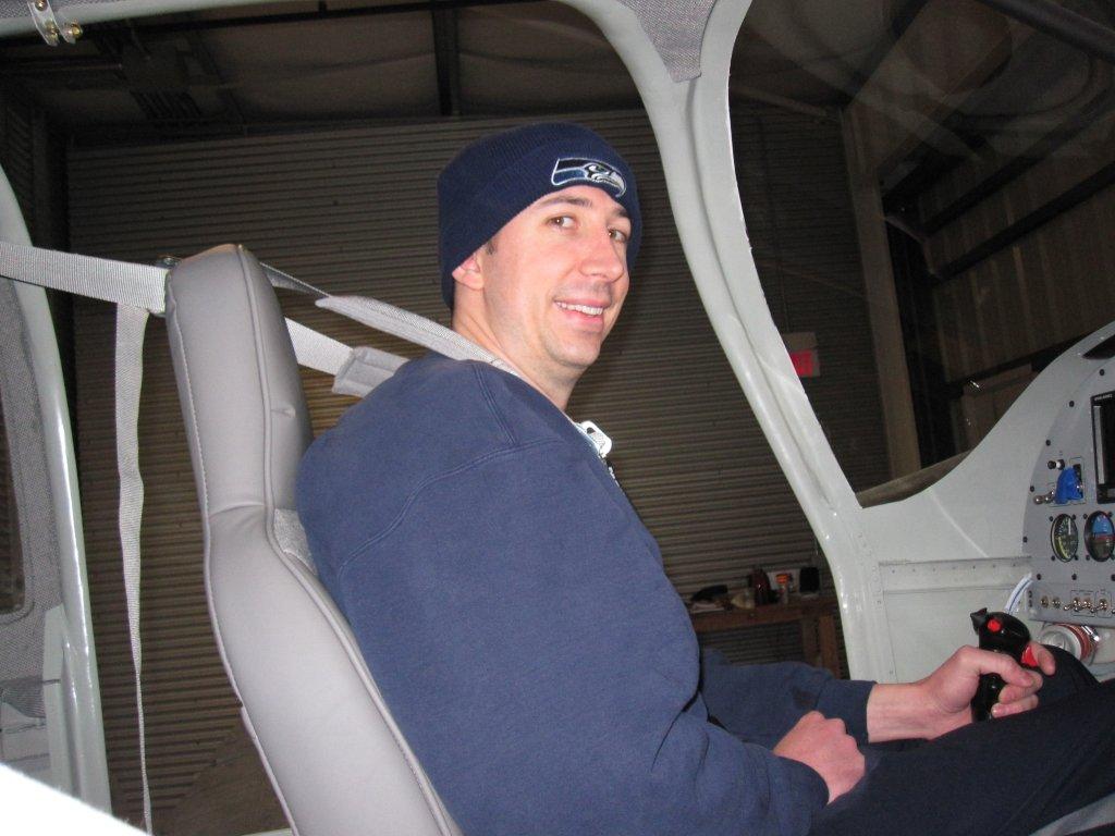

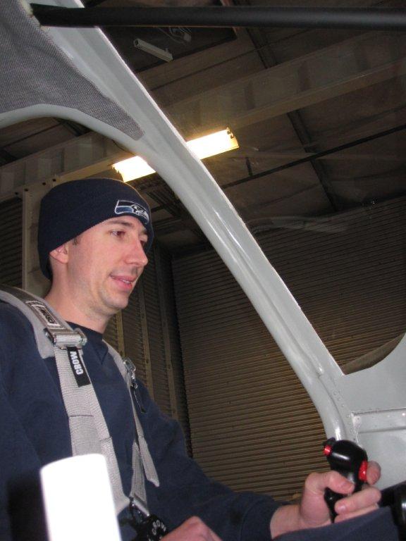

Anyone using the Crow seatbelts in their -10?  When I ordered mine, I didn't specify and dimensions--I just said I needed a complete set for the RV-10, since I understand they've done a few.  Having now installed mine, the shoulder straps seem to be too short between the latch and the "Y".  See the attached pictures.  The "Y" is right on top of the headrest.  I could move that back a few inches, but then the shoulder pads would be in the wrong place.  Something doesn't seem right here--any ideas?

Rob, I agree that the pads could be a little more forward. In the first
picture it looks like you're leaning forward a little to put tension on
the harness. Either that or you have a serious shoulder/back problem!!!
If it was me, I'd move the 'Y' forward a little and then take the slack
out by pulling on the adjustment for the shoulder belts. The shoulder
harness should be adjusted so that in your 'cruise' seat position with
the harness just a little slack from snug (yeah, go ahead and measure
that!) you can reach all the stuff on the panel that you need to .....
without having to twist the upper torso very much. The only problem
moving the 'Y' forward is that it causes the shoulder belts to rub the
side of the neck. This is a problem I have in my Pitts, and the
solution was the shoulder pads for car shoulder belts. Nice and soft on
the neck now. But you'd hate to just cover up the pads you paid so
dearly for.

Thanks, Linn... I sometimes do slouch quite a bit, which is probably what you're seeing.  I did some adusting, per your recommendaton, and I think it'll work.
Now I just need to figure out what seat position I want to fly it in.
-Rob

Thanks, guys... I'm having second thoughts with my "good enough" assessment from the other day.  The belts feel fine, but it seems like the geometry is off, with the shoulder straps essentially coming from the top-center of the headrest.  I think I'm going to call and have them re-make the front seat shoulder straps.  There's also *way* too much extra strap (around 3 feet) when I have them adjusted, so something is clearly not right.  Maybe when I said "RV-10" they assumed all RVs are the same?  Not really sure what's going on, but this is something that needs to be done right.
DAR inspection in 13 days.  Not exactly what I want to be messing with now...
