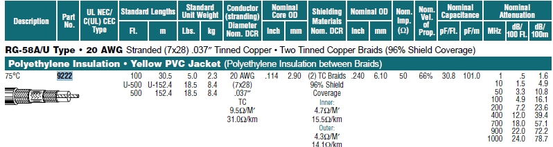

I am confused too. First, RG-58 series coaxial cables are
a legacy product dating back to WWII or perhaps earlier.
It was for a single shield coax with polyethylene inner
insulation and PVC outer insulation. Best we knew how to
do in 1940 and manufactured by the mile since that time.
RG58 as a supported specification (meaning updated periodically
and recommended for new design) fell off the wagon many years
ago. We learned how to do a lot better since then and the
spec was canceled years ago.
Since that time, folks who should know better have been offering
"RG-58 Type" coax cables. At first, they were clones of the
WWII vintage product. But after a time, many of the cables being
offered as replacements for RG-58 began to morph. Here's your
9222 data:
[img]cid:.0[/img]

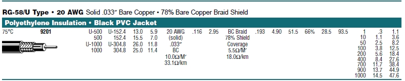

Here's the original RG-58 data
[img]cid:.1[/img]
Hmmm . . . Still has a 20AWG center conductor. The center pin will go on fine.
Still has a core on the order of .116" so it will probably go down into the
connector. This means that both shields will easily slip over the shield grip
barrel. Here's the problem. With an OD of .240 versus .193, the shield grip
ferrule will not fit over the outer jacket of the coax. You might try installing
a standard RG-58 BNC male. Put a piece of 1/4" heatshrink over the coax.
See if you can strip the outer jacket and peel pack outer shield to remove
the intra-shield insulation. Then see if you can work the shielding over
the connector shield-grip with the ferrule in place. If you can, go ahead
and crimp it. Then cover the slightly non-standard crimp with the heatshrink.
I'm mystified as to why anyone would supply this sort of coax . . . except that
obviously, more shielding has to be better than less shielding. The "RG-58"
notation probably misled them into believing that they were form/fit/function
interchangeable. Not so for obvious reasons.
