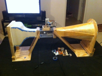

I built a wind tunnel for my son’s physics project.  Works great!  The issue is that I would like to slow the fan down to generate airspeed below the Reynolds number of a dimpled golf ball.  Current airspeed is about 58 mph.  I need to slow the fan to generate airspeed below 30 mph.  The motor is a permanent split capacitor type: http://www.grainger.com/Grainger/DAYTON-Direct-Drive-Blower-Motor-7E658.  Any thoughts on how to slow it down?  I've read that slowing it with a dimmer might damage the motor.

You can't talk about a wind tunnel and not include at least a photo!!
Better yet a parts list and a blueprint Smile

Just following up on my question last week about slowing a permanent split capacitor motor for a wind tunnel I built for my son's science project.  A poster indicated that one can slow such motors with a dimmer switch, which is what I did.  Worked great.   We were able to measure the drag coefficients of golf balls with different dimple patterns at different Reynolds numbers.  Cool project.  I've attached a compressed picture of the wind tunnel as one poster requested.
Thanks for the help guys!
