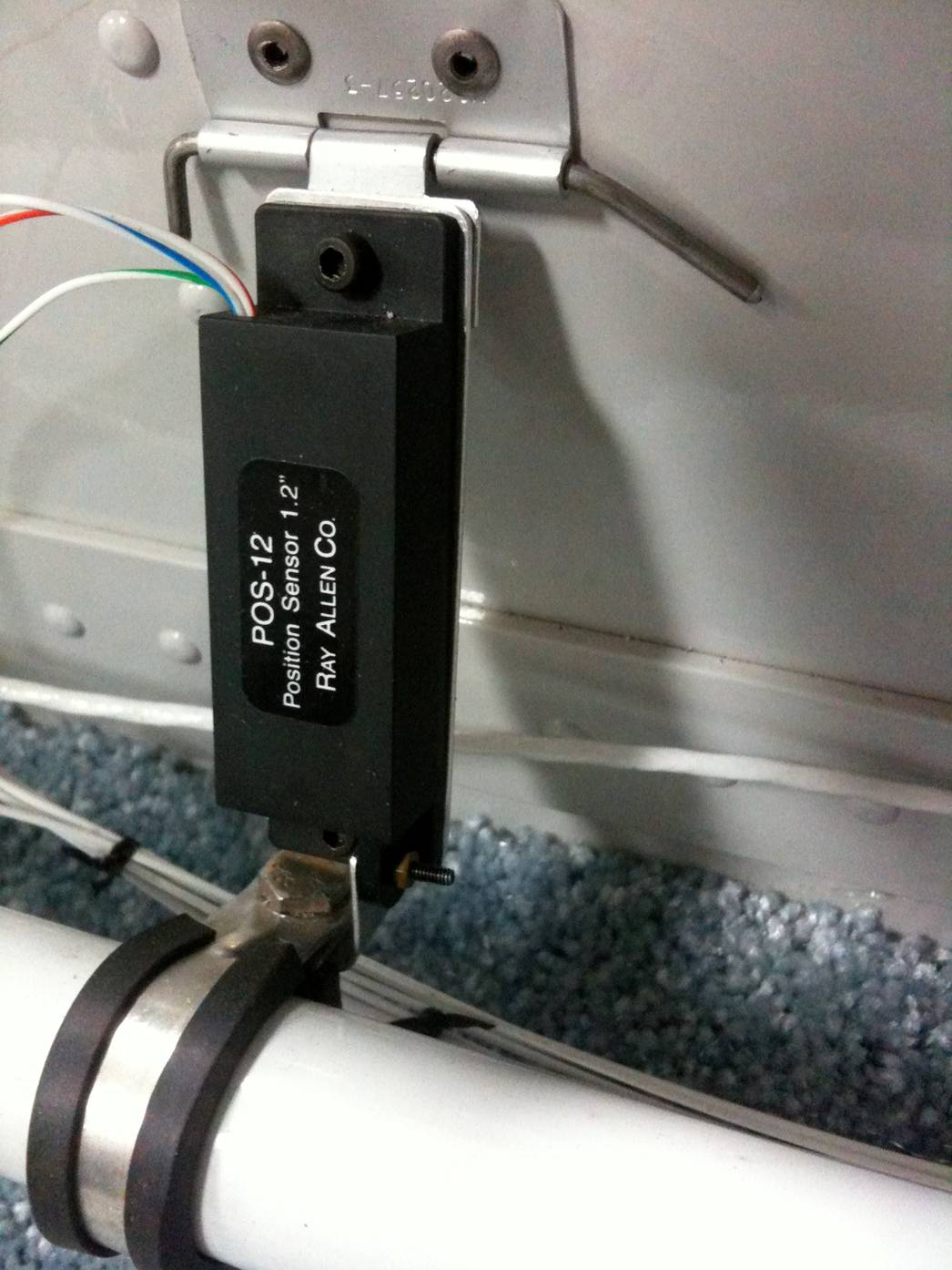

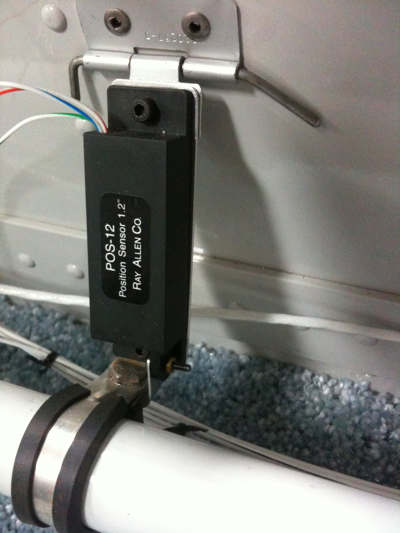

PostPosted: Sat Jan 22, 2011 3:42 am    Post subject: AFS AOA flap switch Reply with quote
John,
I have the Ray Allen POS12 flap sensor. It displays the flap position on the AFS EFIS as well as gives the info to the AOA, It has nothing to do with the flap switch which does not connect into the AFS EFIS.

PostPosted: Sat Jan 22, 2011 4:35 am    Post subject: AFS AOA flap switch Reply with quote
Alan,
I’ve not seen anyone mount the POS12 like you did. I like it!

amekler
Joined: 07 Oct 2010
Posts: 164
PostPosted: Sat Jan 22, 2011 4:48 am    Post subject: AFS AOA flap switch Reply with quote
Bob,
It wasn’t my idea but I don’t remember who on the forum came up with it.
Alan

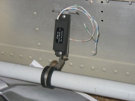

PostPosted: Sat Jan 22, 2011 5:41 am    Post subject: AFS AOA flap switch Reply with quote
Does this look familiar? Smile[img]cid:1C33A638-4382-4C89-90F3-6DB637A0958A(at)myhome.westell.com[/img]

amekler
Joined: 07 Oct 2010
Posts: 164
PostPosted: Sat Jan 22, 2011 7:56 am    Post subject: AFS AOA flap switch Reply with quote
Mike,
Thanks. It works great!
Alan

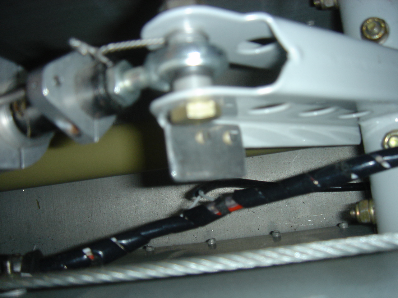

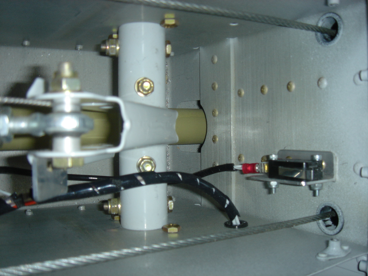

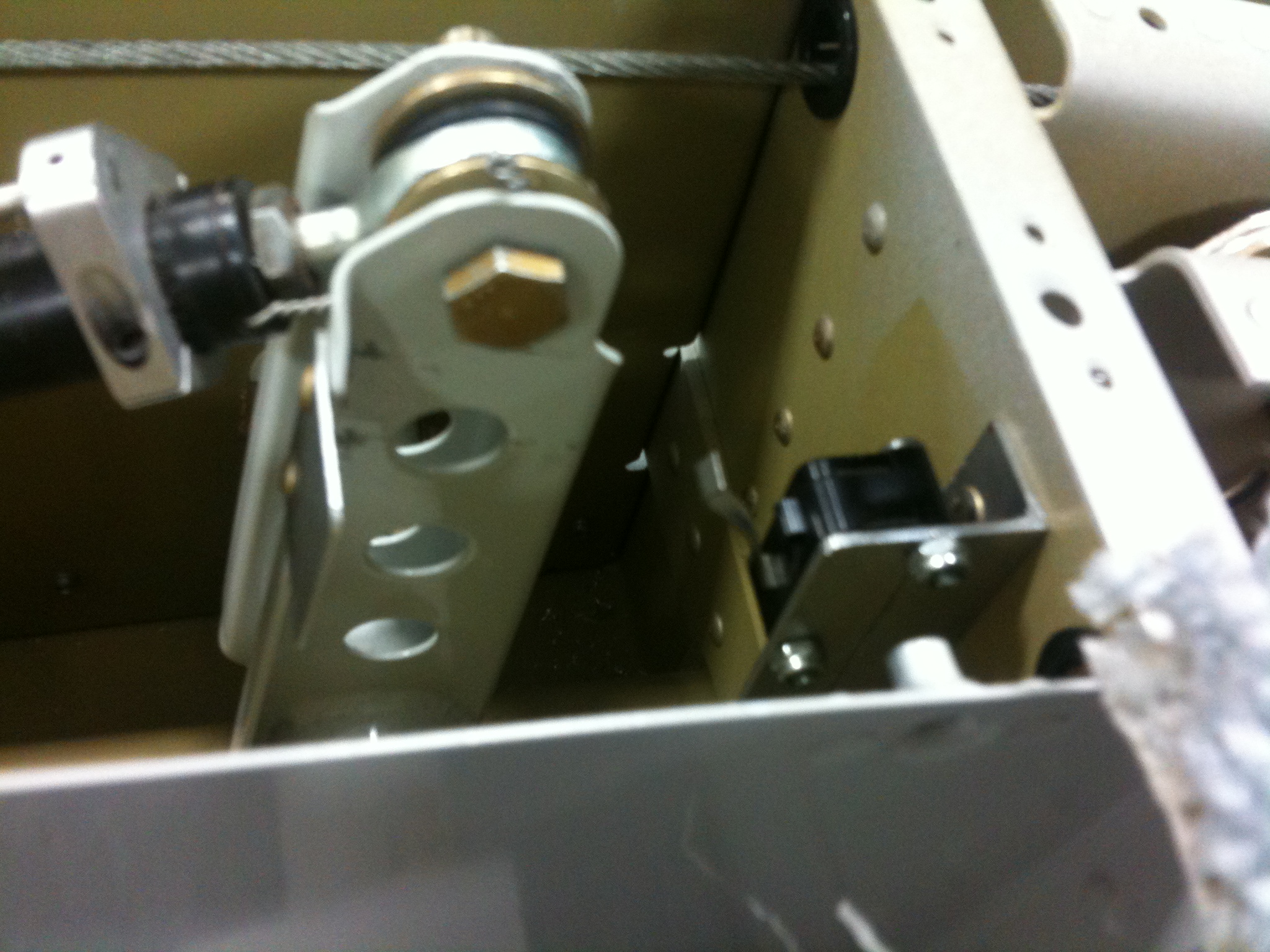

PostPosted: Sat Jan 22, 2011 11:36 am    Post subject: AFS AOA flap switch Reply with quote
This is what I did. I riveted a tab on the flap mechanism and mounted the switch on the bulkhead behind the flap weldments (see photos).

n223rv(at)wolflakeairport
PostPosted: Sat Jan 22, 2011 11:43 am    Post subject: AFS AOA flap switch Reply with quote
This might be a better picture. [img]cid:28591404-0B70-44F1-B09E-39949917C0C3(at)myhome.westell.com[/img]

John, I don't have a photo handy but the AOA switch just tells the
EFIS when the flaps are down. Mine triggers when they're about 1/3
down.

PostPosted: Sat Jan 22, 2011 4:26 pm    Post subject: AFS AOA flap switch Reply with quote
IIRC, mine uses a cam attached to the torque tube. The OD of the cam
lobe doesn't go all the way around the travel.
I'll have the whole thing apart for the annual next month. Let me
know if that's not too late for a photo.
