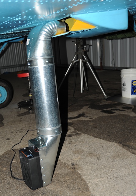

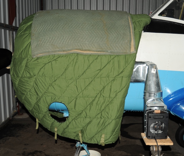

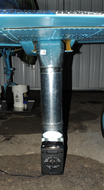

This is my preheating arrangement. Cover from Doug Sapp (extra moving pad on top probably not necessary). As you can see, I don't cinch it underneath, but there are fasteners for that. On the other side, I tuck the cover into the cowl outlet. I use a Harbor Freight disk heater with the pictured HVAC ducting. I use the 1500 watt setting, but it might work on the 1000W setting too, especially if you have some lead time. This warms everything up FWF. I then rigged up something similar for the oil cooler. Not pictured in front of the oil cooler is one of the apertures for cooler temps. I put that heater on the 1000 watt setting. That pretty much just leaves the long hoses that feed the oil cooler unheated. I also use the Phillips 25-60 radial engine oil.

What the hell Mark! You didn't insulate the duct work!
