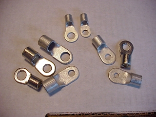

I don't think any one brand is "golden" . . . for
fat wires 8 AWG and larger, plain-vanilla bare-foot
terminals are fine . . . and I don't think anyone makes
a "bad" one.
[img]cid:.0[/img]
Crimp or solder and use double-wall heat shrink
to seal the joint and provide support for the
smaller gages.

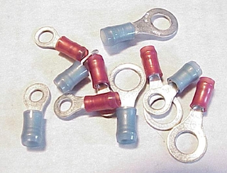

For 22-10AWG wire, the AMP PIDG (pre-insulated
diamond grip) style is recommended and made by
many folks under Mil-T-7928, class II, type 1 and
2. The thing to look for is the 'extra' copper
sleeve over the wire grip barrel and under
the insulator.
[img]cid:.1[/img]
In other words, avoid the 2-piece terminals
(barefoot + insulation only).
