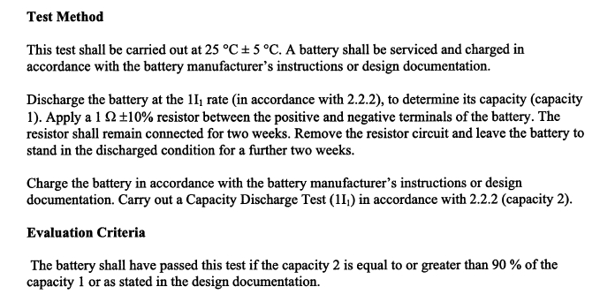

Earlier I wrote:
"There are numerous qualification specs for aircraft/military
batteries that call for total discharge and store
at elevated temperature for some period of time. Then
conduct some sort of recovery process."
From DO-293 we find this recipe for investigation . . .
[img]cid:7.1.0.9.0.20110119133309.01f6d398(at)aeroelectric.com.0[/img]
This test is run on a factory-new battery with the total
test running 28 days.
