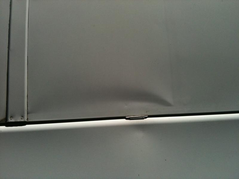

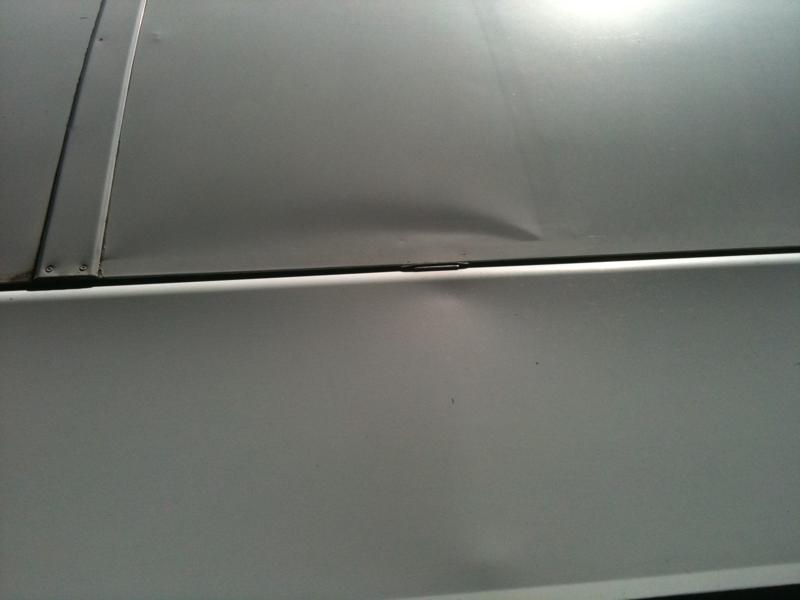

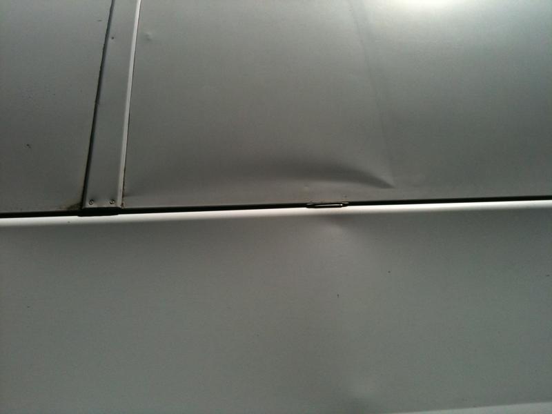

Three pics. I set a straight edge along the rear spar. It isn't bent. Just looks weird.

The spar may not be bent but the skin appears to be buckled in front of the flap rub strip. The flap also looks like it has a depression in it. Makes me wonder if the flap didn't hang up and cause the damage some time in the past.
Cliff
