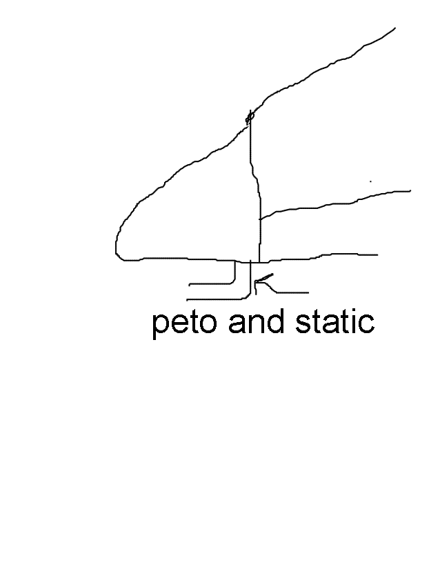

PostPosted: Sat Jan 15, 2011 1:08 pm    Post subject: Pitot static port location Reply with quote
Here's my question; Do any of you have a recommended place on the nosecone for the static pitot fitting? Or is it okay to locate it ANYWHERE on the side of the nosecone? The inlet hole for the static air is a drilled hole about .025 dia. (It is TINY!!!!!, just slightly larger around than a pin)
sorry about the drawing... this is what i did.
boyd young
mkiii
[img]cid:F828A39684FD4CCBB62CD87CC2EC205E(at)laptop1[/img]
 Filesize:  516.6 KB
 Viewed:  17194 Time(s)

PostPosted: Sat Jan 15, 2011 1:44 pm    Post subject: Pitot static port location Reply with quote
Hi Boyd,
  Thanks for the drawing, your drawing is plenty good enough
for us to get the idea of what you have.
  But, I would prefer to use those flush-mount type of static ports like
I previously showed the link of;  the ones that look like this;
http://www.aircraftspruce.com/catalog/inpages/alumstaticports.php
  From what I've been researching, I think John has me headed in
the right direction, namely a port on each side of the fuselage.
I'm afraid that if I had a port on the underside of the Xtra nosecone
it would definitely be getting slightly pressurized air with the flush
mounted type ports.
  I still not sure about the interior vent hole through one of the "T's", though.
>From what I've been reading, it may not be all that necessary,
especially if a guy went with two side ports!

On Sat, Jan 15, 2011 at 1:05 PM, b young <by0ung(at)brigham.net (by0ung(at)brigham.net)> wrote:
boyd young
mkiii
[img]https://mail.google.com/mail/html/compose/static_files/blank_quirks.html?ui=2&ik=1f31465df0&view=att&th=12d8b8bd3bc78d96&attid=0.1&disp=emb&zw[/img]

Boyd's drawing looks like what I am using. One is the pitot, the other is static port, both are out away from the airframe in clean air, seems to make life simpler. Worked right the first time, needed no tuning. Your results may vary...
Details here:
http://www.bcchapel.org/pages/0003/pg7.htm
Richard Pike
MKIII N420P (420ldPoops)
Bro. Richard,
  Although I do agree Boyd's and your suggestion of the static inlet
works well out on an extended tube, I would prefer to go with the
type of fitting that mounts on the surface of the fuselage.  But, thanks
for your input!!
  At this point, I concede I know when I'm given good advice.  John H
was generous enough to offer what says worked well for him.  Although
I did agree, I was curious if a slight (unnecessary) modification would be
better.  He, Rick G, and Ted K didn't think so!!  (probably others, too)
That's good enough for me!!
  I appreciate everyone's input, and value the advice I have been given.
I think I'll go with the two, side fuselage, surface mount ports, no inside
cabin venting, and 1/16" vent holes.
  Thanks, guys.
Mike Welch
