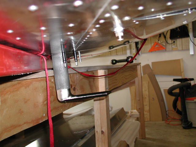

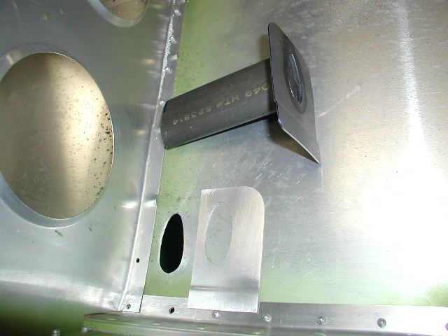

I installed my Dynon pitot immediately aft of the wing spar just to the outside of rear rib number 5 on the left wing. As Ron mentioned, I believe this is the location recommended by Zenith. A couple pics of the install location are below. Regards //Dave

Thanks guys, that's just what I needed to know. You both did a nice job of fabricating a mount for the pitot.
Dave, would you happen to remember the principal dimensions (or AC Spruce part number) of the streamlined tubing you used? Looks like 4130 to me.

Tim, glad to be of help .. but I did not fabricate my pitot mast like Ron did (nice job Ron!) I purchased one from SafeAir1 at http://www.safeair1.com/Pmast_1.htm
